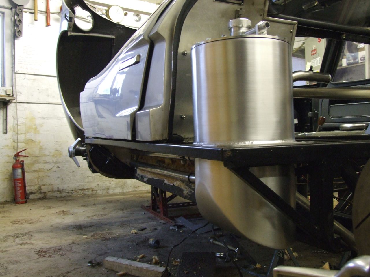

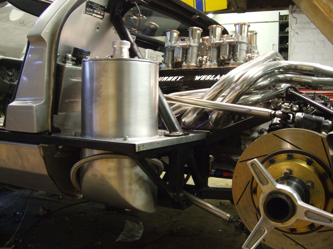

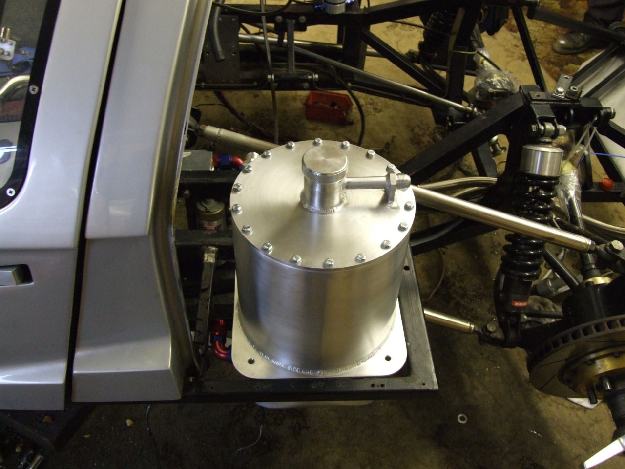

My take on GTD dry sump oil tank, 548hp Gurney Weslake. The tank is filled with oil to the sill level, above that is a complex de-aeration screening. Before I get jumped on by Rons Rules, these pictures are for the benefit of the questions above, not any offer to sell such items. Frank
Wouldn't a well-designed tank have a fill tube on a tangent? Just dumping in the oil from the top (as it appears to be the case here? Or am I just missing that?) doesn't start the de-aeration process very well.
The Peterson tanks, and all of the racing tanks I've seen all put the oil from the pump into the tank that way.
Even the swirl pot Wayne and I designed fills fuel from a tube on a tangent, and when tested with airy water was quite effective.
Will, you cannot see the many connections at the back of the tank, the pipe at the top is a breather for air outlet, you are correct in that the inlet pipe from the engine is indeed angled to the wall line, as it should be ! Frank

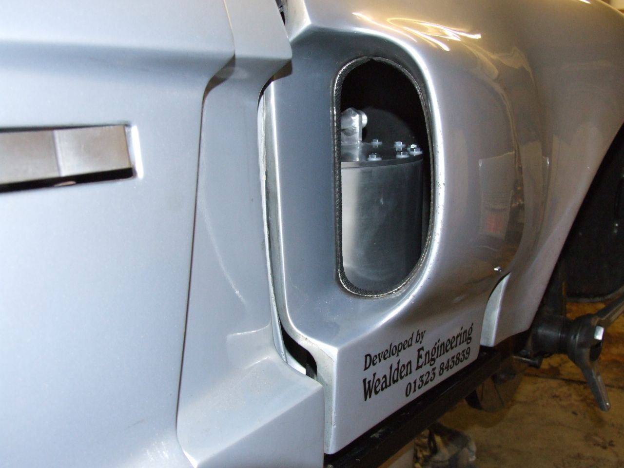

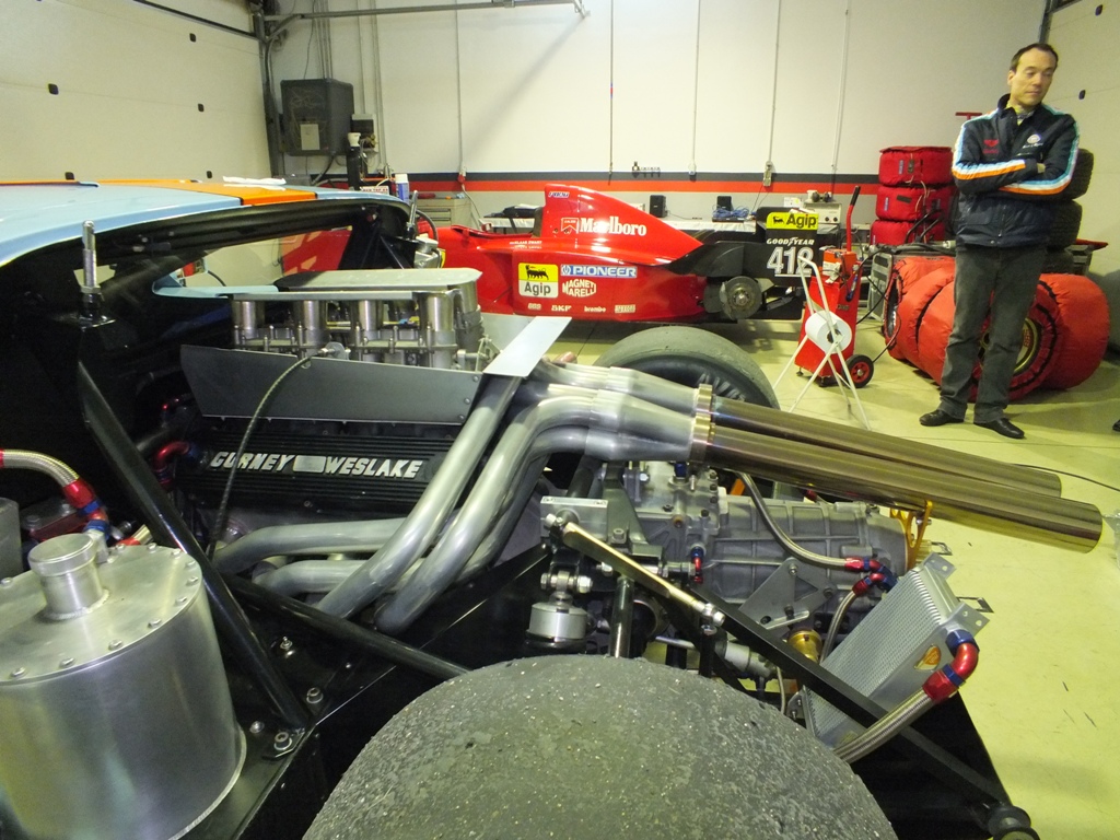

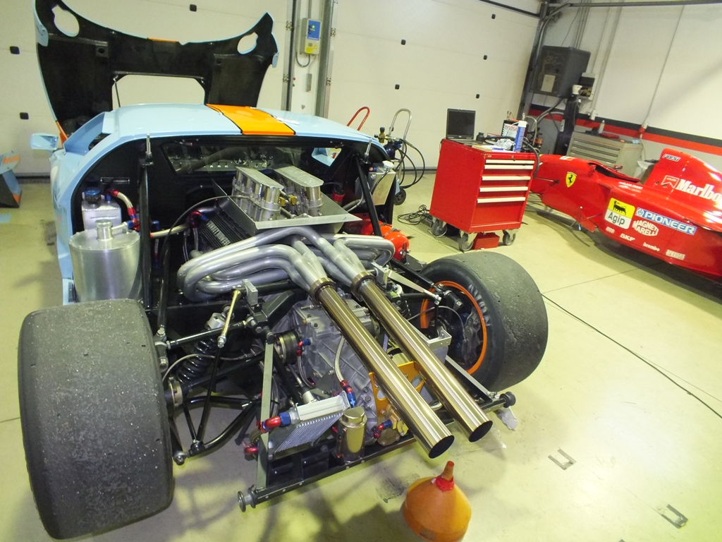

not the best pics of the final install, but interesting!
