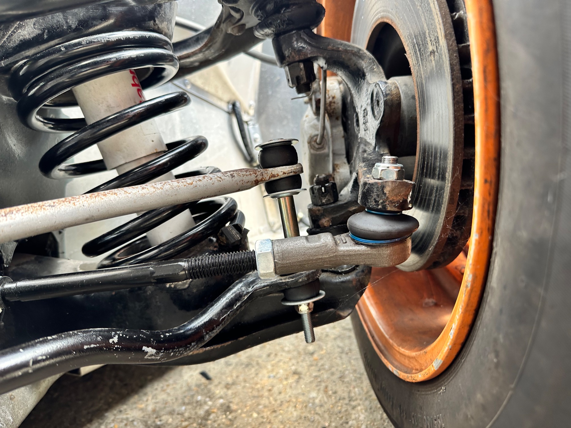

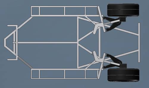

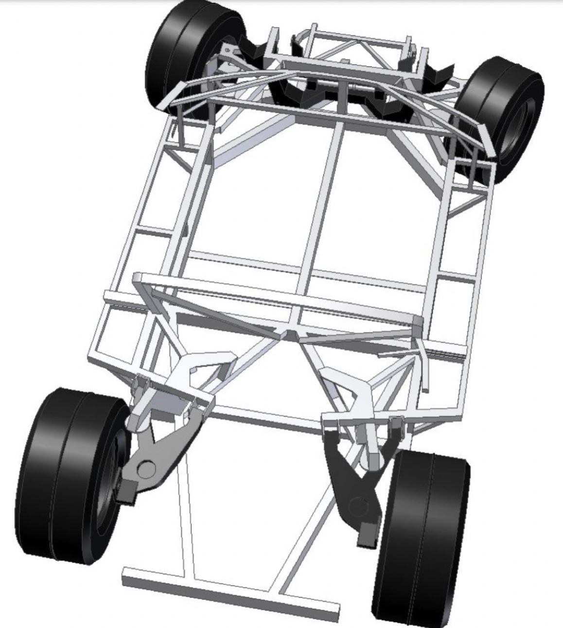

The early chassis have a complete Ford Cortina Mk3 front axle and trailing arms (Granada) at the rear. The top of the rear coilovers mount to a cantilever.
The later C type chassis has fabricated wishbones at the front and Ford Granada Mk2 uprights. The front of the chassis tapers in at the front so the front wishbones tubes are unequal lengths. The rear suspension is like the original cars with a reversed lower wishbone, a top link and two trailing arms. The uprights have a large diameter tube in the middle carrying Ford Granada Mk3 hubs.
