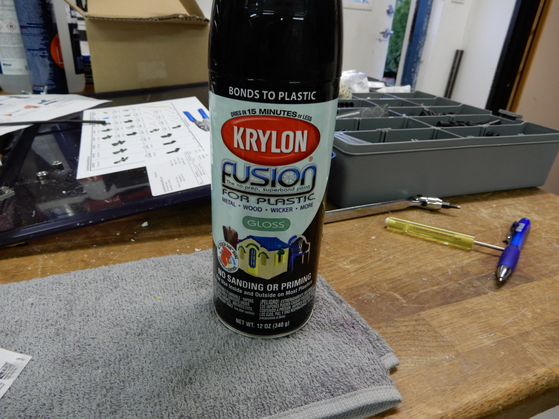

Thanks for info Dave, I`m just about to start painting the lexan. There is a lot of info on the forum with regard to this and a summary would point to the Krylon Fusion being the best. I`m planning to use this, it says on the can "no sanding or priming" but I`m planning to scuff the edges.
