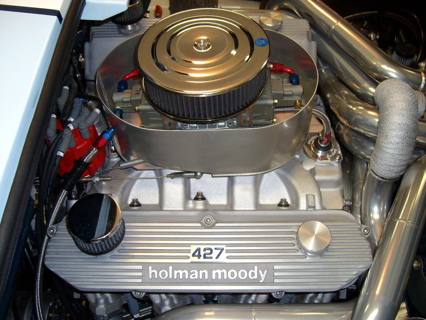

I've had two MkIIs. Both with FEs. One Iron (old NASCAR block) and the current engine is a Shelby aluminum. The Shelby is squared at 482 ci. The Shelby engine was developed using a 750 and 950 cfm Holley. Both were run on a dyno. Both were close as the 950 was correctly jetted for engine. The new 750 is in the box it came in. Results was 600/610 less gas and more air and it is a thing of 'great beauty.' Very smooth roll on from lower RPM that pulls well into triple digits on the speedo in 4th gear. The iron block was good but the cam wanted to be operated in the mid and higher RPMs. The limiting factor is cost. They Shelby engines are costly.

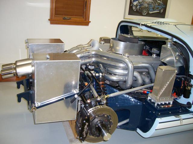

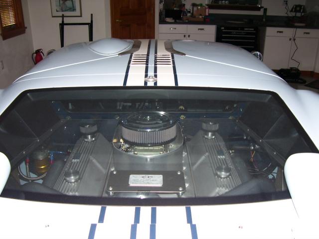

The picture shows how well the rear compartment is filled out.

I have a MK2 as well and since these were known as the big block cars, I went with a dual quad FE. It clearly fills out the engine, especially with extras like luggage boxes and a dry sump tank. Mine is a Shelby block and I have the typical rear main drip. That should be the biggest inconvenience in my life as a result of my build process.
