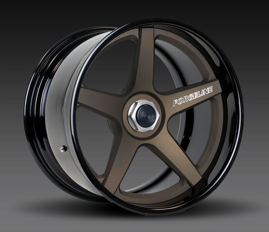

i saw this and though it would be pretty dope for an SLC. i know the SLC uses 5th GEN Camaro SS brakes and would look damn nice. so my question is, what are the pros and cons to having a system like this on the slc, obvious they would be hard to steal, and a pain to change tires in the event that you would need to. but, besides that im pretty sure im missing some other key points.

There is already a center-lock option for the SLC. Uses the standard model wheels from Forgestar, but custom made for centerlock, and includes the necessary adapters.
Call the factory for pricing, availability, etc.
thanks, i didnt know that they offerd this option already. do you think that the ones from the SLC can fit any wheel, or just the forgestar wheels only ?
I have worked with Vince from Forgestar and we actually do the final machining in house for the centerlock conversion...
So any of our wheels an be done...it adds quite a bit to the overall price as its machining, adapters centerlock nuts...but it does look great....but of a bugger carrying around a six foot torque wrench incase you get a flat though..wink
I don't know why people want centerlocks. I would gladly swap my 917 to 5-lug if I could. More hassle, more cost - now I've got an $800tq wrench and special socket sitting on my table just for tires, lol.
pretty much any brand of wheels that offers a center lock option would fit, such as these forgeline wheels, right ? i know offset and brake caliper clearance need to be calculated, and longer studs may be needed, ect.. but these wheels could be fitted to SLC right ?
There are a ton of other things to be taken into account with centerlock wheels,
Pilot bore size, depth, centering angle on the hub, drive pin size, drive pin PCD to name a few ...so in short nothing will drop right on ,without having a custom set of wheels made
