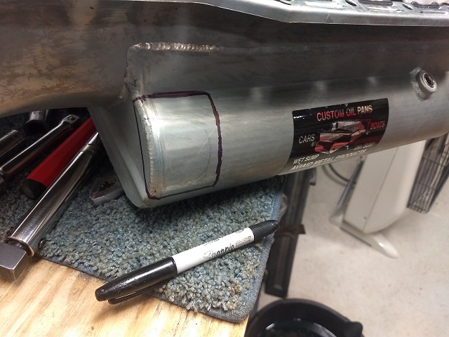

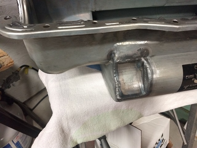

I went with the Safir pkg on my 363/ZF and am very happy with it so far. It has everything needed to attach your ZF to the engine including a starter. It all fit nicely and assembly was a breeze. However, depending on your oil pan, you may have to make a minor modification to it to allow for clearance to the starter as shown in the attached pics.
