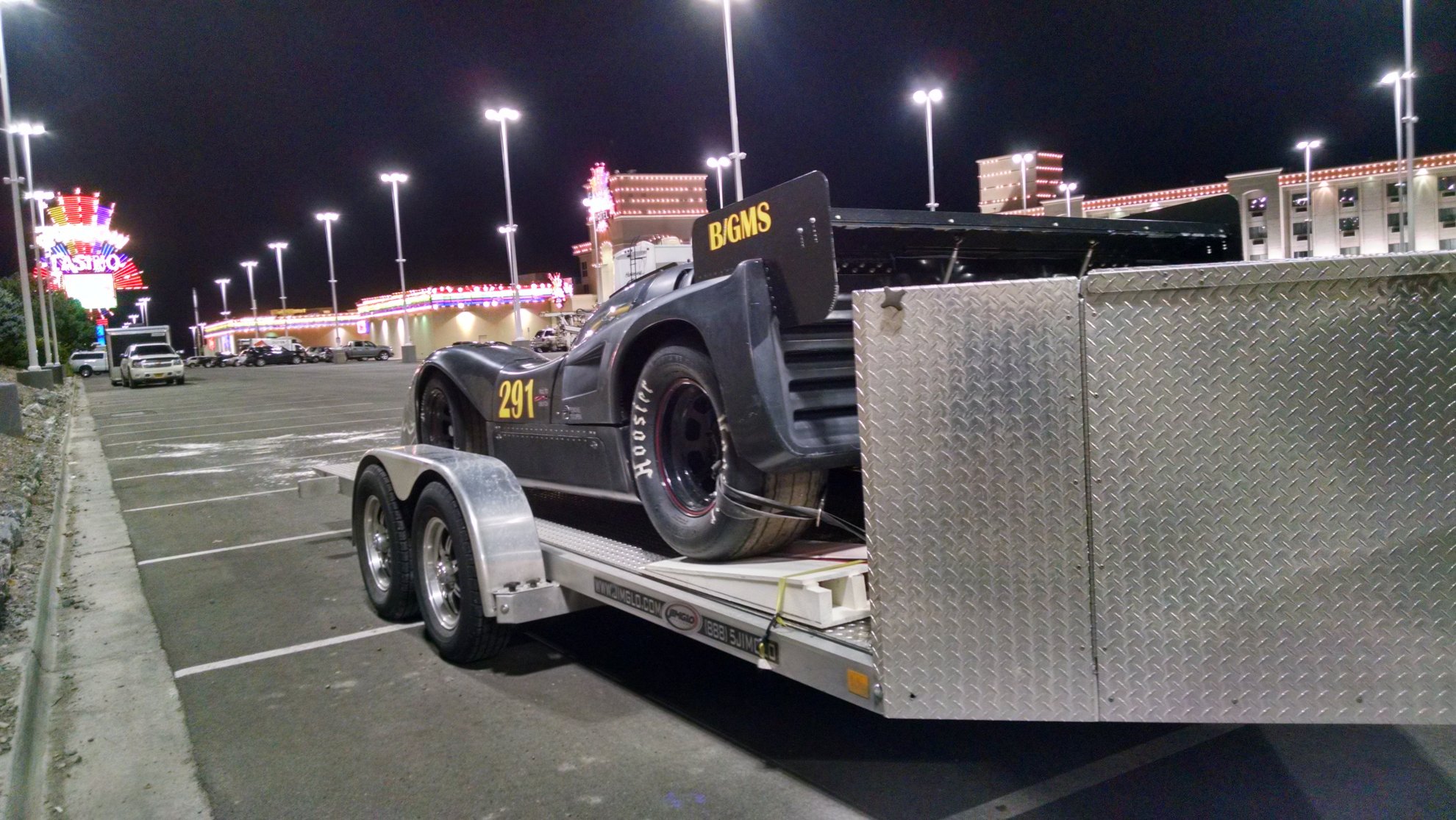

My first trailer was an open, very light weight "California Special " type trailer. It was 18 foot and had a simple two ramp with no center belly pan and beaver trail style. The one huge advantage. It was just about the lightest steel trailer made that would accommodate a GT40. I towed it with a short bed front seat only F150 with a V6 automatic. That was all the truck I needed. The towed Gt40 and trailer was so low that I nearly could not see it in the rearview mirror and as such had almost no aero load. Gas mileage was about 3 miles per gallon worst than the unloaded truck that could get above 20MPH on flat ground @65MPH.
It worked well for short pulls to and from the track (less than 8 hours, and one day trips) but no storage really, and everything I brought with me had to go into the bed of the truck. Also no shade at the track and no sense of "home" in the paddock as any real work to be done I did off the tailgate of my truck.

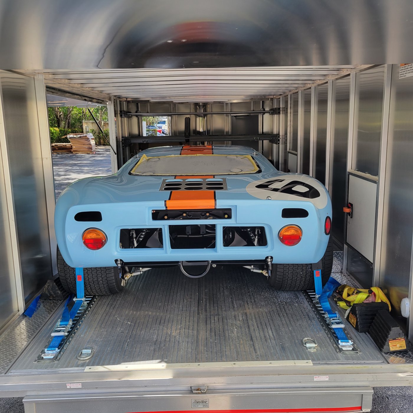

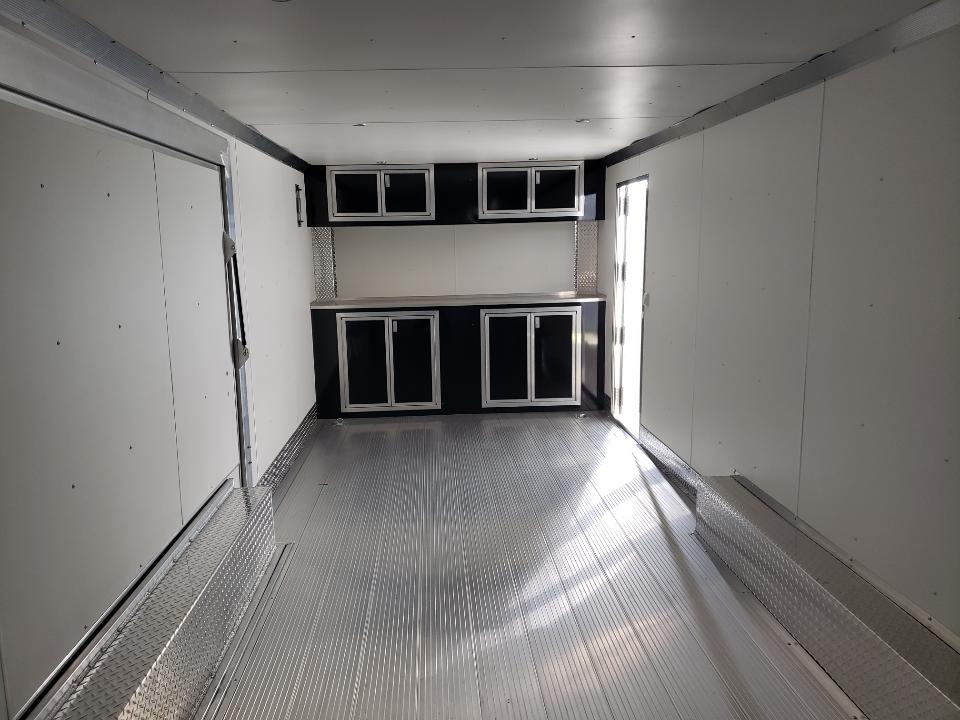

So I bought my enclosed trailer. Heavier but at 20 feet not too bad really and my next truck, extra cab F150 with a V8 and tow package pulls it fine. Good room inside for a "paddock shop/lounge" at the track and I can store a set of tools, jack, and jack stands along with two set of additional tires on racks on the walls.

SLC? You will have to work out homemade or custom ramps and you will need a winch. I tie it down with straps through the wheels and ratchet straps.
