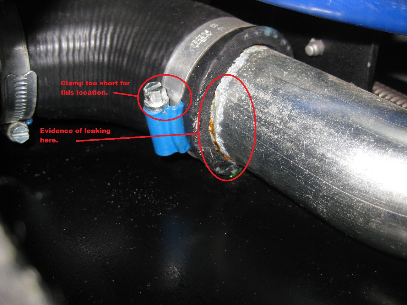

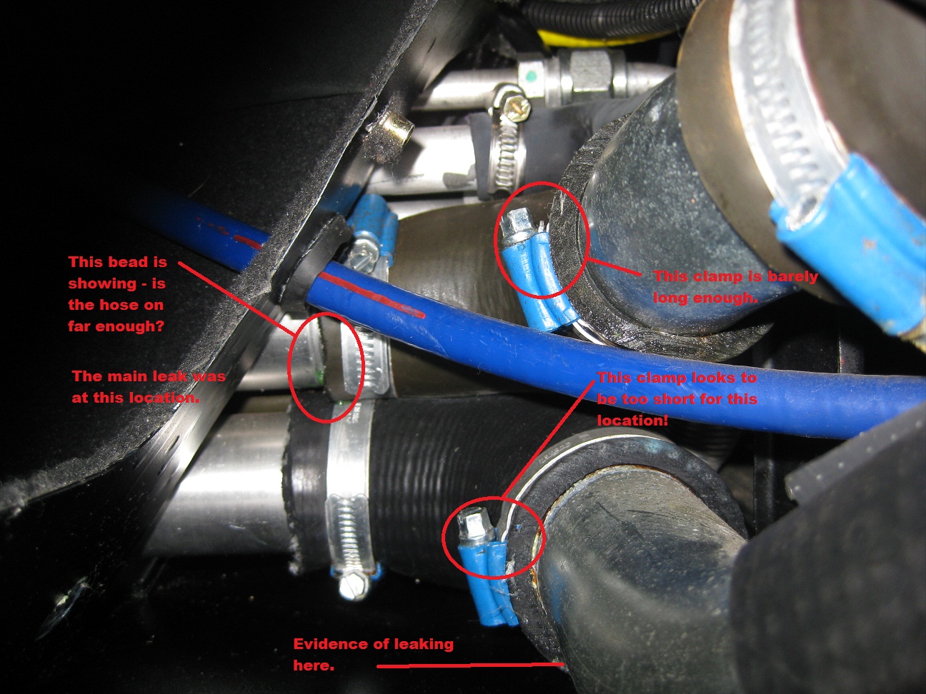

Here is what I found...a few leaks due to loose clamps, one clamp too short for a location, and possibly one hose to short...shoudn't the metal tube bead be on the other side of the clamp?

If you can get in there to change out the clamps, you might try AWAB SS clamps, or T-bolt clamps, not tightening them down TOO much. These are marine parts, you might have to look a bit, but generally they are much better quality than SS clamps for the auto trade.

Mike,
I think like you that the bead should be well into the rubber hose and the clamp on the hose so that the bead is on the hose side of the clamp.
I believe the L&R pipes are same length.
See if the right pipe is further forward than the left where it protrudes through the front firewall and if so is there enough angle on the rubber hose that will allow it to move to the rear?
If so you might be able with 2 people (one at the front pushing and one at the rear with the clamp there loosened) push the pipe into the hose enough to properly connect it.
As far as the other clamps go: as long as you have a bitter end visable and the threads of the screw engaging the slots in the clamp you should be OK but, I agree with Jim that marinee grade clampps are better.
Suspect other than the right hose not over the pipe bead you will be OK just tightning up the others.

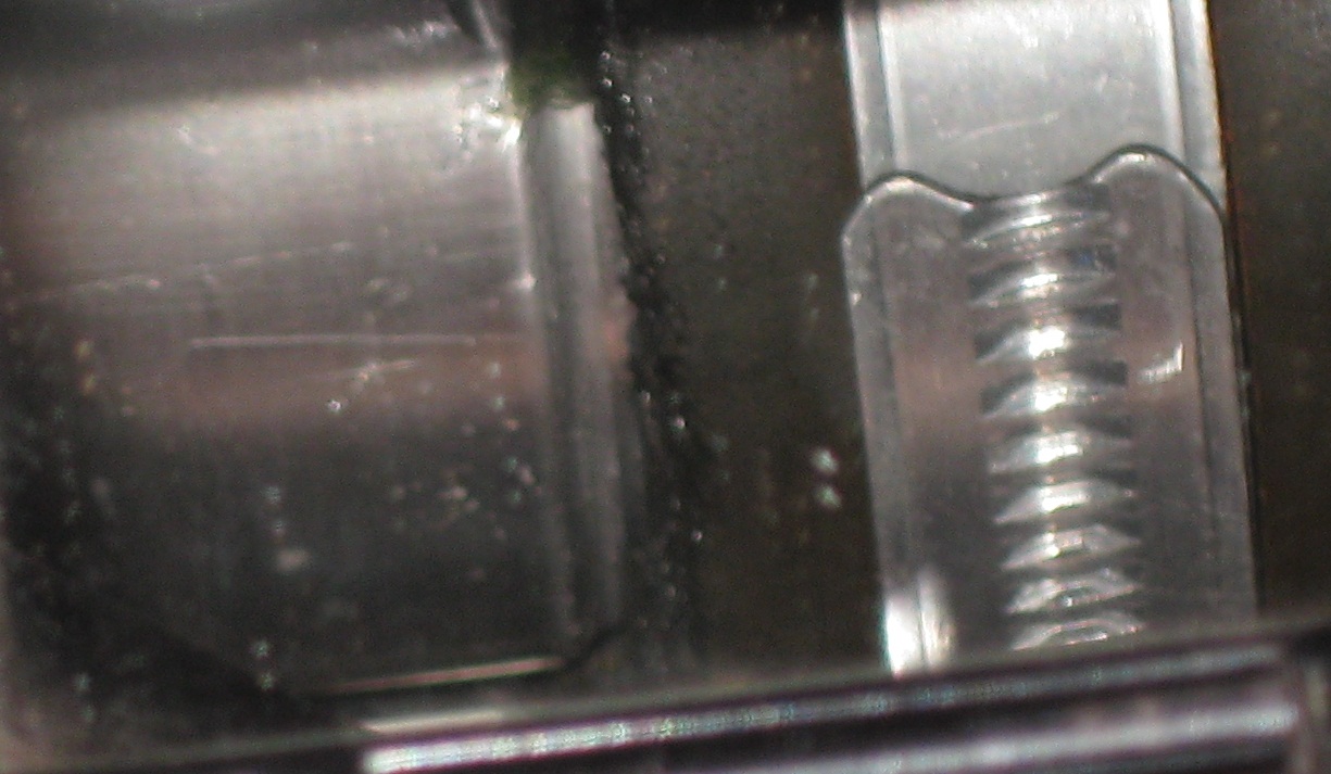

Here is a close up I took through a mirror. Note the profile of the lower edge of the tube showing the trough that Alan is talking about.

So if he moves the pipe as I suggested above (assuming he can) and clamps as you suggest he should be OK
Yes, I think so. I'm not sure having the rear (inner edge) of the trough exposed is a problem, but I don't remember how wide the trough is. I think the key issues are:
  1. Make sure the clamp is "straight" (perpendicular to pipe centerline).
  2. Positioned correctly. I think the best position is centered in the trough. You might be able to tell where that is by feeling "through" the hose, or squeezing with a channel-lock plier to try to determine where the edges of the trough are. Or, if you have the patience, measure the position of the trough releative to a mark further down the pipe, put the hose on, and then measure to locate the center of the trough. A dangerous clamp position would be one where the edge of the clamp is near enough to, or overlapping with, the edge of the trough to form a cone-shaped clamping surface on the hose such that the clamp would tend to slip toward the center of the trough and in so doing wouldl loosen (this is one of the fundamentally terrible things about this whole idea; the only truly stable position for the clamp is exactly centered in the trough). Now that I think about it, having the hose fully cover the entire trough is the only way to have a truly stable clamp location.
Regarding shifting the pipe to get more purchase at one end or the other; you probably want the situation at the rear to determine the position of the pipes, since it is so hard to work with the clamps etc. back there.
