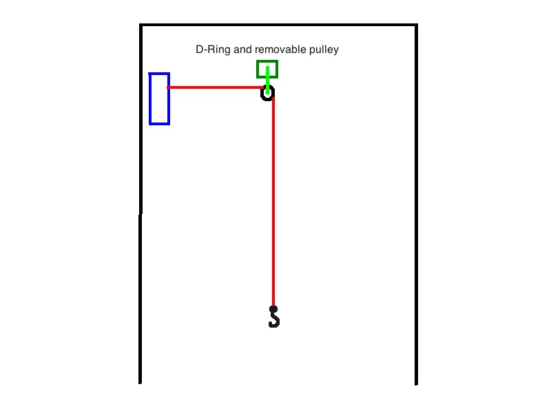

While I don't have any pictures to share right now and my trailer is not accessible to take one - I mounted my winch off to the side of the trailer under a work bench permanently and then installed another D-Ring in the center of the trailer where I hook on a removable pulley that now get's the cable off to the center of the trailer. (I tried to draw a picture of it here - don't know if it will turn out well).
The only issue I have with this setup is that the cable does not evenly distribute on the spool as it is winding in, but I suspect that is due to the relatively short distance between the pulley and the spool.
Still - this gets the winch out of my way and has worked very well for me. The battery box is right next to the winch so things are relatively tidy. I also bought the remote cable operated control which was a bit more costly but well worth it.

That's how I have mine current setup too and the true remote conrol is a godsend as I can steer the car and operate the winch. Only caveat is as you encountered the winch doesn't really dsitribute the cable as evenly as in a straight up mode.
One point of note, if you have a beaver tail trailer and expect to winch from a low mounted tow eye the cable can brush the flooor. On my previous trailer I mounted the winch on the front wall/frame to get it off the ground slightly. I considered a cable runner wheel down the trailer, but that would have been intrusive IMO, a steel plate could be used.

Correct on the cable dragging on the floor. I use a piece of 3/8" Plywood that does double duty under my jack or jackstands when not being pressed into use here. The plywood doesn't slip around much but sometimes I have had to reposition it.

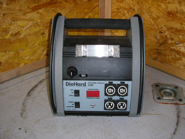

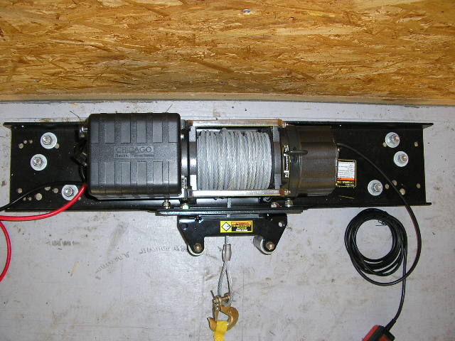

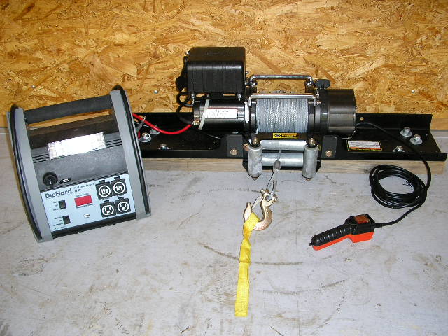

This is what I put in my trailer. 5500lb Harbor freight with wired remote control. I mounted it on a 2x6 which gives it more than enough heighth to pull the car in with no problem. I winch in backwards and stop the winch to adjust the car by turning one of the front tires by hand (it's easy). I use a portable power station instead of a battery for convenience ( as a plus it's got a small air compressor as well ) Some pics are below.
That's my next question for people who've done this (winch in trailer): how do you power it? Dedicated battery in trailer? If so, how does it get charged? Or, powered from tow vehicle? Or ??? Just looking for ideas....
