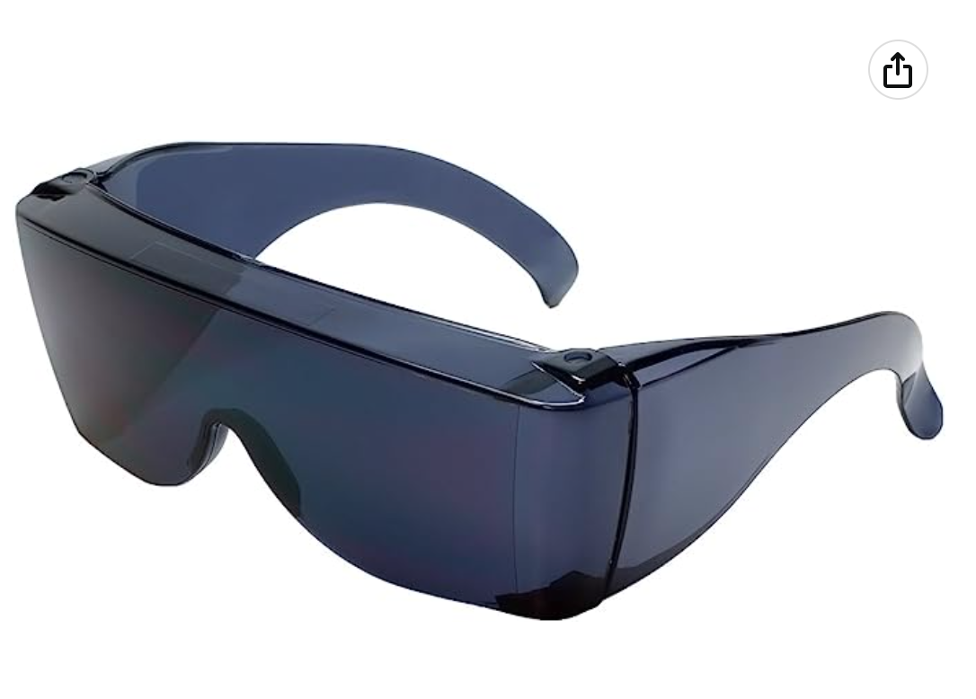

Very interesting Ian. I don’t usually wear sunglasses because my vision sucks due to a stroke a few years ago. Do they offer good clip ons also??
Regards Brian
Rob Klein
Regards Brian

Brian Kissel
Thanks Rob. I’ll look into something like that. My wife’s 98 year old Gray Aunt had something like that. I had forgotten all about those.
Regards Brian
