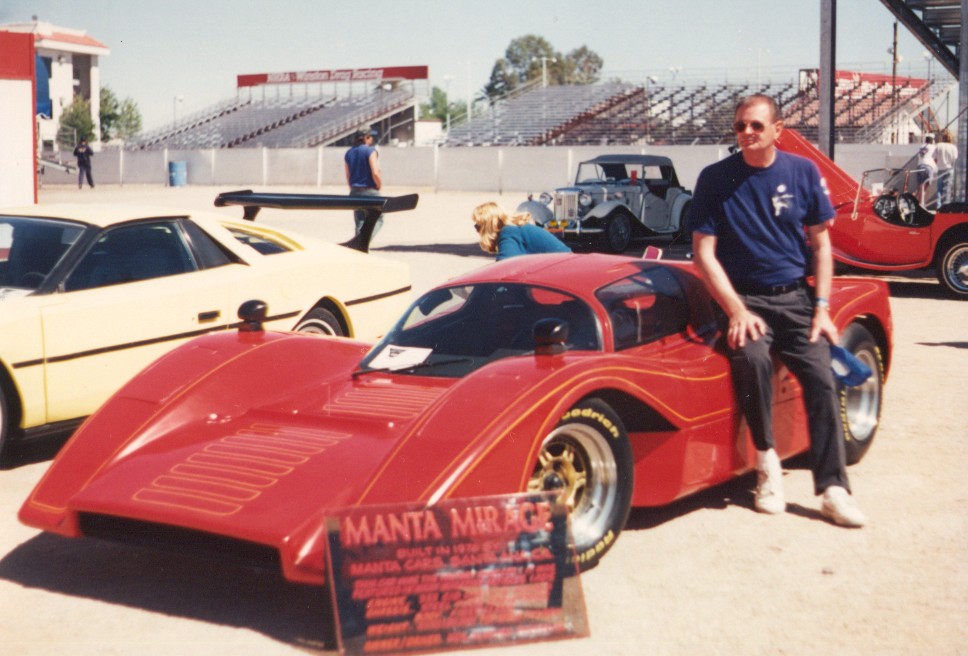

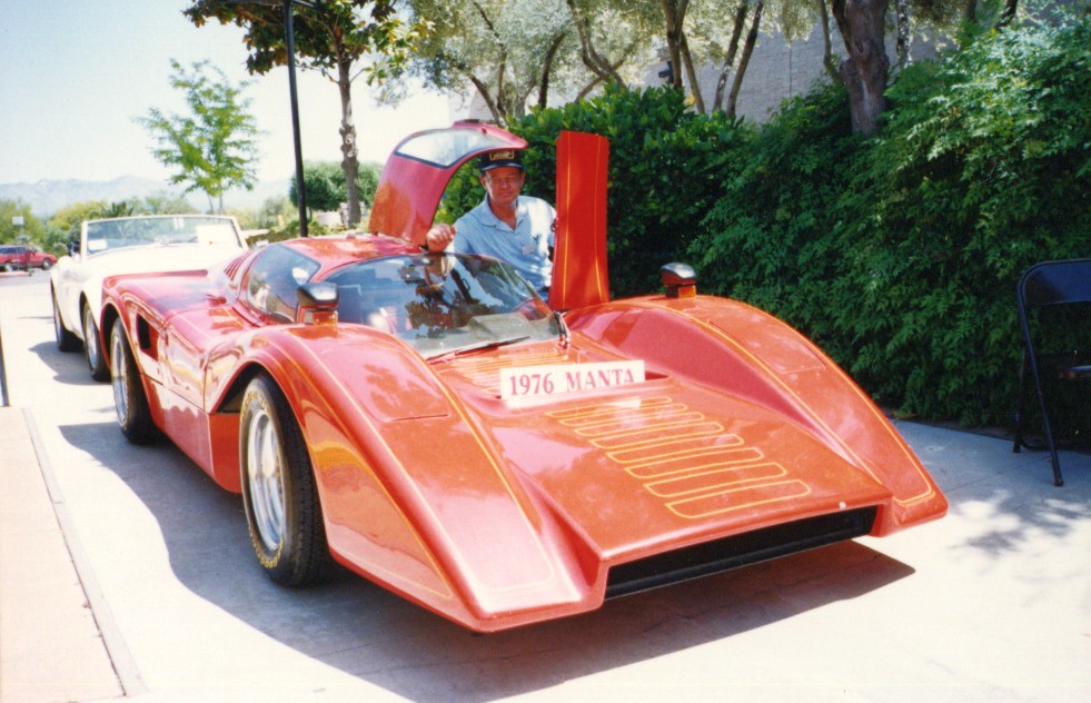

I do have another Manta Mirage, the showroom car at Manta Cars in Santa Ana, CA, that is street-legal. I haven't had it out in a long time; I need to rebuild the engine and get it re-licensed and back on the street. Here it is:
