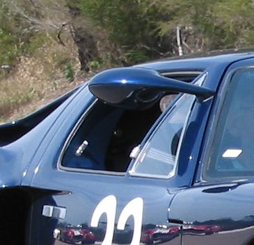

Peter Ransom from GT40 Australia also makes modern styled high mount mirrors. They work very well on wide bodied cars, giving excellent vision. Available in manual or electric. Will be fitting them to my GT40.
Photo of them here.
Tim Kay
I tried the high mounted mirrors from DRB, as you see to the left, I'm not using them /ubbthreads/images/graemlins/frown.gif
