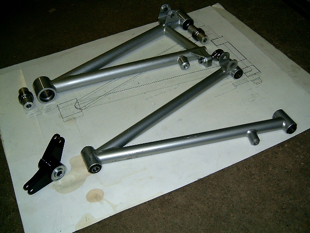

New arm and stock arm. As some of know, the car works quite well on the stock arms, however the seat of the pants input immediately tells you the rear end is more planted and controlled. Ride quality actually improves. Although the new arms are slightly heavier, getting rid of the braces results in a total net weight savings, especialy on the hub assembly which is complete dead weight.
