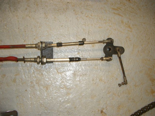

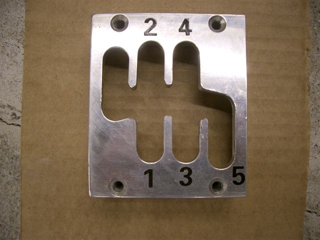

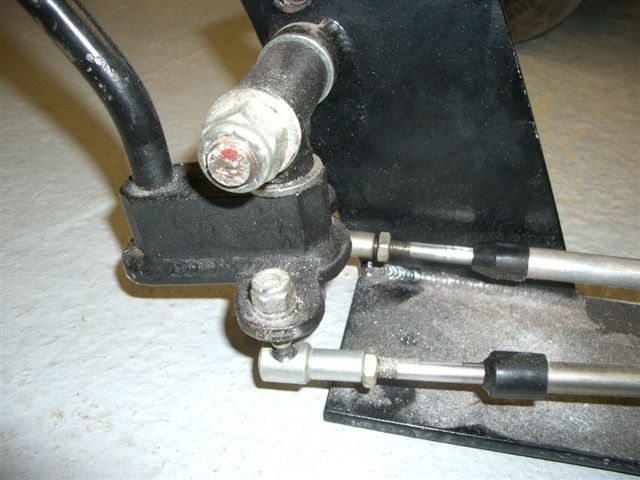

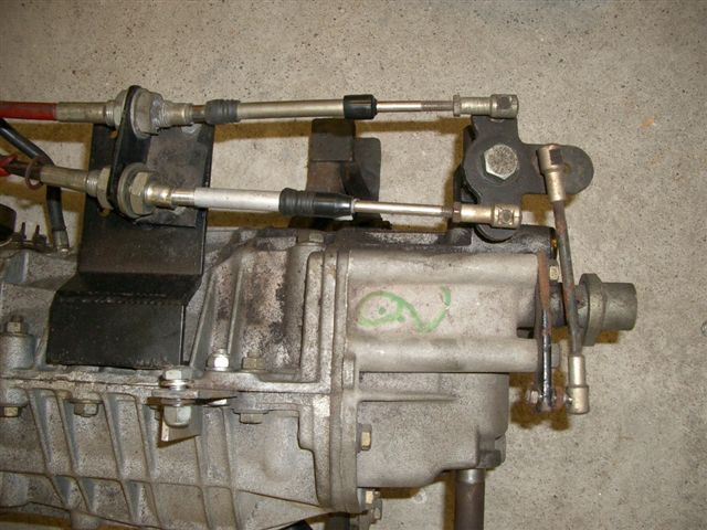

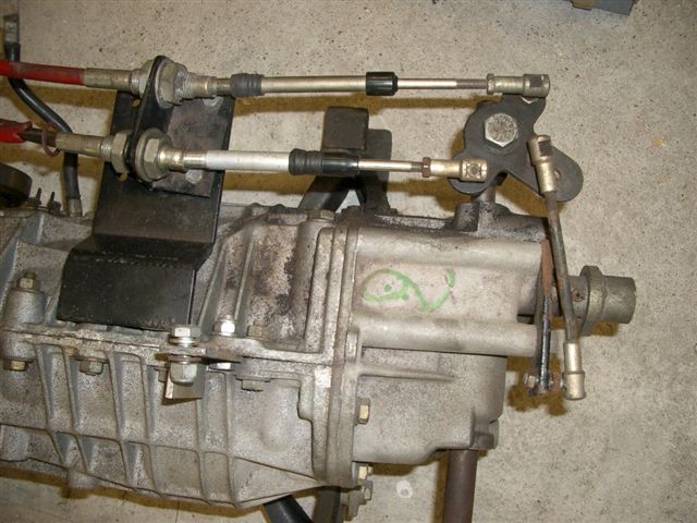

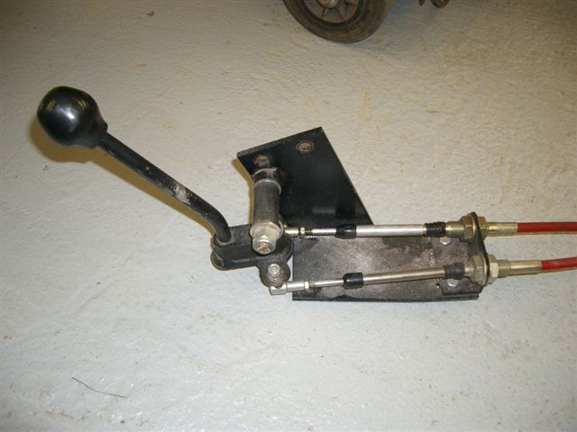

Here are some pictures of a standard GTD cable change. You sometimes see these advertised for sale in the club mags, or you may be able to fabricate something similar.
I'm sure you can 'suss' how it works from the pictures, Hope these help!!
