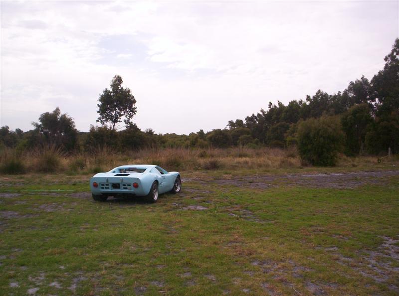

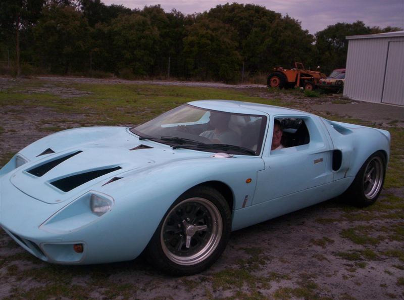

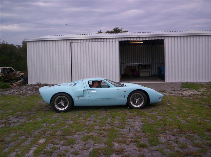

Today was a good day as I finally got to drive the GT40 around the back yard. Got her into all gears except 5th and all seems to be working well.
Did about 8 laps around the back. :pepper: :pepper: :pepper: . Need to check
everything over and when I get my seats back I'll head out onto the highway.

Congratulations
The first time mine moved under it's own steam was a brilliant moment - I just could not get reverse and had to push it backwards!

Thanks Guys
Ian- I had the same problem, got engine started pushed in clutch and got
all forward gears then went to back out of shed and nothing but grinding
when I selected reverse. I didn't have enough travel in stick to get reverse properly. A few adjustments and all is well.

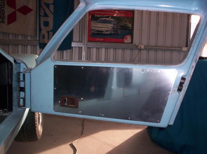

Here's a pic of my door trim I'm not sure which type of inner door (grab)handle to fit?? Any ideas anyone??

Dave
Great work. Just looking at your door trim panel. Do you intend to put a pocket in the door as it makes great storage space. I am not sure if you are building a pure race car and it may not be required. Just a thought. I can send a picture of my door interior if you like.
Regards Martin.
Re: Chassis #64 due in July
Thanks Martin
Post a pic on this build thread if you like. I'm not using the doors for storage so it will remain flat alloy. I want the race car look inside.

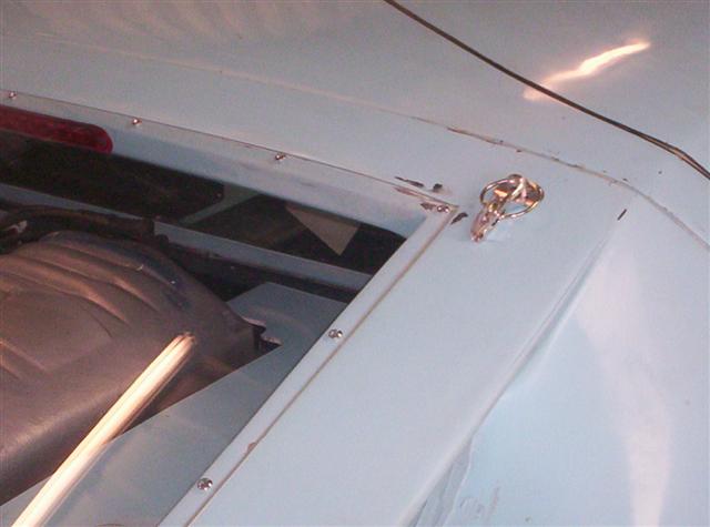

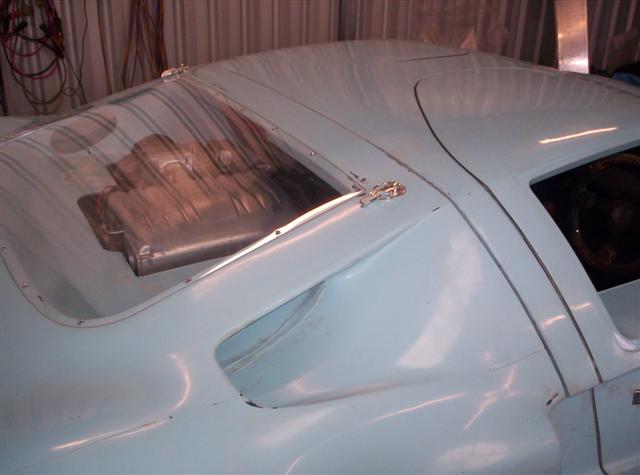

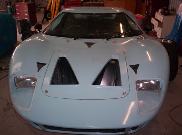

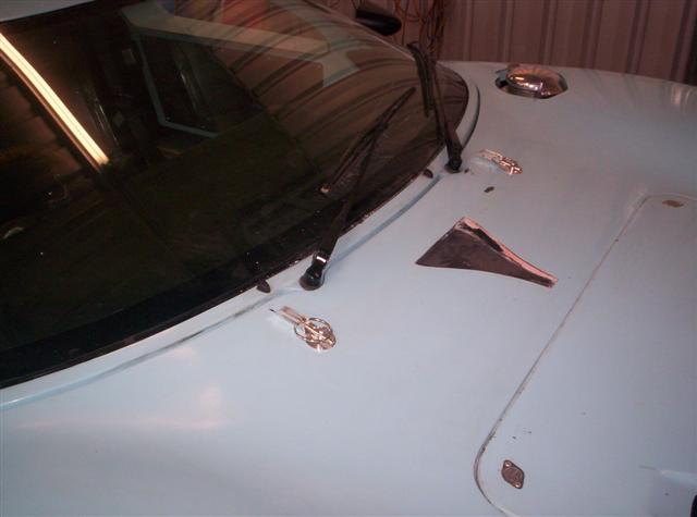

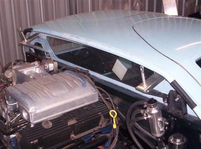

Fitting most of the body bits and pieces. Ended up fitting body pins on the
front and rear clips. Engineering testing this coming weekend so hopefully all tests are passed. Latest colour scheme I want is Black with wide
white stripes. If only I could choose a colour for a car and stick to it.:confused:
Drilling and sanding the rear clear engine cover was not fun, we used a glass drill to drill the holes and seemed to more melt a hole in it than drill
through it.

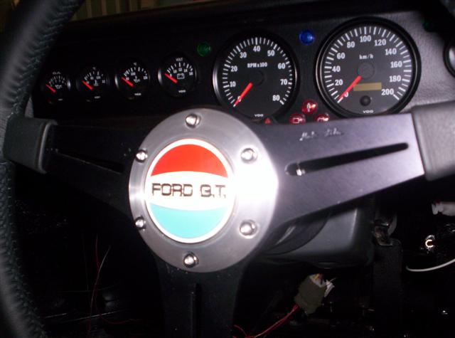

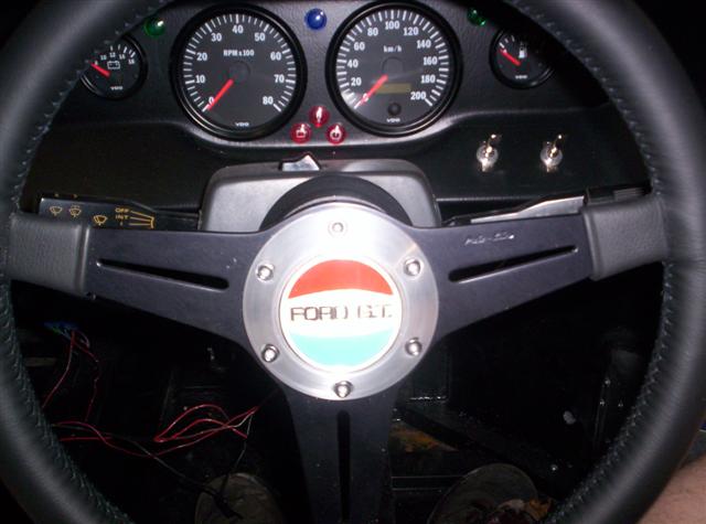

Fitted my MotoLita wheel today, Funny thing is I ordered a Blue
rimmed wheel as per orginal GT40 and received a black one, bugger.
It still looks ok.
