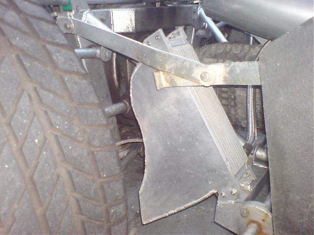

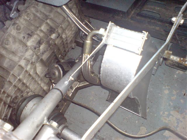

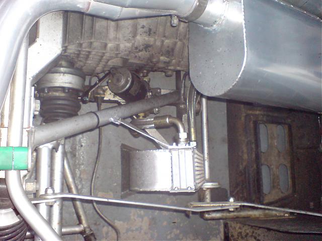

Finally finished off the rear frame and mounted the coolers.
