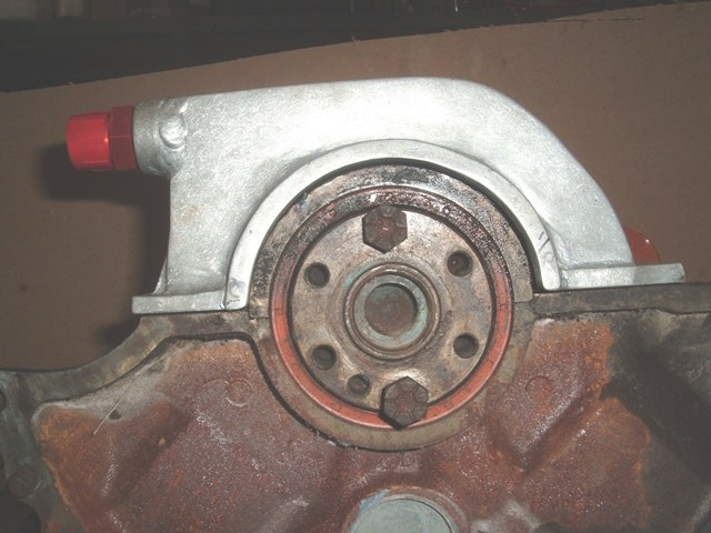

Pic #1
Note the clearance around the rear cap, zero on the LHS about 3mm on the RHS. Besides that the sump face is out of round. Not sure how it's meant to keep the oil in.........?

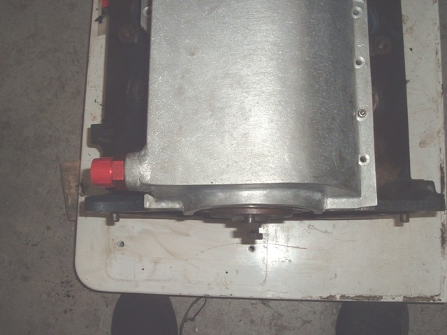

Pic #2
There is a further problem at the rear of this sump. No room for attachment bolts at the rear of the sump adjacent to the cap.

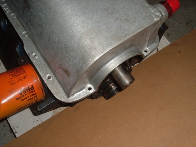

Pic #3
No room for bolts at the front corners of the sump either due to the squared off edges.
Maybe it's not necessary to use all the bolts, but I would certainly prefer to.
Now I'll do what I should have done to start with and cast my own. But since the ARE piece looked quite good, I thought I'd save myself some time because it looked to be just what I wanted. Never mind I think the old adage applies, 'If you want it done right do it yourself!'

I didn't try to get a response from ARE. The logistics of returning a sump from half way round the world make the exercise self defeating. Also I believe ARE knew this was a faulty unit and took the opportunity to unload it to the other side of the world.
The photos are of the sump exactly as it arrived. Note in Pic #1 that someone has written 1/8 on the face where the 3mm gap is. 3mm = one eighth inch! The coincidence and placement is telling.....I'm sure 1/8 refers to the gap. They knew alright. Chances therefore of a refund are pretty dim since they appear to have deliberately stitched me up.

Just had a look on their website- the pan you have is PN 1304 which shows in the photo that there is no provision for bolts at the rear main/front corners along with only 3 scavenge ports.
The pan I believe you ordered with 4 scavenge ports in dedicated areas for each crank throw is PN 1302 and is a much better 'looking' item along with having all the bolt holes. It is listed as being suitable for 302/351 which I assume means they have enough material in the area around the rear main cap to allow it to be machined to suit either configuration.
Jac Mac
Russ Noble
Jac Mac, they've changed their website since I last looked at it.
I wanted the 1302 but they said a 1306 was better for my application.
the 1304 Le Mans sump is a very shallow unit which won't accomodate the 351 crank throw.
So 1306 it was, but the photos now are totally different!
