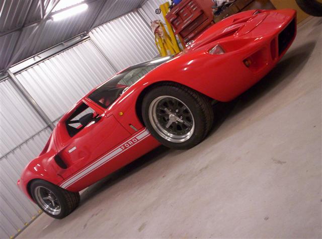

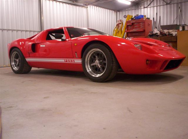

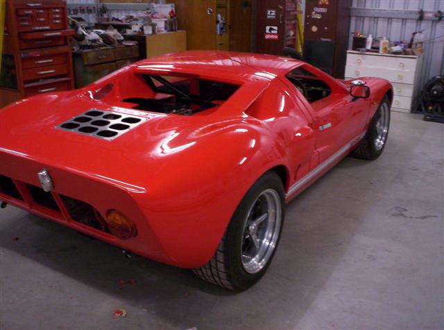

Hey Guys
A couple more pics of the car. Hoping to be driving again in a couple of weeks. Still got heaps of odd jobs to do so can't rest yet. Hope to get some shots in the sunlight soon.
Looks great Dave. Well done. When will you be out to play with the toy ??
Collie sprint is Nov 4th. May make a nice debut.......
