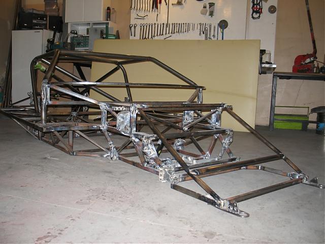

Hi Russ
Nice looking chassis. You didn't happen to throw it on the scales before adding all the suspension links / extras, did you? Interested to see why much she weighs.
I assume it's made from 4130 CM? (it has probably been stated, but there is every chance I missed it!)
Good work.
Russ Noble
Hi Troy,
Thanks.
The weight as pictured with full rollcage and including the front and rear subframes comes in at 108 Kg or 238 lbs.
Note it is not finished yet, there are still some brackets to fabricate. Main ones being door hinge mounts and seat belt mounts. There are also lots of little things like fuel pump mounts etc to do so it's likely to end up around 115 Kg or 250 lbs.
Don't forget though that a lot of the stiffness relies on bonded and riveted alloy panels so for any meaningful comparisons that must be taken into account. When that's done I'll weigh it and post it on this thread http://www.gt40s.com/forum/gt40-tec...-chassis-weight.html?highlight=chassis+weight
The really interesting weight though will be the all up dry weight. Anyone care to take some guesses.....
Chassis details, material etc are in Post # 65.
I see I haven't posted a view of the chassis from the front so here goes
