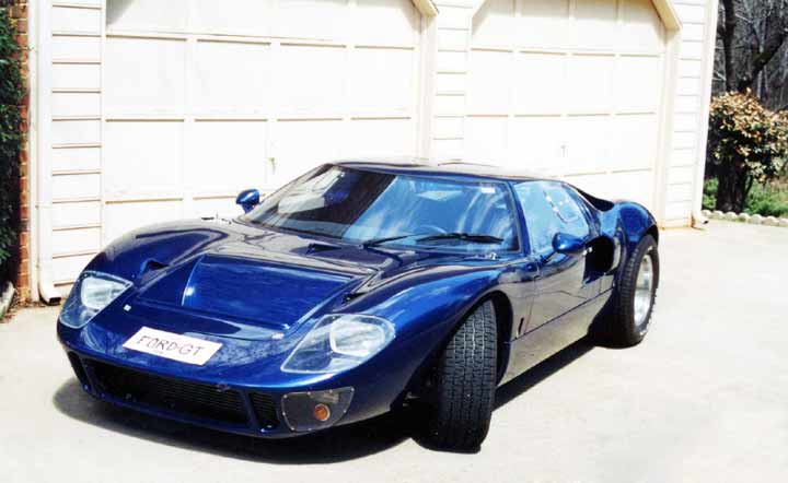

Victor, I put electric mirrors from a 1987 Mazda RX7 on my CAV. Before I put them on I was afraid that I would ruin the look of the car. I was absolutely amaised that they actually made the car look much better. I had baught two other styles before, one like the originals and one like on an Indy car. I have yet had anyone tell me anything but raives about how good they look. They cost me $50 including the control switch and wireing harness plus $85 to get them painted. I'll post some pictures as soon as I can. Good luck to all you guys. Joe

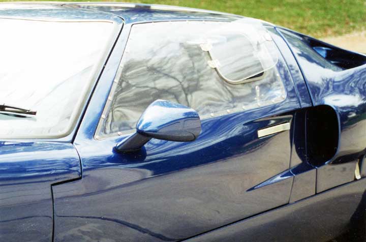

Another Picture of the mirror.

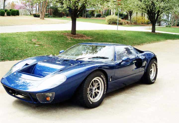

Dave, I got the Mazda RX7 mirrors at a junk yard that specializes in old cars. Those Mazda engines didn't last very long and there a lot of them at the graveyard. The RX7's also have a forth peddle to rest your left foot on when not on the clutch. I got one, but don't know if I will be able to use it in my car. It seems like it may get in the way because there isn't much room for it. I hope I have helped some of you guys. Your car looks great Hersh. How about a couple more pictures at different angles?

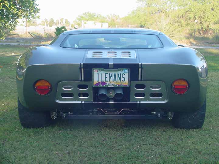

As far as the mirrors go, I posted several times as to what they were of of. I'm pretty sure they are off of a 1985-6-7 RX-7. In order for the mirror to conform to the door at the pedestal I used a hard piece of rubber about 1/4" thick and traced the pattern off the mirrors base pedestal. This allowed the mirror to conforn to the contuor of the door.
