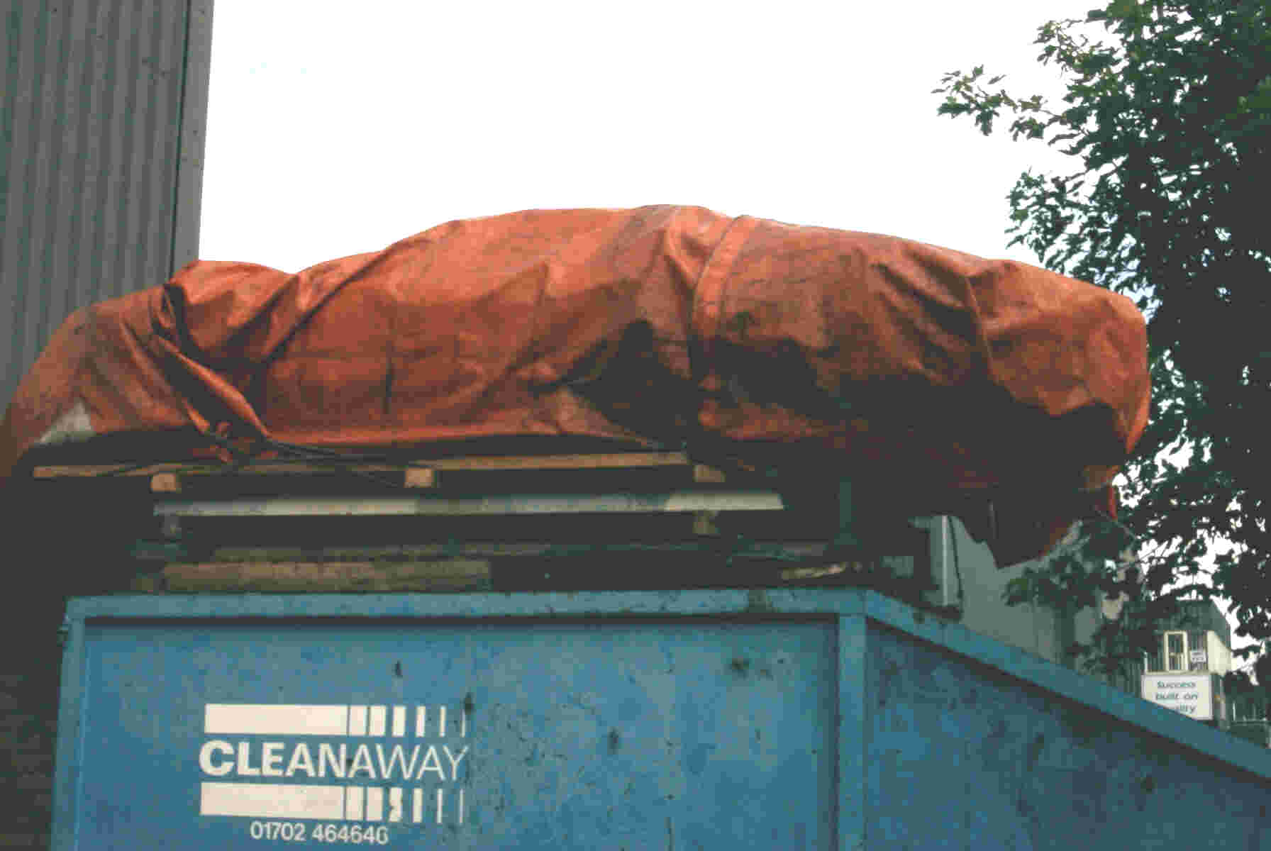

| Re: Raiders of the lost ArkMGT Gold ontop of the dumpster |

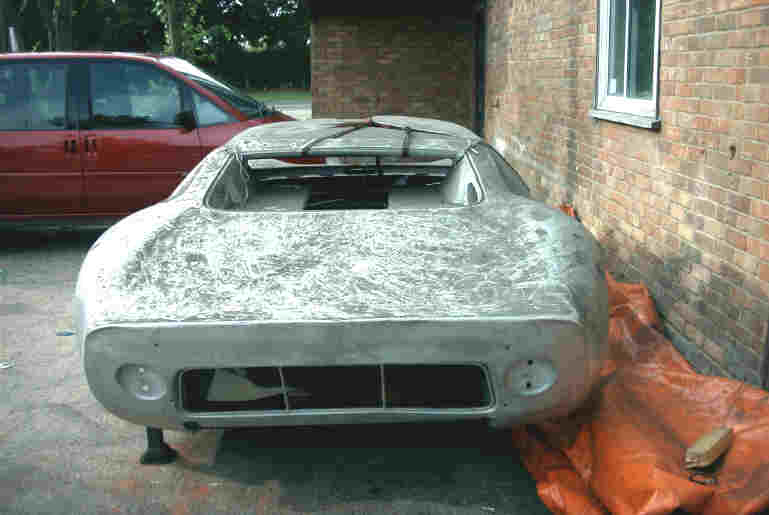

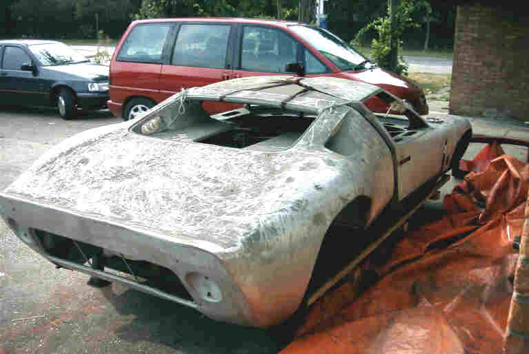

| Re: Raiders of the lost ArkMGT rear alloy clip |

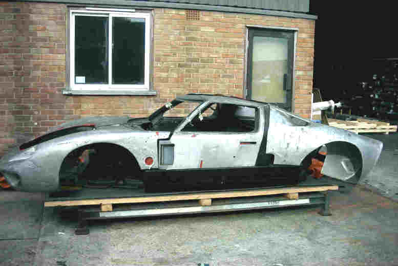

| Re: Raiders of the lost ArkMGT Alloy 3/4 shot |

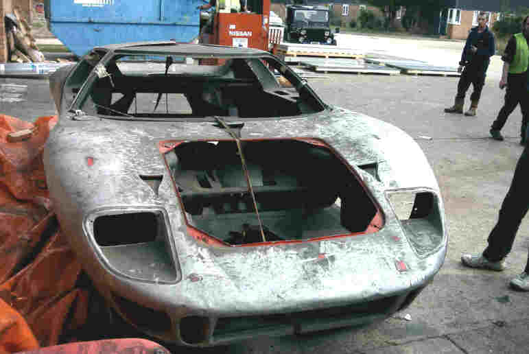

| Re: Raiders of the lost ArkMGT Front clip |

This alloy body is from AMGT-2 the Tenants panel chassis is as new and unused, however the B pillars have no scallops and are as the AMGT-2 B pillar maybe this was a racing spare, it also has webs between the engine mounting and trailing arm turret, a MK11, 7 litre feature. Maybe this was also a feature of the Alan Mann cars.

| Re: Raiders of the lost ArkMGT Hi Mardyn
Two Alan Mann cars were made as special lightweight prototypes for testing in 1966 all the body panels were made of light alloy. They were quicker than the rest of the MK1 GT40's and only slightly slower than the 7 litre MK11's
