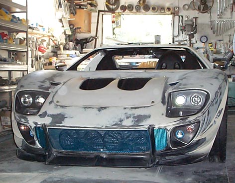

GT40 evolution in carbon fiber
Did you ever see something like that?
When I got my first ride in a GT40 last year the owner suggested to visit another guy who had a GT40 project in his garage which I would find more than interesting - and he was absolutely right!
The pictured car's body is competly made of carbon fiber with some added "goodies" like a diffusor, integrated front and rear spoiler, removable roof parts and so on. The interior is also mostly made of carbon and alluminium - hope you like the pics!
Cheers,
Volker

Old 02-20-04, 09:17 AM   #6 (permalink)
Fatal Attraction's Avatar
Fatal Attraction
Join Date: Nov 2001
GT40: Ex-DRB #35
Posts: 1,538
Re: GT40 evolution in carbon fiber
This guy must have a ton of time and money tied up there.
That much carbon fiber means BIG $$$$$$$!!!!
Neat front spoiler and diffuser!
Not so neat nostril panel and rear wing!
My hat's off to this guy! One hell of an effort! [img]/ubbthreads/images/graemlins/cool.gif[/img]

I am sorry. But that looks vile. The shape has been bludgeoned! Not sure what's going on here!
Is this a light weight racer? You might save some weight with a light carbon lay up. But the real savings in weight come from using Ali uprights, ali blocks, magnesium wheels, light weight shocks etc.
I bet that spoiler adds another 20kg! [img]/ubbthreads/images/graemlins/grin.gif[/img]
Each to his own I guess.
Also what chasis is it?
J.P

The guy who made this car told me that it's his own opinion of a further developed GT40 using today's materials and technologys. His intention was to create a car which can be recognized as a GT40, but improved in many details. For example, the front spoiler, rear wing and diffusor have been computer simulated before making and they should produce a front and rear downforce of more than 450 kg at 200 km/h. Radiator is made from two Audi V8 aluminium radiators, welded together and connected to eliminate the smallest possibility of overheating. Brakes are Porsche six-piston calipers. Instead of A/C he installed the removable roof parts - and so on.
Of course taste may vary - but the work is excellent done.
I can't remember exactly about the basic chassis type, but I think it was a Tornado frame. I'll add another pic of the fron section, maybe somebody recognizes the chassis type.
Volker
Something doesn't look right...
This guy has spent a ton on carbon fiber body/interior...
but the frame is 50 year old tube steel technology.
And the suspension is probably 40 year old technology.
Sorry...not all that impressed.
MikeD

[ QUOTE ]
[/ QUOTE ]
At first that's something I couldn't understand, too. I asked him why he left the frame nearly untouched, and he answered that for his opinion a tub steel frame is not that bad compared with a monocoque - but main reason was that the frame in the shown condition is street legal here in Germany!!!
Of course this carbon fiber body is expensive - even if you have some good connections to people who work with it daily - but it's possible to get this modifications certified and legalized.
On the other hand building a new chassis and especially getting it legalized for street use would probably more than expensive, even for somebody who is not a poor person.
The german TÜV organisation can be a huge hurdle for somebody who needs their blessing to use home-made cars on the road - and some owners never manage to climb about this hurdle.
Concerning the suspension I assume he made some further changings - the pics show the nearly finished body, but new brakes are not yet mounted, and some other technical work wasn't finished, too.
For me it was really impressive that this guy realized his dream - even if I don't agree with every detail of the body shape, I admire his kind of work.
