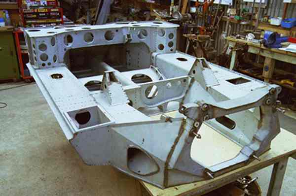

Things have changed a little, I've contacted David Brown and had a very incouraging discussion about him producing a replica chassis for me. I am happy with the price and will order one when funds are avalible sometime this summer.
How much I hear you all shout? well a rough estimate is $60,000 NZ which at todays rate is £22,900. Cost of shipping will be about £1000 if I share a container. Delivery will be about 8-9 weeks from order (excluding shipping time).
For those not farmiliar with Davids work I found a shot of the chassis he builds, its zink plated steel.

sounds very similar to the adams-mcCal chassis, and the new one yet to be announced.
Any ideas if you would need to pay import duty on that chassis ?
If so it could make it more expensive than the uk alternatives.

Andrew, I've just been down to Invercargill and had a look through Dave Brown's workshop. The finish and attention to detail on these mono's is just amazing. From your point of view it's a pity the NZ dollar is at it's highest point for the last twenty years. [img]/ubbthreads/images/graemlins/frown.gif[/img]
