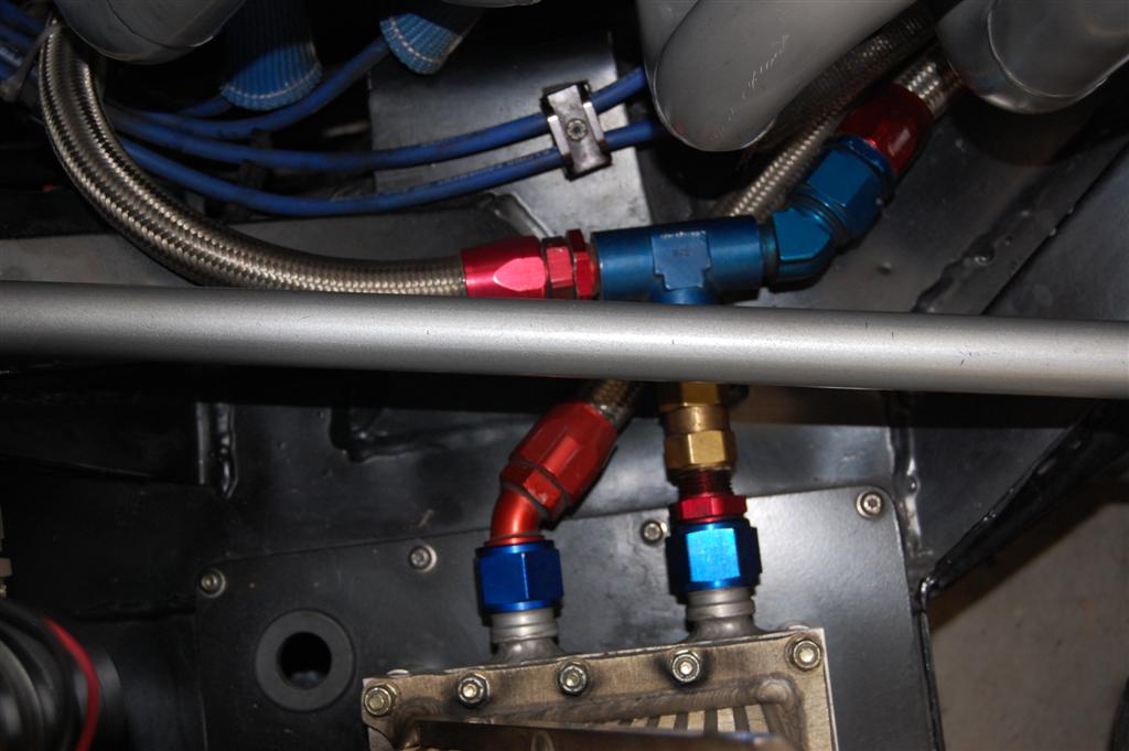

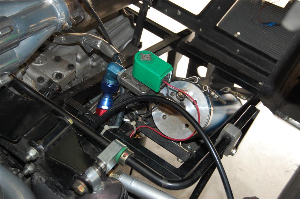

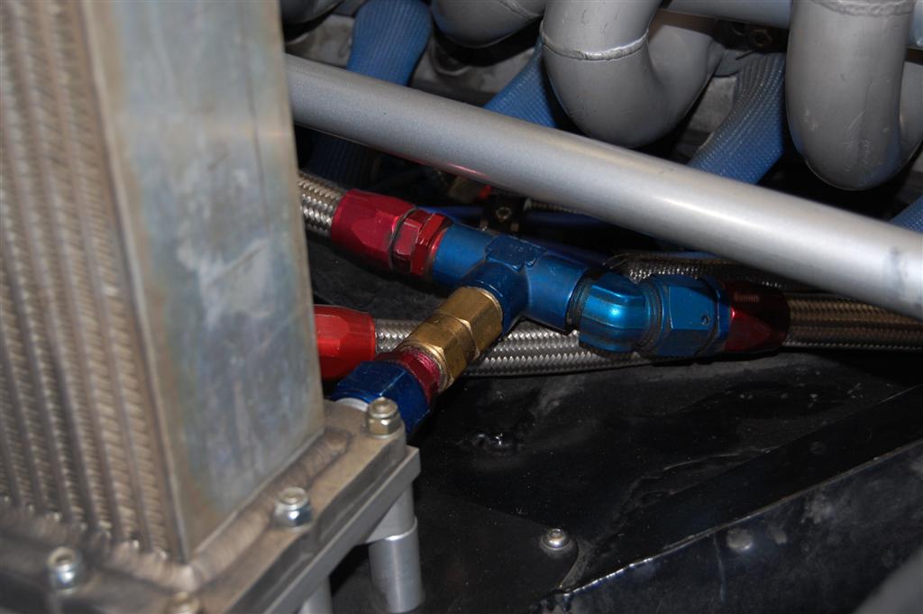

Here are some photos of my Accusump install. I wish I had been able to orient the T so the Accusump fed in from the side and gave a straight shot for the cooler to engine line, but that's the best I could come up with in the space. Maybe someone else has a better idea. I welded in a tube frame to hold the Accusump at about a 45 degree angle. Anyway seems to work fine for the few track days I do per year. Works great as a pre lube too.

Re: Oil Accumulator Install
Thanks, that helps a lot
