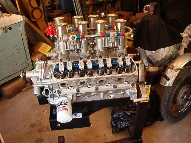

CAV & Webers
No problem, they work on my car ....Vic

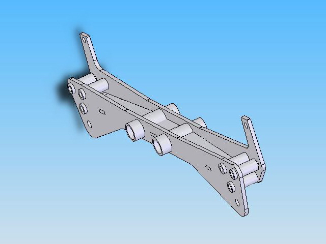

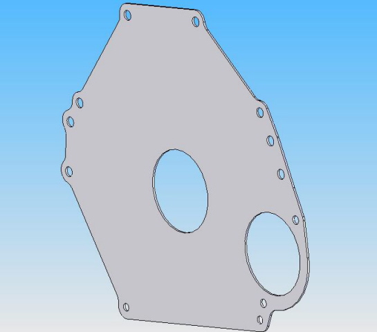

Hi Cliff
You may not be able to use the backfire plate or air cleaners on Webers in a CAV with the Audi/Getrag transaxle. The reason has to do with the increased height of the engine due to the location of the input shaft to the transaxle being above the differential, rather than below as in the ZF application.
Your stock 302 on Webers will probably not hurt a Getrag if driven carefully. For more poke and choice of ratios, seriously think about going to a ZF. New boxes are available and our retro fit ZF kit will be available soon.
The ZF kit will include the transaxle mounting bracket (CAD drawing attached), dedicated bell housing casting, motor plate for starter location, motor mounts for pre s/n 100 CAVs and complete shift rod mechanism. Price TBA but this is going to make the upgrade simple - something we all need in the land of '40 LOL.
Hi Victor, that engine actually fits in your car OK (not just on the engine stand......)? Looks beautiful by the way! You use the ZF transaxle?

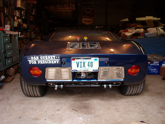

CAV & Webers
The engine fits fine. I am using the Audi 16U trans with no problems. Look at the rear window pic.

Hi Cliff, Victor
I'll keep everyone posted on the conversion kit for sure. Sample parts are being tested right now.
Vic, love your bumper sticker. The Webers do fit in a getrag application without the backfire plate installed.
