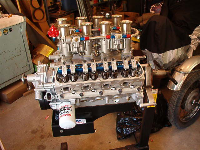

No problem, they work on my car ....Vic

Hi Victor, that engine actually fits in your car OK (not just on the engine stand......)? Looks beautiful by the way! You use the ZF transaxle?

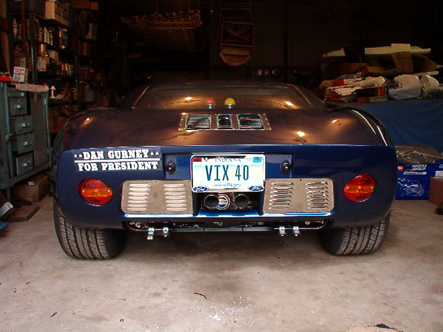

The engine fits fine. I am using the Audi 16U trans with no problems. Look at the rear window pic.
Vic
