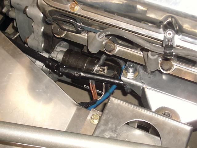

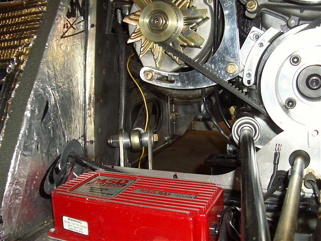

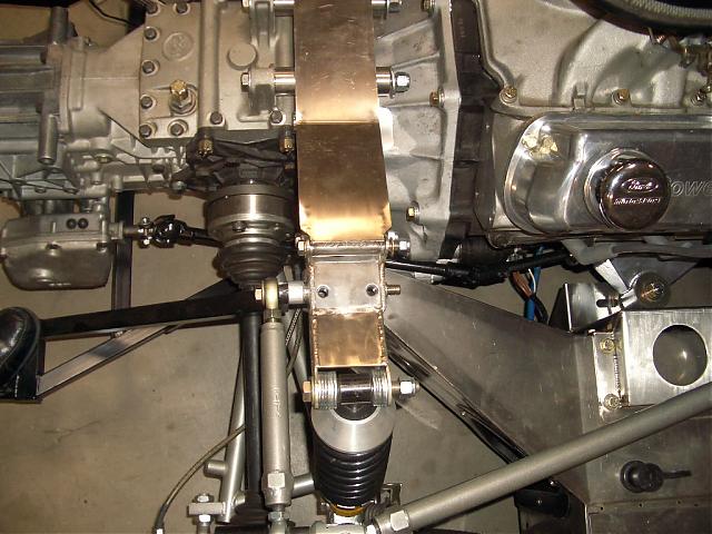

You are absolutely right that the best geometry for the shifter would be a single rod exactly inline from the ZF straight forward to the shifter with no jogs and no u-joints. However to mount a rod shifter in the center console I needed to get around the bell housing and the engine so at least 3 jogs are necessary. There is a jog to the side at the u-joint at the end of the shifter but it is essentially a straight shot from there, through a support at the engine cover and back to a support on the motor mount.* A second rod then goes from the back of the motor mount direct to the control shaft on the ZF. I have already posted pictures of my “length and rotation adjustment coupling.”
The exact length of the rods, location of the u-joints, and the exact path the rods must take is slightly different from car to car depending on the chassis, how low the engine is mounted, what oil pan is used, and other clearance issues. On the design that Jim and I came up with, we went overboard trying to make sure our shifter design had maximum adjustability. The shift stick in the cradle can be adjusted back and forth to center in a console opening, the u-joint at the end of the shifter can be located anywhere in the area between the shifter and the emergency brake. For that matter the shifter cradle itself can be mounted raised or even angled to one side and will still work perfectly. The secret as Gary suggested is that the linkage must have minimal flex and be well supported.
Here are a few pictures of my linkage through the engine bulkhead, to the motor mount, to the transmission. These photos are before I installed the length and rotation adjustment coupling. To the best of my knowledge this shift linkage route is similar to most center console ZF installations.
(*However having this one rod all one long pieced make it more difficult to install and remove if needed. I added a straight aligned u-joint just in front of the oil pan just for service convenience.)
