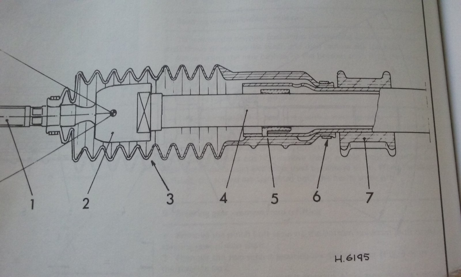

sorry, no.. i'll look for a picture. its the plastic bushing inside the steering rack, which guides the rack-bar left and right.
Number '5' on below drawing. This is not necessarily the CAV rack by the way. just a good drawing I found.

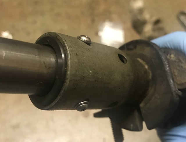

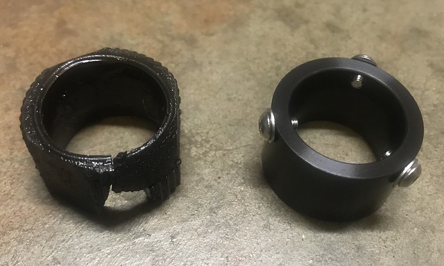

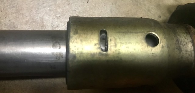

The pictures attached show a disintegrated bushing similar to mine.

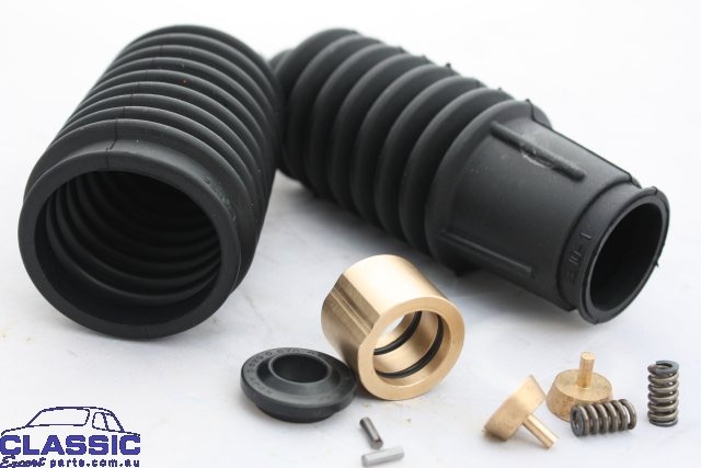

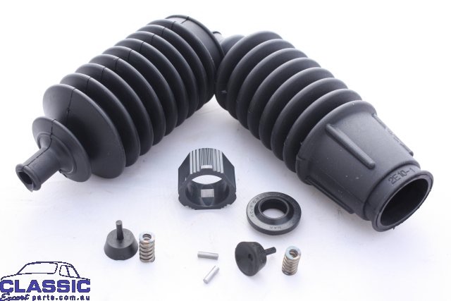

look to internet steering rack ford escort capri overhaul kit
Paul
Sorry Jasper, I didn't read your post correctly, my fault. Sounds like Ford 6103650.
