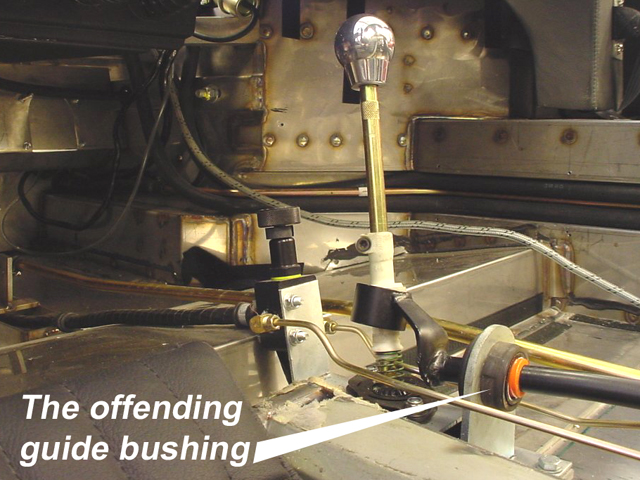

So what are the odds that the plastic guide bushing for the shift rod would pick that particular weekend and that particular morning to crack apart? The stock CAV Audi part shifter was ok but with the guide bushing loose it was now like shifting with a fly fishing rod. Even nirvana does not last forever. So here begins the tale of the CAV shift mechanism upgrade.

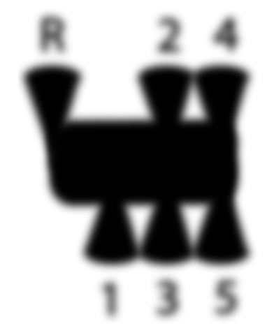

So here begins the tale of the CAV shift mechanism upgrade with the boring perfunctory parts first. The stock shift mechanism looks pretty much like what a big manufacturer would produce and put in a street car (see pictures above). It has a number of stamped steel pieces, custom injection molded bits, minimal welding, and no machining. And, at first, it was fine because I did not know any better. The shift rod was well supported from the shifter to the rod end in the bulkhead, to another rod end on the motor mount, and then to the ZF. Selecting gears was a little vague and felt more like an old Porsche than a Cobra. Slowly over time as the plastic and rubber parts wore down the shift pattern evolved from vague to Mr. Magoo. The big plastic and rubber donut bushing was the first thing to finally crack and get so loose that the shift pattern looked like this:

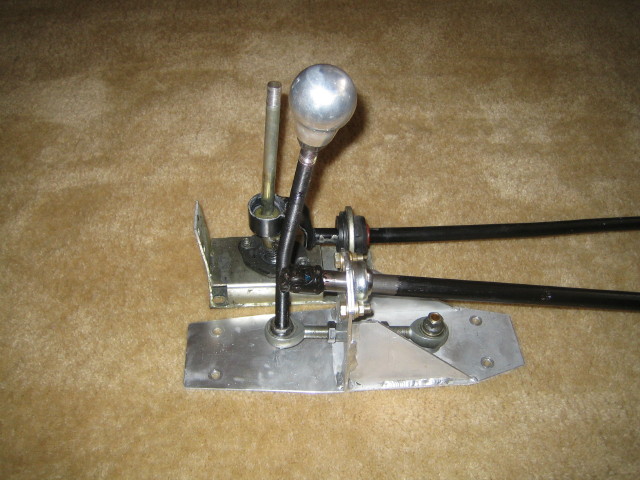

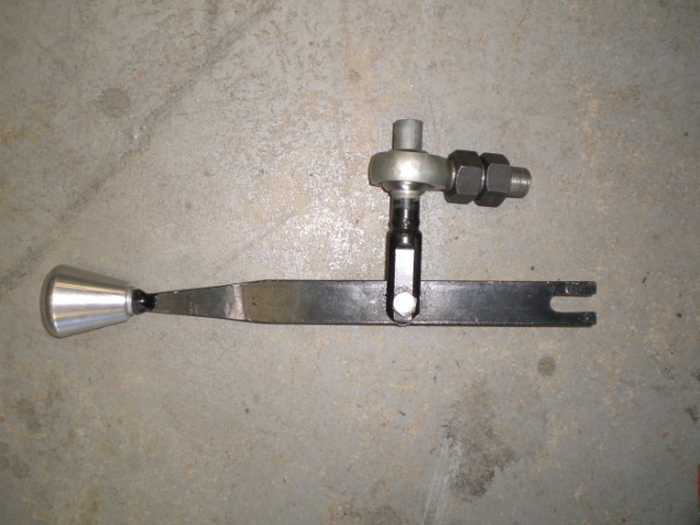

Here is a picture of my first attempt at replacing the cracked plastic bushing and tightening up the shift mechanism. It’s pretty much just an ugly patch on the stock shifter in an attempt to keep the horizontal transmission rod held rigid and only allow the tube to move fore/aft and rotate (no pitch or yaw). Interestingly enough this was the same change Ian also tried. I also relocated the entire mechanism a bit to the rear also so the shift stick was exactly centered in the console opening when in neutral. The u-joint was moved as far back as I could and the rod ends were located as far apart as space allowed. This patch made the shifting better than with the original stock plastic bushing but it really just encouraged me to see if it could be even better......

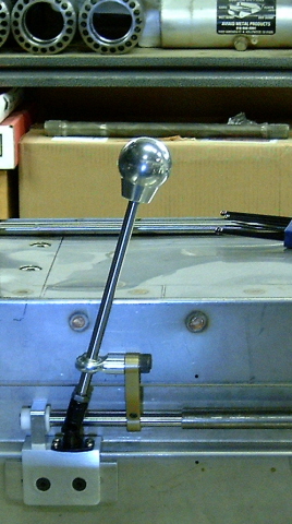

An alternative method of actuation is where the handle directly rotates the shaft and the fore/aft motion is controlled with a rod end. There is a u-joint welded to the shift rod and a rod end at the bottom. Plate structure is aluminium and the shift rod is a fine 1/2" all thread. This allows adjustment of the handle length to suit driver taste and the adjustment of the rod end "throw ratio" at the bottom. Works very well!

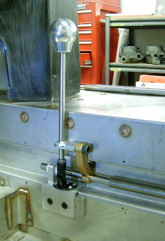

As best as I can tell there are only two basic “rod” shifter styles or methods being used on our cars. And now thanks to Ian and Gary we have pictures of both styles.
One design has a pitman arm attached to the transmission rod. The force to rotate the transmission rod, and move the rod back and forth is applied by the shift lever out AT THE END OF THE PITMAN ARM. The stock CAV shifter, and the examples shown by Ian, use that method.

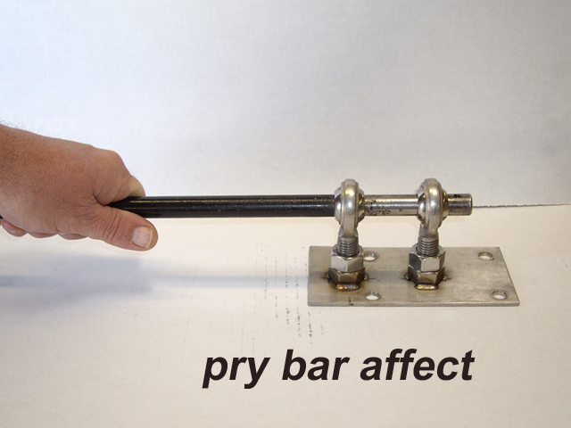

Each of these methods has some advantages which essentially are the subjects of this thread. As I worked with the stock CAV shifter I realized that the overall structural rigidity of the shifter is the key to a crisp feel and a no wobble shift pattern.
The first patch I made to the stock shifter was not enough. I added the two rod ends on a separate mounting plate, and then added an additional base plate just for more structural rigidity. The whole assembly was welded together and bolted to the stock mounting brackets on the floor of the CAV. The improvement was day and night but I was looking for perfection now.
Holding the transmission rod fixed, I could still move the shift lever and see the rod ends flex to the left and right and I could also feel the plastic parts in the pitman arm compress. This picture shows how the transmission rod on the unsupported shifter lever end acts like a pry bar to move the rod ends left and right.

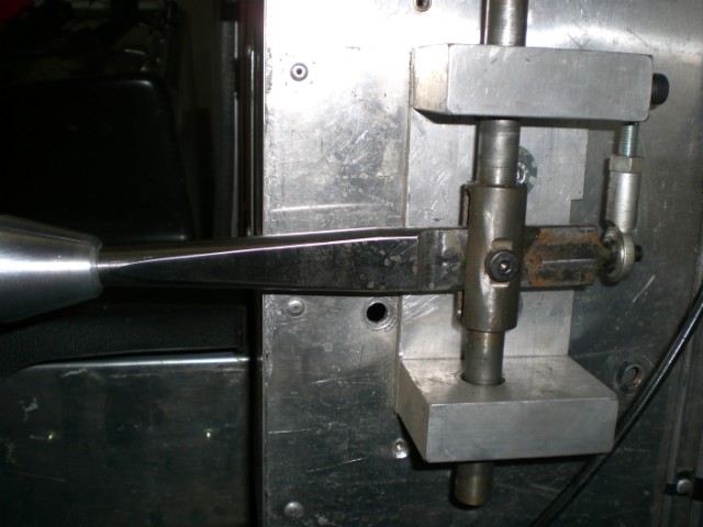

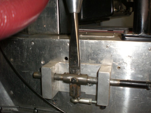

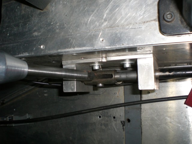

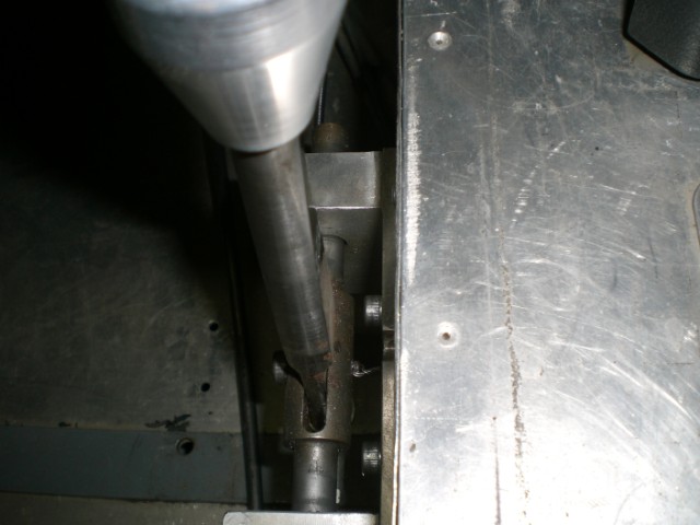

Ross Nicol
Bob Here's my shift for the ZF which is the concentric 1:1 style. I got the design from a F1 Brabham circa 1973.The alloy blocks don't need to be that big but it works a treat.Teflon bush in each alloy block.The last pic is my original shift which I used for a couple of years. I believe the new shift which I've had for a year now is the ultimate, absolutely no free play and makes quick race shifting easy.
Ross

Ross,
Could you show a pic of the underside of the blocks. Is there another rod end under there to allow the rotation? Can't quite figure that part in my minds eye.

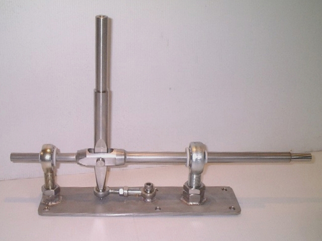

In this case, “gone direct” means to entirely eliminate the pry bar affect all I had to do was to place the supports for the transmission rod in front and in back of the shift lever. If the lever was between two wide spaced rod ends the pry bar effect is gone. Also, if the shift lever is operated concentrically on the transmission rod then the other offset forces from the pitman arm are eliminated.
Ross Nicol
The support in front and behind the gear stick is the solution to flexing of the gearshift rod. Quite a lot of pressure from the ratio of the stick is applied to the rod which I found was ok when pulling the rod but would flex it, when it was being pushed. I could feel the flexing when changing gear and totally fixed it with the new shifter. The reason I made the alloy blocks so large was to make absolutely sure the flex would be eliminated.I like Jim's design but I think a heavy hand could flex the rose joints IMHO.
Bill there is a male rose joint underneath the rear block and bolted to the block.Does that make sense? I'll take another photo for you if it doesn't.

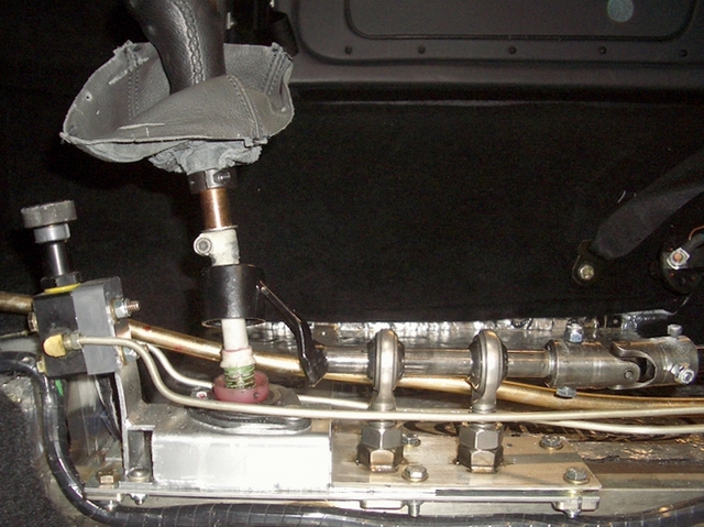

Here is a picture of the space available in a CAV for the shifter. The water radiator pipes are in the side pods and so there is more space available than in some replicas. Good news. On the other hand the brake bias valve on a CAV is mounted ON the stock shifter and it was now in the way of the front rod end of the prototype shifter. The easy solution was to just relocate the brake bias valve 3 inches forward on its own independent mounting bracket. It can be mounted standing straight up like in stock form or it can be tilted back toward the driver with the knob ending up more in the original position. Good news again.
Shifting was absolutely transformed with Jim’s basic prototype. It worked exactly the way Gary and Ross both described for their own versions of this concept. I love the simplicity of the design but Jim and I both thought it needed to go on a diet.

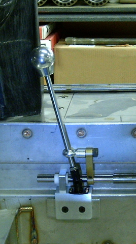

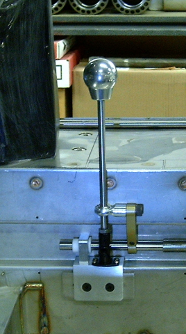

Supporting the transmission rod between two big rod ends is convenient but unnecessary. Since they are always perfectly inline, they could be replaced with plain bushings and Teflon inserts. Likewise the long heavy base could be replaced with a shorter cradle that held the Teflon bushings at each end. The small rod ends that stabilize the bottom of the shift stick were retained. Here is the next step in the sequence of making a trimmed down prototype.
