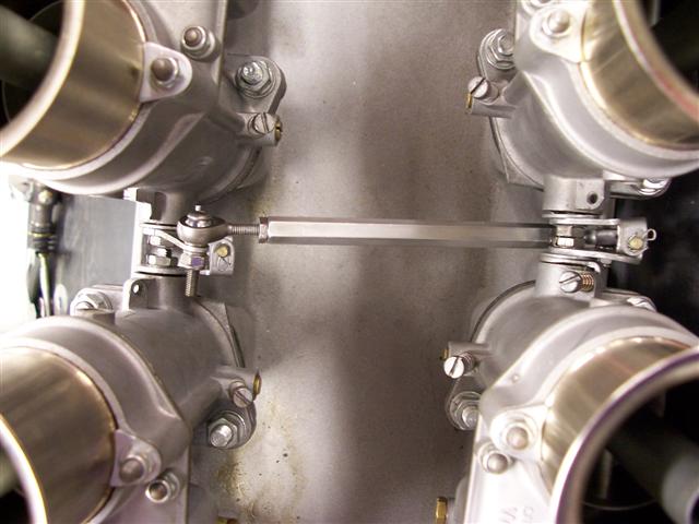

do any of you guys have the part numbers for a center bellcrank type throttle linkage, My Kirkham has one but the webers are mounted fuel inlet inward and the CAV faces them outward, also the 427 manifold is larger so the linkage is different. It looks like this.

How about a linkage like this one?
I have a bracket that the cable attaches to for it.

Pat ,I think I have that bracket.
