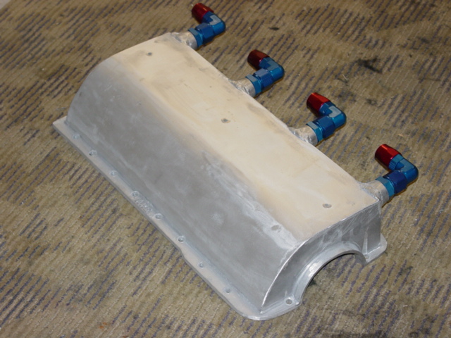

I got a sump from them, it was a custom 4 pickup that was cast a little deeper to accommodate my 401 ci Windsor. It fits like a glove, sorry to here of your problem, it took them like twice as long as they said but when it got here I was happy. I sanded and sanded and sanded, to get it smooth enough to polish though. Here is a picture of the unit.

I think that just proves my point. TX is not that far from CA. You got a good one. NZ is on the otherside of the world.
The thing that hurts also, is that I paid US$270 for airfreight because at that stage I needed it to continue my build! Otherwise it can be up to 3 months by sea. Which is the way I get most stuff.
I suppose the upside is that for the extra $270 I found out 3 months early that it was unusable
