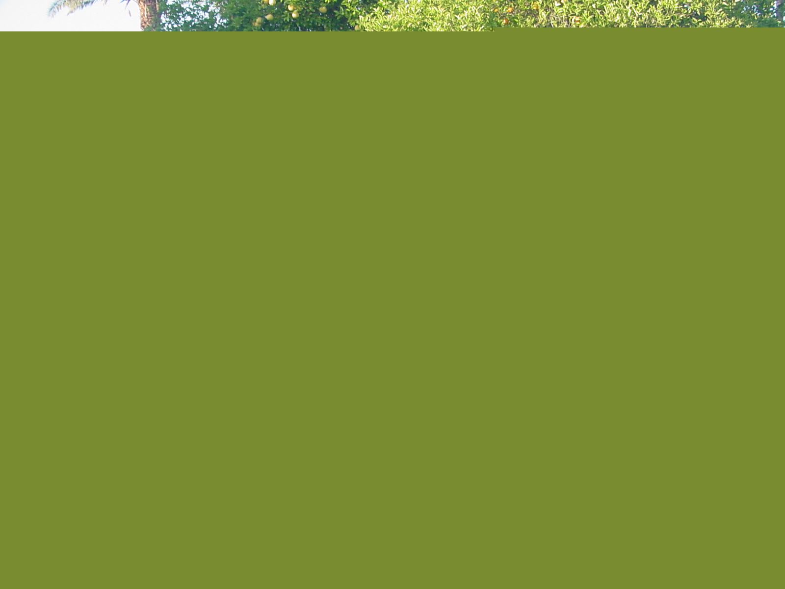

Sorry folk but I have no idea why the photo didn't print but here it is...
Name:	22412-GT40 in the front yard 004.jpg
