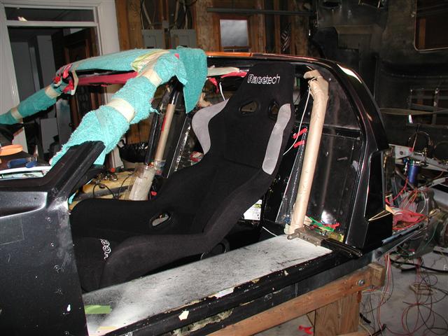

Hey Bill
I'm keen to know how the Racetech seats fit.
I'm looking for an alternative to the DRB items.
Looking forward to seeing your car in the sunlight.

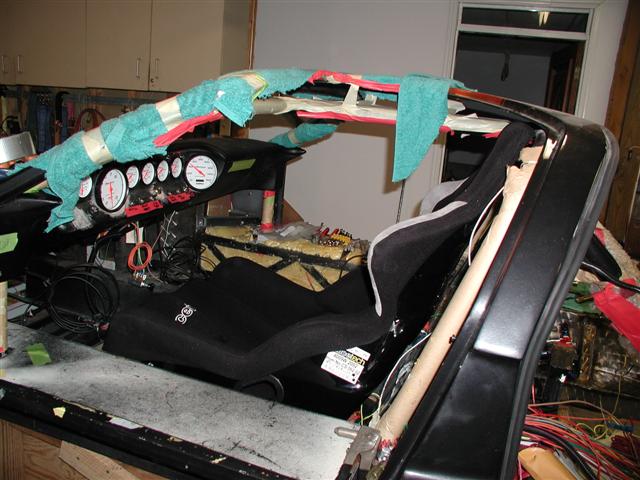

Re: DRB #5
I spent all yesterday working with just one of the seats. DRB's use the corregated floors, and with the seat in full tilt, it matches the rear firewall and the leg room is perfect. Good thigh support and slight bend of the knee. That is the good news. The bad news is that it sits a little high. When I pull out the seat padding(velcro), then my head is under the door(I'm 5-9 and shrinking every year). So I am thinking of doing the low seat option that DRB is now offering. Along with that will be some inginuity with the mounting brackets. That means some fab work. I have it worked out in my mind how to accomplish it. Now all I have to do is,,,, do it. I will post the results when done along with pics.
DRB#5

Hey Bill
My car has the super low floor option so yell if you want some measurements. It's flat so mounting a seat seems easier.

It would be interesting to know how far down the deep seat option is. The "ribs" on the flooring are only one inch. I put the seats in full tilt and they almost meet the slope of the firewall. The top of the seat with one inch removed will just barely fit under the roll bar. Even then it will be tight. these are the wide option seat. The regulars are a very tight fit width wise. If most of you New Zelanders use the regular option, then you all have the skinnest arses in the world. I did some measurements to see what could be gained. From the top of the ribs to the sill is aprox. 9 inches. The height of the front lip of the seat is 13. So the front lip of the seat will still be above the sill height if the ribs are removed. The seat bottom where your bum goes is 4" off of the floor(top of the ribs). I could take the seat pad out and be an inch off the floor, but there is no padding. Guess I could trim the seat cushion, but that seems to defeat the whole purpose of the seat. That 4 inches also cuts down on the forward visability due to the roll bar. The leather wings(the grey area) seems to stick out too far, and the seat apears too big for the car(proportionally). It looks like I am going to have to go back to the drawing board on this idea. In a world of inches, and inch or two makes a big difference. These are really nice seats and also aren't very cheap either. I guess they would make nice lounge chairs for the garage!! If anyone has a setup where height isn't a problem, these would work out great. Let me know if anyone is interested.
Name:	P1010262 (Small).jpg
ID:	17144   Click image for larger version
Name:	P1010261 (Small).jpg
ID:	17146   Click image for larger version
