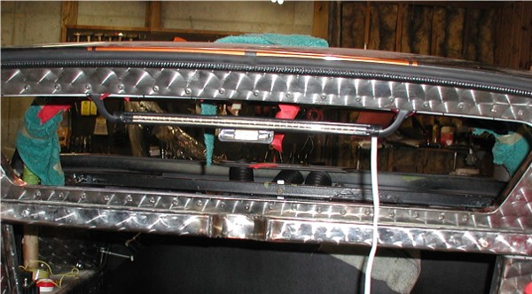

We had to construct a place for the license plate.
Then finish it.

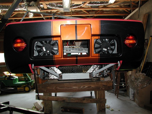

Well, after a brief rest from the car, actually dealing with life’s little inconveniences, I’m back on the build trail. I have finally had the short block built and collected from the builder. I also have acquired some of the less glorified parts of the build. To date I have gotten:

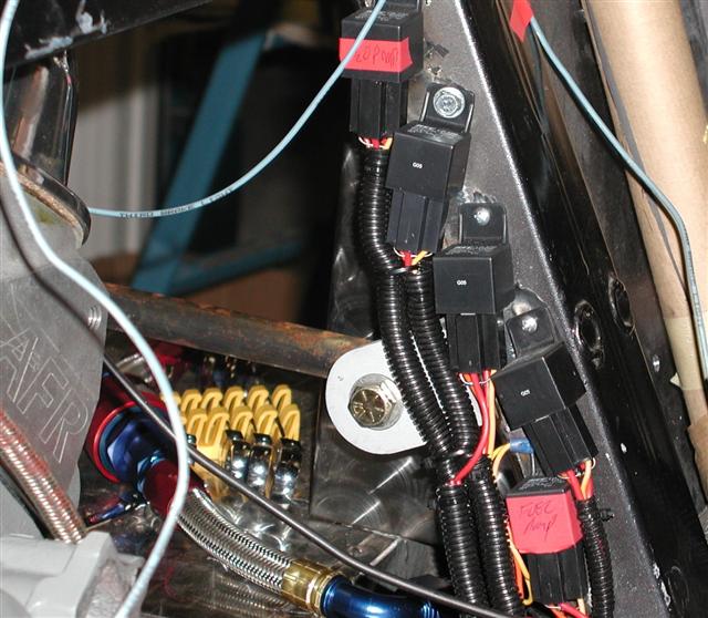

1. Auto wire Highway 22 wiring kit. This kit is everything you need for one of our builds. I got two extra double relays and a few smaller items and it seems that’s all I needed. I am using 4 fans (2 front radiator and 2 rear small radiators for the oil and trans) and two pumps (Moroso electric water and Mocal transmission). Their instructions are very straightforward and their support staff is top notch. I wasn’t going to use the GM column connector and they helped with the rewiring to the extra switches and grounding needed. They even showed me how to wire in a safety and antitheft wiring for the ignition when I raised a question about wiring in the high-pressure fuel pump. It saved me from having to purchase a neutral safety switch. As you can see, I have 2 extra power outlets that may be used for the Mocal pump and a remote camera setup(one day).
2. Vintage Air Gen II A/C/heat/defrost system. I chose the Gen II mini unit and it fits like a glove. Haven’t done the hard tubing yet, but it is soon to follow. It measures 7.3”wide x 9” tall x 19”long and is hidden fairly well by the dash. It has 3 main outlets; two defrost outlets, and two foot outlets. It uses servo-actuated valves, and is a true bilevel operation. For now I mounted it in the center of the dash. If need be it can be moved over to the right side if space becomes necessary.
3. The Kennedy adapter and clutch package. My car came with an adapter but its measurements (mine) were off from theirs by ever the slightest and I didn’t want to save a dime to spend a dollar, so I ordered theirs. If mine checks out to be theirs, I will offer it up for sale later. It should be here in a week or so. I went with their heaviest pressure plate and organic clutch for the street. I plan on limited track time and I don’t think I will need that kind of compressive forces.

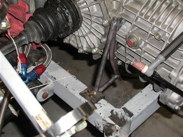

In an ever ending search for space on a GT40, I have come up with an idea which I plan to do with mine that others may want to explore. It started out with wanting to move the engine further forward to aid in balance. I also want to use a Moroso electric water pump. As most of you know, the Moroso unit sticks way out there. So not wanting an arm rest, the pump had to go. Not away, but out of the way. In one of my earlier pics, I had decided to leave the sloping side panels in the engine bay. The more I looked at them, the more they had to go as I was replacing all the panels elsewhere. I was going to replace them, as they were, with stainless. Then I got to thinking about space. It was going to be at a premium as I wanted to add a remote oil filter and cooler and a transmission filter/cooler as well. The move forward necesitated an ignition system without a distributor, thus the Electromotive unit with multiple coils. Well as usual, one change nesesitates another. I had sent inquires to others who were contemplating moving their pumps, but got no replies. So after a few cool ones and looking at the area, and contemplating what to do, I came up with an idea or two. The forms in the pics will be used to make templates, which will be transferred to stainless panels. On the right side will be the coils for the DIS unit. Maybe even the high pressure pump. This panel just does clear the bolt on the lower trailing arm, so it is still accesible(barely). The rear section will have the pump/filter setup for the trans cooler. The left side has been lowered further to accomodate the Moroso unit so It doesn't stick up beyond the top rail. It will also hold the remote oil filter/thermostat setup on the way to a rear cooler. The Moroso unit may face toward the trailing link or toward the engine bay. Final position will be determined by clearance issues with the trailing link and the A/C unit. So I have drawn in several posible locations. The trailing link makes contact if raised much higher than it will ever go, but if the suspension ever fails, it may make contact. I still have to make the adapters for the hoses. The rear section will hold the battery for now.
I don't know how or if the other models of 40s can be altered for space, but there seems to be a lot of room in some between the engine and the lower trailing arms.
I have sent the pics to Peter Ransom for his take on it. It could be incorporated into the GT40 Australia cars, as they have not changed this area from the original DRBs that I am aware of.

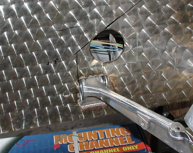

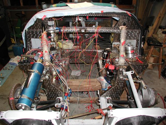

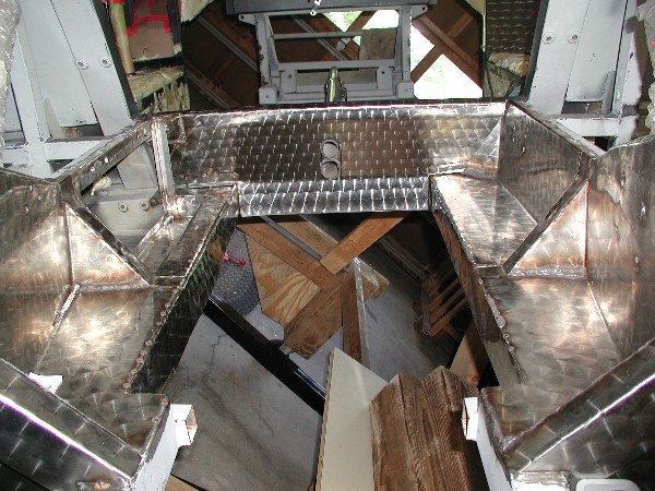

I have been a while since posting on my progress with DRB#5. Sometimes I feel as though I am the only one currently building a GT40 that is constantly interrupted by what I call “Life’s little inconveniences”. About the time I start to order some expensive parts, up pops a new one. This spring I thought I would have the car finished this summer, as I was encouraged by my wife who is tired of all the wham, baming in the basement (bending stainless can be a noisy proposition). I think I have found the way to get the car finished. Just irritate your better half enough with the build, and they will tell you to hurry up and finish the damn thing. Well, as usual, and right on queue, another hazard has popped up. So it is delayed another month or three.
These delays have, other than depleting the budget, been beneficial in a way in that it has allowed me to get some things done that are extremely time consuming. I decided early on that the panel work on the DRBs was to my liking. I wanted my car to be as good looking on the inside as well as on the outside. The steel panels that came with the car would have to have a finish applied in order to inhibit rust. Paint was not what I wanted. So, stainless was the choice for me for several reasons. Knowing my limited knowledge of working with stainless, and my twenty years since any welding (class in a voc-tech school). I knew the learning curve was going to be steep. I knew the panels would have to be put on and off the car many times before they were right. That means slight scratches and warps. The stainless would have to be coached into place where bends and angles were not 100% lined up, and not having a commercial brake to work with, I had to improvise, and came up with a home made brake that would do the bends to my satisfaction. Some of the bends would have round edges, other sharp. That would leave some marks even with the whacks on the bender to make them sharp. Below is my homemade unit. Some improvisation has to be utilized when compound bends are made, or the length of the piece is shorter than the face of the bender. Here it is with the one armed bandit attached to help out with the bending. The trick to using the angle iron is to face it with duct tape.
With the new software, I can't post as I did with the old setup.(Text, pics, text, more pics etc.) The new software only puts the pics at the end of the post. So I will make several post

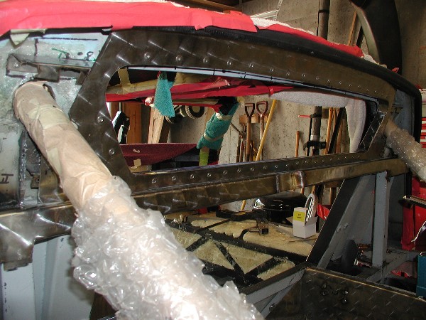

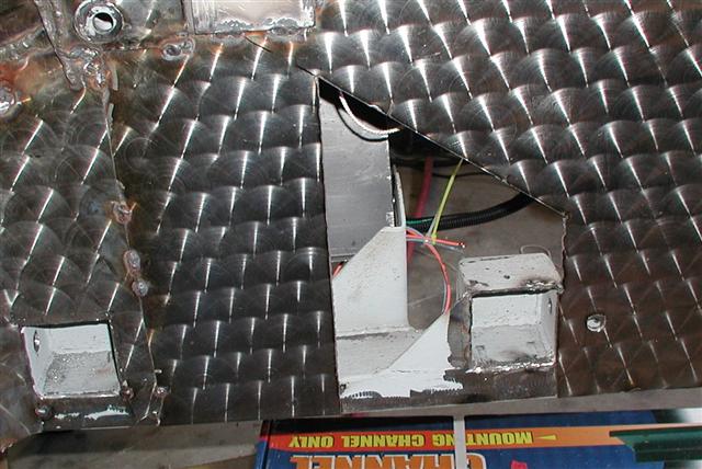

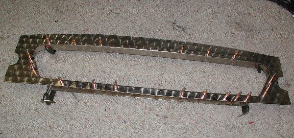

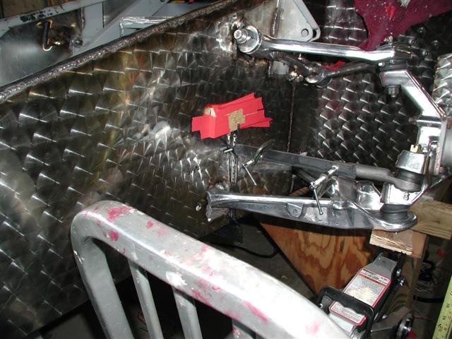

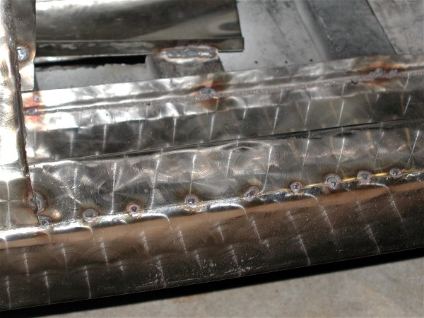

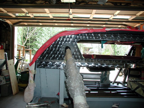

I have for years liked the finish of Machine turning. With practice and guidance from an engineer out California way, I mastered the technique. Heat is the big enemy causing the panels to warp. Water didn’t help much. The engineer told me about using WD40, and that soved my problem. I built a slide table with my Shopsmith suspended from the rafters and braced to the wall to give the finish to pieces too wide for the throat of the machine.
The trick to replacing the panels was to make templates of each panel. To put holes in the panels, I used a plasma cutter and a template for the various sizes in ¼” plywood with Fortsner bits.

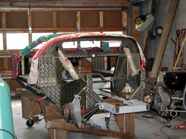

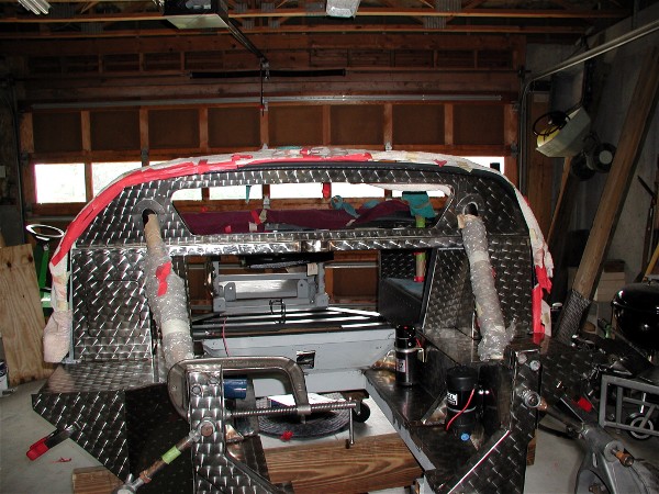

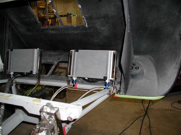

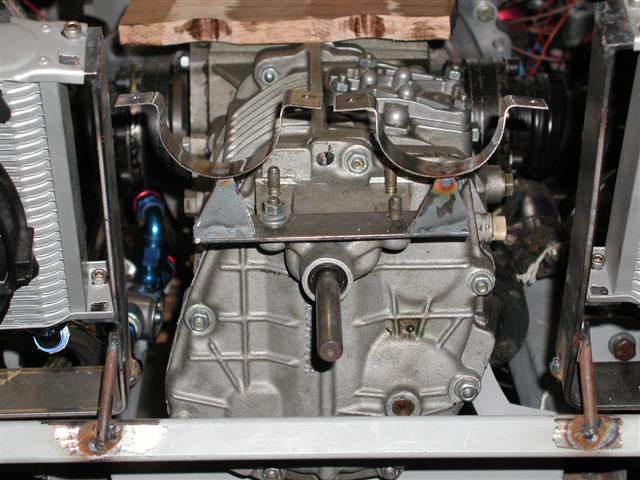

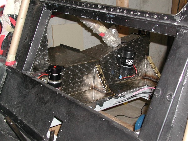

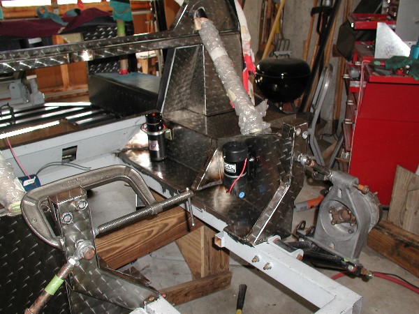

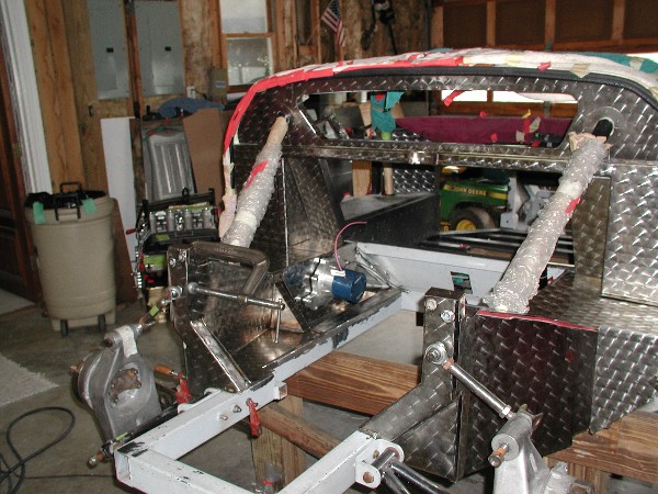

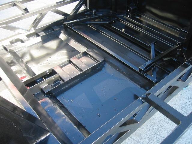

I also needed some space for all the goodies to be added. The sloped face of the engine bay was too tight so I came up with the idea of making a shelf for the pumps, coils, and oils lines. I also removed the engine mounts and temporarily moved them about 4 inches forward for better balance. Their final placement will be with enough room for the engine to squeeze up next to the firewall. With the engine so far forward, the electric water pump had to be moved, as it sat next to you in the cabin.
