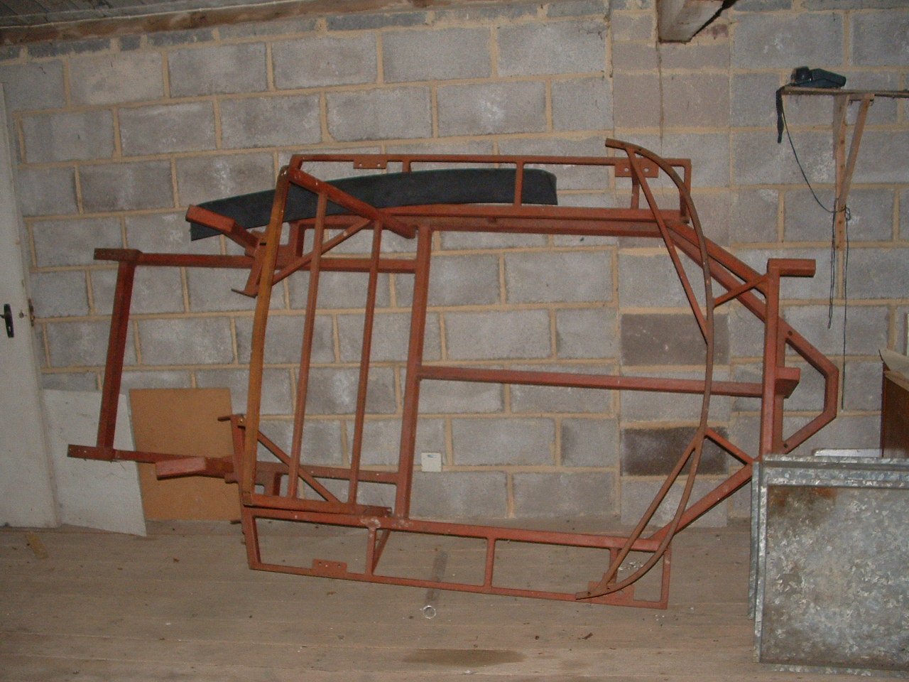

First picture of the found chassie.

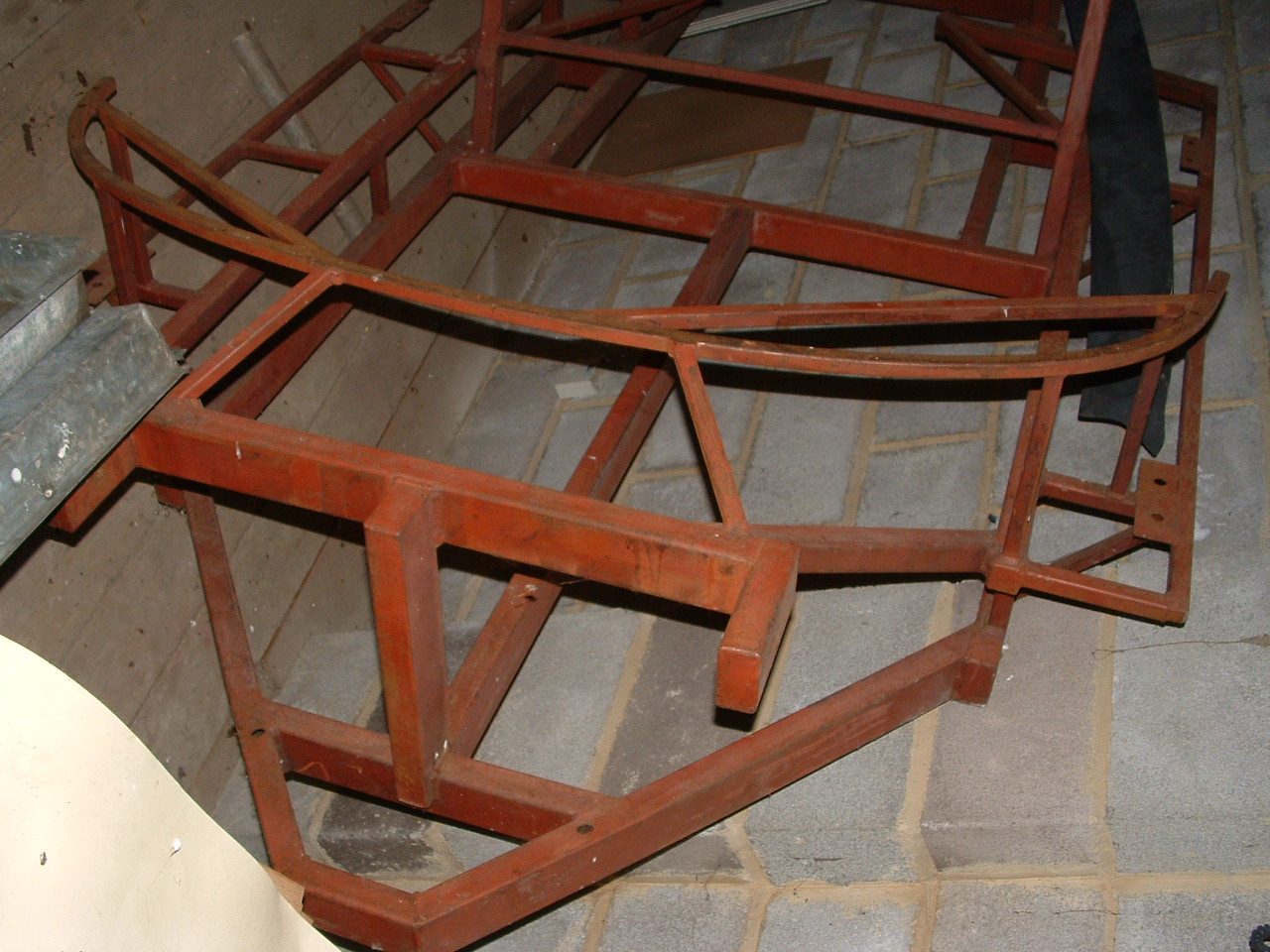

Another of the chassie....

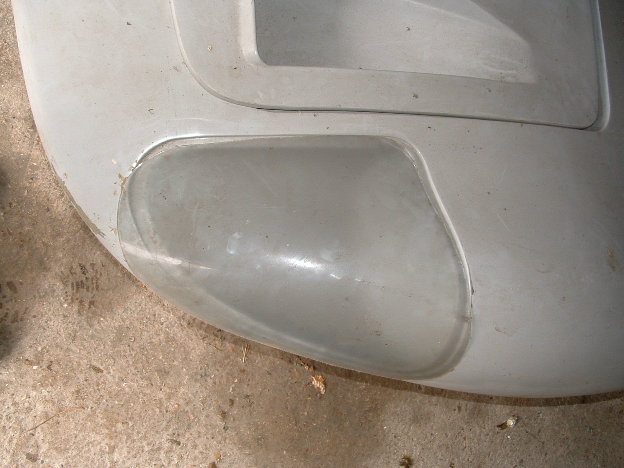

The headlight cowl....

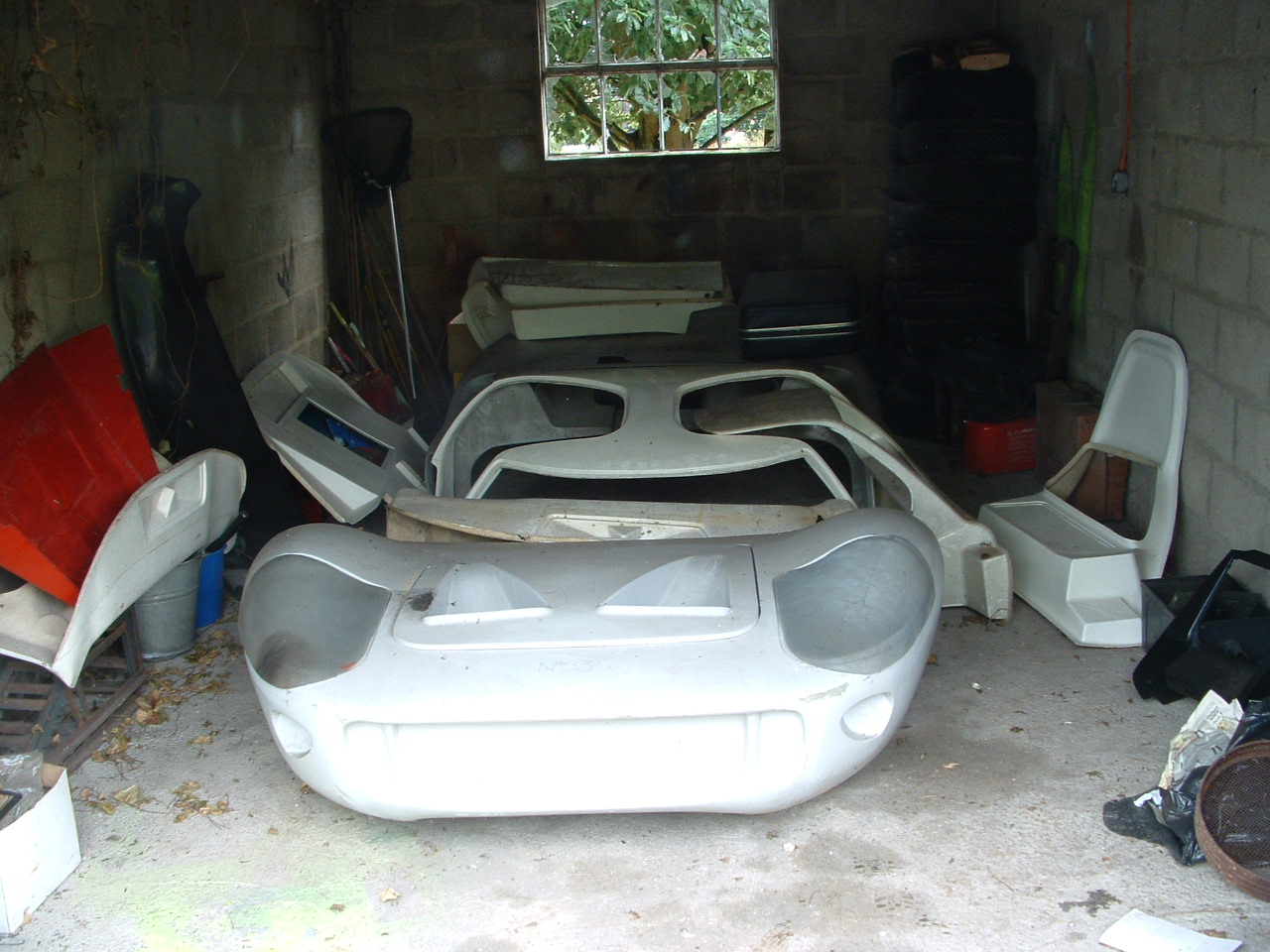

The bits in the shed.....

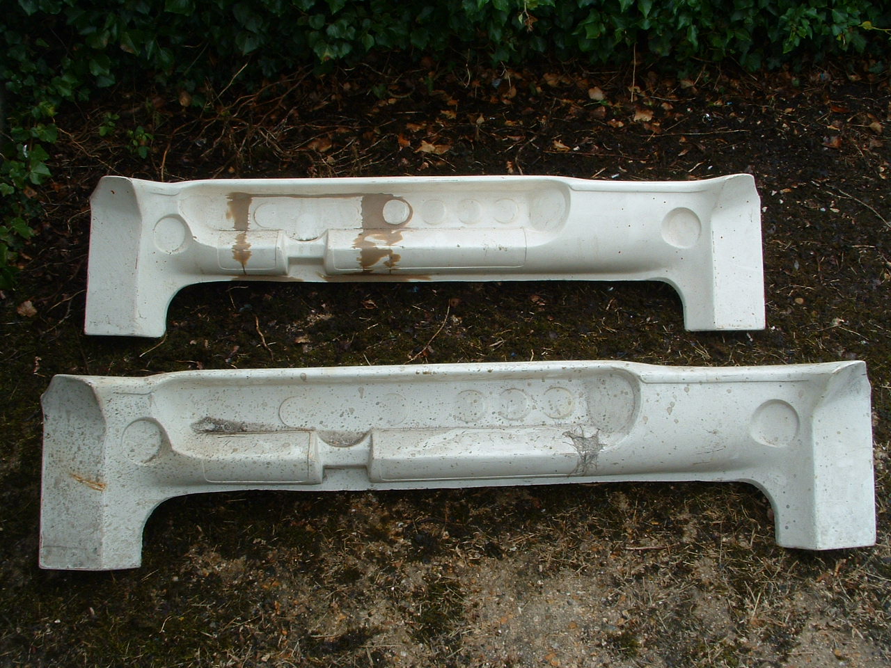

I picked up all the smaller fibre glass parts today and brought those home. I have three set of dashes, one right hooker the other two left. There are also two extra inner door skins, but I can't see any sign of the sills! If you have any idea what I have got here let me know please! Also one of the dashes seems to have been made shorter in overall length for some reason???

KVA MK 111. Early chassis.
A great gift but a lot of work for you if you have limited experience.
Good luck....

There are no supply problems for any parts to complete this "project" but your biggest headache will be with the front and rear suspension. As i said in my earlier reply, this is an early chassis, and should have been humanely put down by the vet !!!!
Basically you will need to cut the front and rear off and replace with a proper wishboned and coilover set up. Not difficult but messy and costly. My advice would be to forget about that chassis and buy a replacement unless of course you are an engineer and want hassle.......
