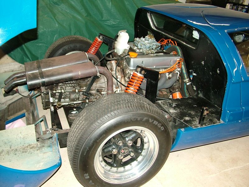

P:S Have attached pic of rear of KVA A1 chassis(not mine)
