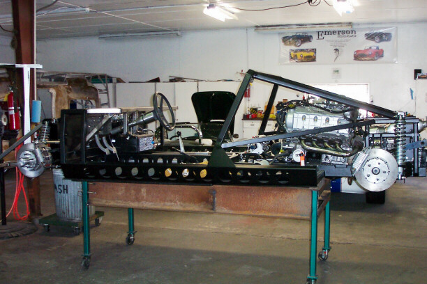

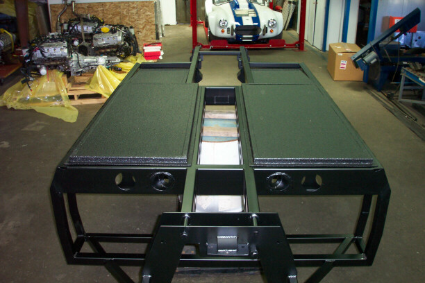

Honnycomb panels. This will hold 4800 pounds where the driver sits

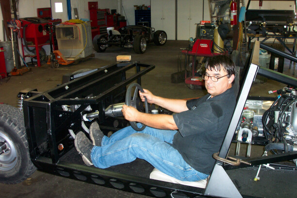

Re: Progres of the giant
foot room 11EEW

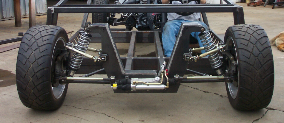

custom power for neutral geometry. We had to have a custom rack because the car is larger and we wonted it to have a short turning radius . And a power rack and still be under two turns lock to lock. and with a 19X11" front tire you got to have power.

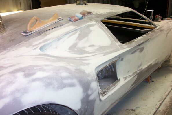

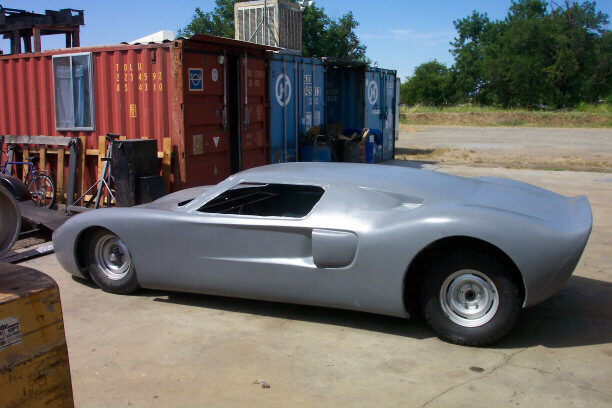

We keep cutting. Took a wedge starting at the rear wheel to the front wheel. And 1" out of the nose

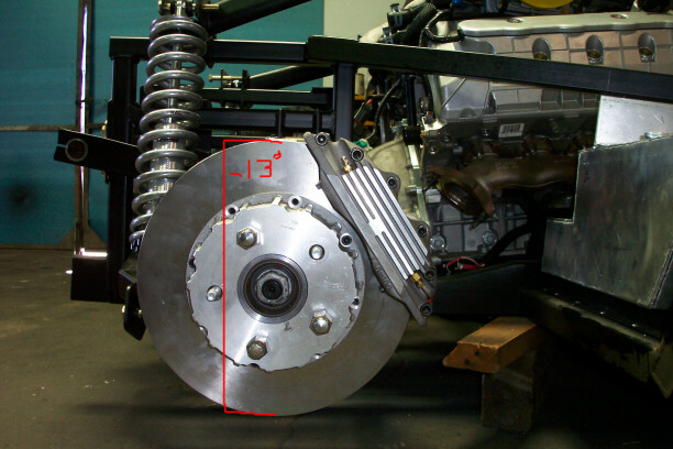

Dave Allen of McKenzies spent a few days with us and showed us how to properly set up an axle. This is a bigger setup than is in the Saleen that he also builds.

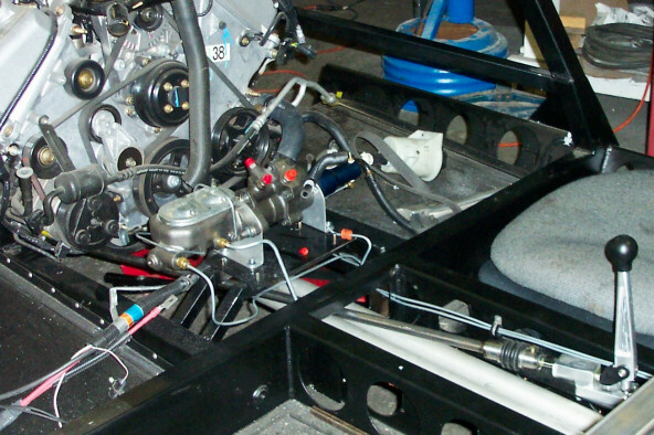

a hydra boost 25,000 psi

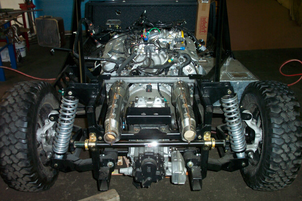

The motter shrunk

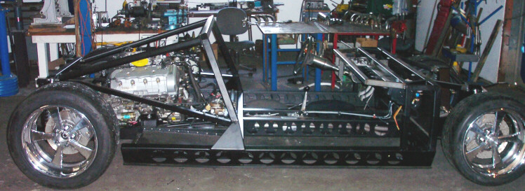

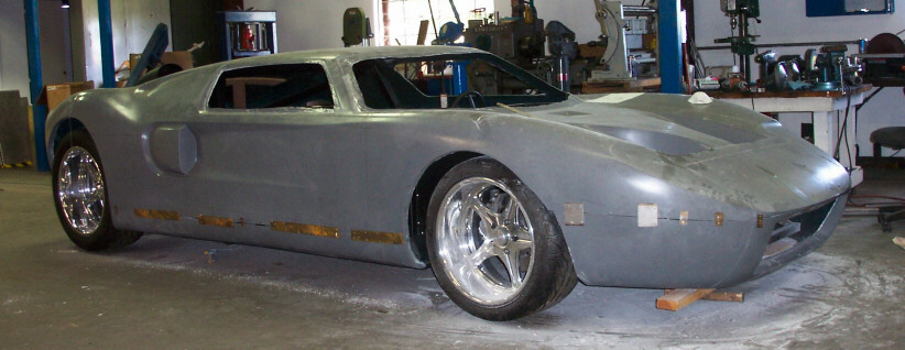

Drive train is complete and a custom set of wheels wiring and plumbing and it will be a runner

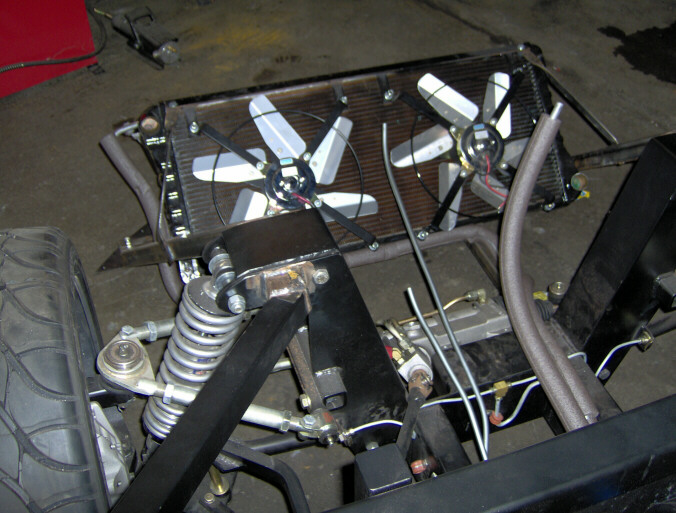

The fans above are 2950 CFM each and draw nine amps each they are 16". the radiator is 38"x 20" the condenser is 19"x 36"
