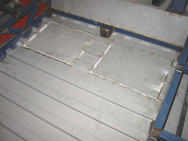

If you need the dimension of the dropped floor or need some pics
of it let me know. When I set my steering column up I made the
bracket to move the column forward a heap. I found that my wife could
reach the pedals with the seat hard up against cab wall. So all is well.
I fit well too. I'm 6 foot so I'm pleased. Fitted seats today(just have to get them trimmed now) and the Wilwood clutch and brake pedals today.

Hi Dave, It looks like you have the whole seating / driving position sorted out very nicely - much easier to do early on than at the end !
Thanks for the offer re the dropped floor. I have a pretty good idea of your setup from one of your early pics taken just after powder-coating. I also got some pics quite a while ago from PR - it looks like you have a newer version that actually drops the floor even lower than the original version which just lined up with the lower sections of the folded floor (see pic).
The other interesting change I noticed was that the inner seat belt bracket is no a lot longer than the original - excellent move, as the old version was too far back to be comfortable.
Any ideas on how to bolt the seats in (I was planning on putting a length of 2-3mm steel bar under the floor to spread the load, & welding some "runners" on each side of the exposed nuts/bolts to provide some protection against "running aground" on some damn speed hump ! (Beats mangling the seat bolts) !
