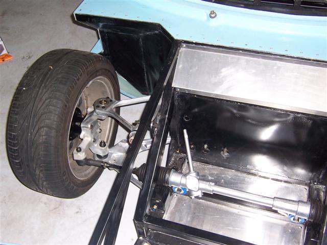

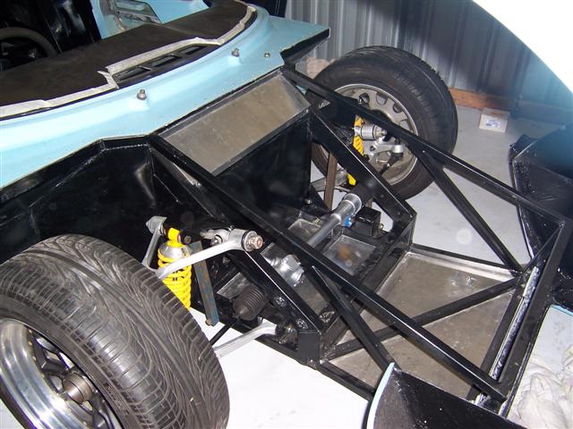

Thanks for the compliments Guys, It really does make a difference.
Well today I got the front arms cleaned and pressed in new poly bushes.
Also fitted a new set of balljoints from Ecklers aswell. Re- threaded the
steering rack and fitted it. Almost got the lower shock mounts finished
and I am going to make new upper shocks mounts, More like the old style
DRB items welded to the chassis.

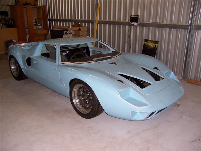

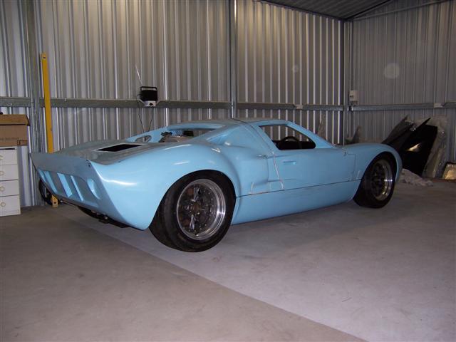

Anyway here is todays progress, I finally got the car on it's wheels
and rolled back and forth. I am just building a rego special at the moment and
it does get me down sometimes as you basically have to build 2 cars.

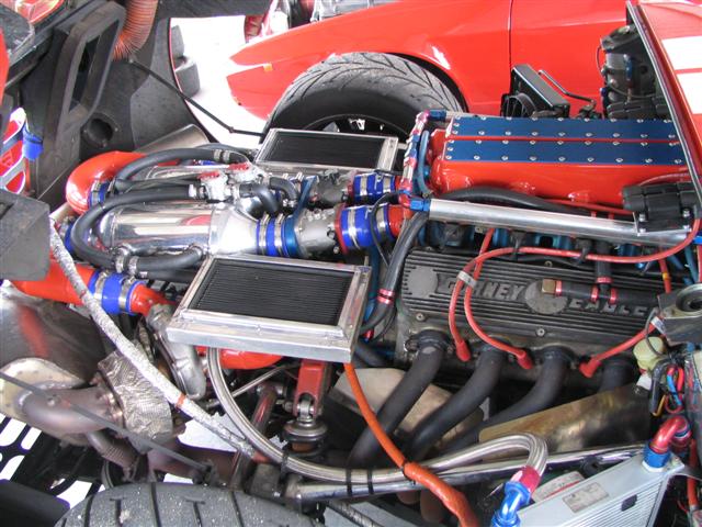

Craig here's a pic of Cossi's turbo GT40. I've seen it at Wanneroo a few times.

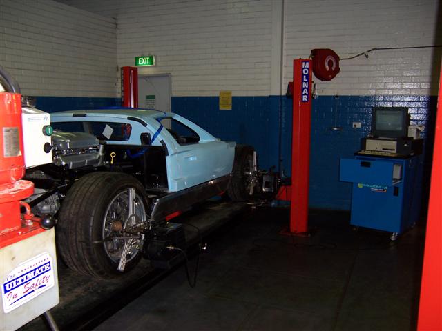

Well I hit the wheel aligner at work today and found that the DRB GT40 is
a very well set up car that only required marginal changes to get the wheel
alignment correct. With 0.02 minutes of geometrical driving axis (thrust)
the car should drive as straight as they get and shows that DRB has a very
square jig they build their cars on.
My intial settings to start from are the following
FRONT
Spring rate 200 pounds per inch
Camber 2.2 degrees negative
Caster 4.3 degrees positve
Toe total 1mm toe in
REAR
Spring rate 350 pounds per inch
Camber 1 degree negative
Caster 3.5 degrees positive
Geometrical driving axis 0.02 degrees positive
Setback front .01 degrees /rear 0.03 degrees.
Kingpin inclination +28.01 degrees
I'm hoping the car will have enough caster so the steering wheel will
self centre ok. I have also graphed the bumpsteer patterns for front and
rear over the full suspension travel. Looking forward to driving this beast.

Dave, mine drives fantastic. Well been a while since I've driven it. They all seem to drive exceptionally well.
My settings
FRONT
Spring rate 180 pounds per inch ??? (I'll have to check, got it written down somewhere)
LH Camber 1.22 degrees negative
RH Camber 1.30 degrees negative
LH Caster 4.00 degrees positve
RH Caster 3.40 degrees positve
Toe total 2.2mm toe in
REAR
Spring rate 300 pounds per inch ??? (I'll have to check, got it written down somewhere)
LH Camber 1.03 degree negative
LH Camber 1.01 degree negative
Toe total 3mm toe in
Mine runs very light springs, like all the early cars did, for road comfort. I want to drop mine a little lower, so will have to put some shorter/heavier springs in. One of the club members just put in 342lb(F) & 457lb(R) in his DRB GT40. It gets regular track use. I won't be going that heavy, although he said he is still happy with comfort on the road.
Code:
Corner weights(no driver):
            43.1%
       20.1% ! 22.8%
       231kg ! 261kg
49.6% -------+------- 50.3%
       338kg ! 313kg
       29.4% ! 27.4%
           56.9%
1148kg total
