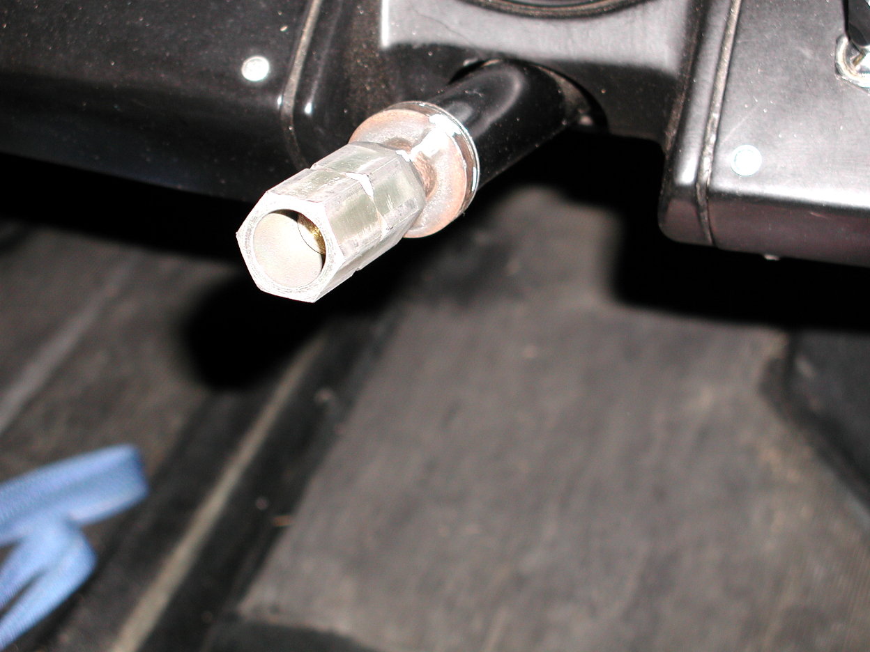

An option to consider if I haven't said this to you before. If you are trimming the dash to fit down over the steering column, how about trimming the dash to allow the steering column to be raised into the dash. This will give more room below by means of a higher steering wheel position. I raised mine by 20mm this way. The GTD column is adjustable fore and aft as well as up and down so no metal work required. I found better steering wheel leverage resulted.

Sort of like in this pic I have or your dash... [img]/ubbthreads/images/graemlins/smile.gif[/img]Good idea Malcolm, thanks for the advice...

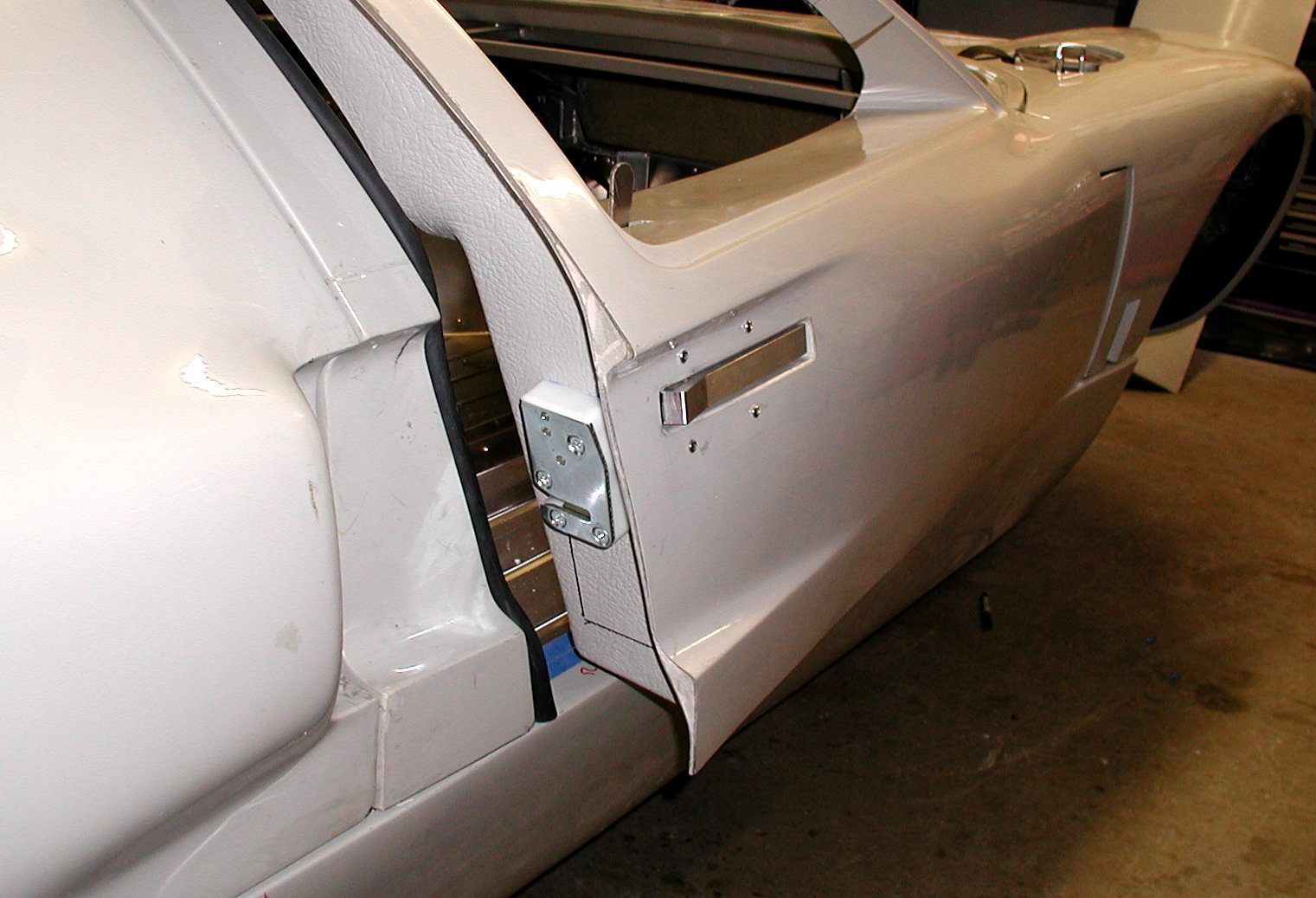

Work has been keeping me real busy as of late, but I did get to spend some time in the garage today. Started fitting door handles and latches. I have to admit, reaching deep into the door to fit up this hardware was a pain in the neck, but it is coming along. Not having any examples of how all of this hardware is supposed to fit together is a hindrance also. No catches on the chassis pillars yet, I have to wait until the body is adjusted correctly and the windshield has been check fit in place before I can do that.
Screws come out after bonding and the holes are filled in before paint.

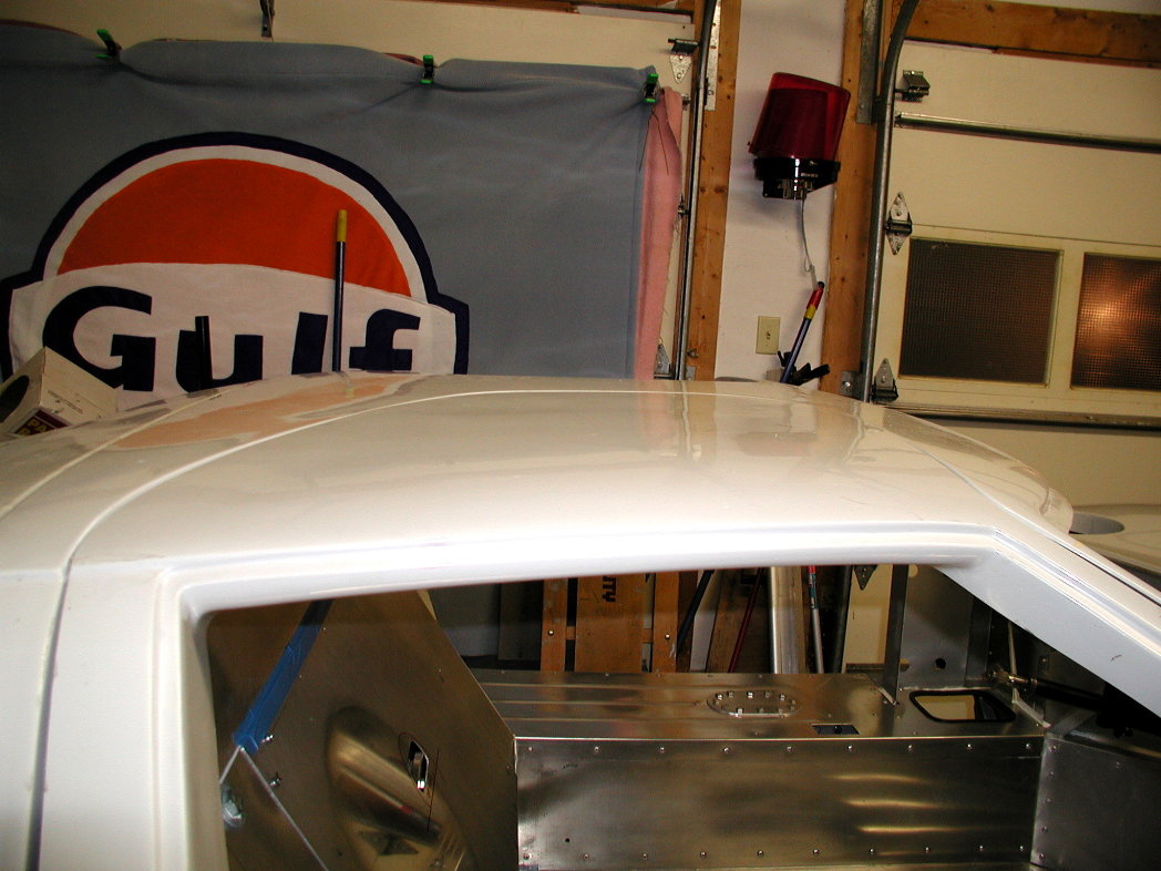

I set the spider according to the dimensions in the build manual and bolted in the right hand door. These are first pass results without any tinkering to adjust clearances. Door is level all around the roof to within a mm or so. Gaps will have to be tuned a bit.If I can get this fit on the opposite side, which will need some tinkering, and the windshield fits, I'll be one happy camper. [img]/ubbthreads/images/graemlins/smile.gif[/img]
John, keep an eye out for New England GT40 guy happenings and come meet with us the next time we get togther to bench race and burn meat on someone's grill.

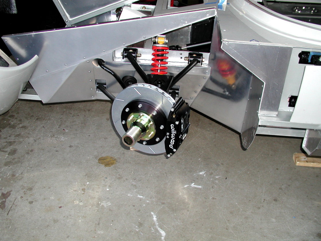

A few packages arrived last night.Front brakes have arrived. When I was having these designed I requested capacity for 5 screaming hot laps at Lime Rock.........
Brian

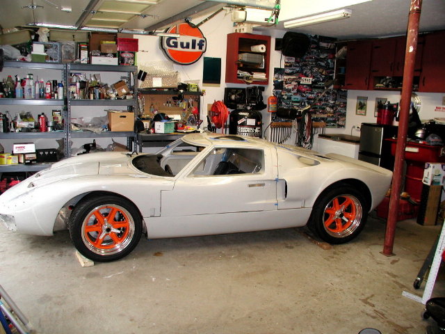

Mark Worthington is just around the corner and seeing his recent progress has fed the fires so to say. So after my suspension components came back from the brake guys, I put everything together and dropped her from the stands to push her into the light of day..... ahhhhhhh, instant traffic jam in the street, I can't wait to stop for gas!
The wiring is pretty much in, so we can spin the motor, the coolant system is about 80% there, need to dress the front of the motor a bit. My replacement headers came from the UK and I now have plenty of clearance to make things fit. Fist pass for mufflers will be two Magnaflow cans, if it's too loud, I'll stuff some reversionary cones in.
Next is getting the glass to fit and then setting the body, may do some rough blocking out, but winter is approaching and it will be too cold for any chemicals pretty soon. The cold months will be spent running brake lines, fuel system, instruments, fire supression, getting seats covered, etc. Would like to have it ready for the road sans paint by the time the snow melts in the spring.

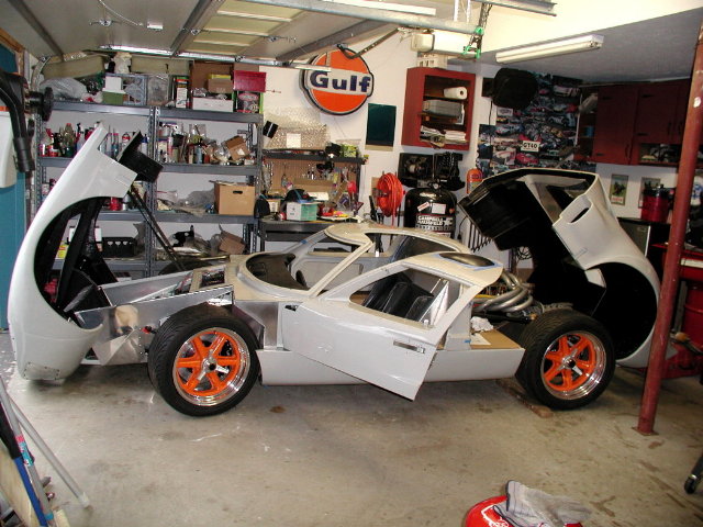

one more
