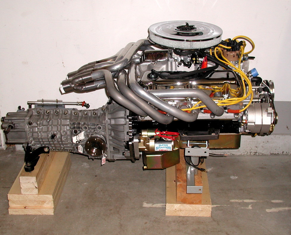

Time for some motivating. I shopped around a bit and ended up purchasing a completed engine from the Engine Factory guys. They were the only ones who would touch my flywheel and were great at what they did. The engine was assembled and test run before delivery and included a video of my engine running on their test set up. My engine spec is as follows
Complete Carbureted Engine 302 CI/373 HP
þ Blueprinted machined 302 Roller Block version,
þ Nodular Cast Iron Crankshaft
þ Federal Mogul 10:1 CR Hyperuetectic pistons
þ Heavy Duty double roller Dynagear Timing set
þ Comp Cams Hydraulic camshaft # 35-430-8 224 / 224 duration @ .050 .560 / .560 Lift
þ Comp Cams 1.6 to 1 Ratio Pro Magnum Roller Rocker Arms
þ Edelbrock RPM Aluminum fast burn cylinder heads with stainless 2.02 “ valves and hardened locks, chrome moly retainers and HD valve springs.
þ Melling high volume oil pump
þ Canton baffled road race pan
þ Edelbrock performer RPM dual Plane intake
þ Edelbrock 650 cfm 4 barrel AVS carb with electric choke
þ Short nose water pump
þ Small diameter Accel electronic Ignition
I'm not planning on dynoing the engine, if it makes half of what they advertise, it will be good enogh for me. I just want it to start and run without having to screw with it
Transaxle is a Mach I unit with some internal mods to tighten up shifting a bit, flywheel is a Roy Lane item from TechCraft and clutch is AP Racing, Frank Catt design throwout bearing, starter is a Tilton high output with an MDA adapter.
I realize that I am going to have to re-run the spark plug wires so that they do not cook and much to my dismay, the headers do not fit properly.

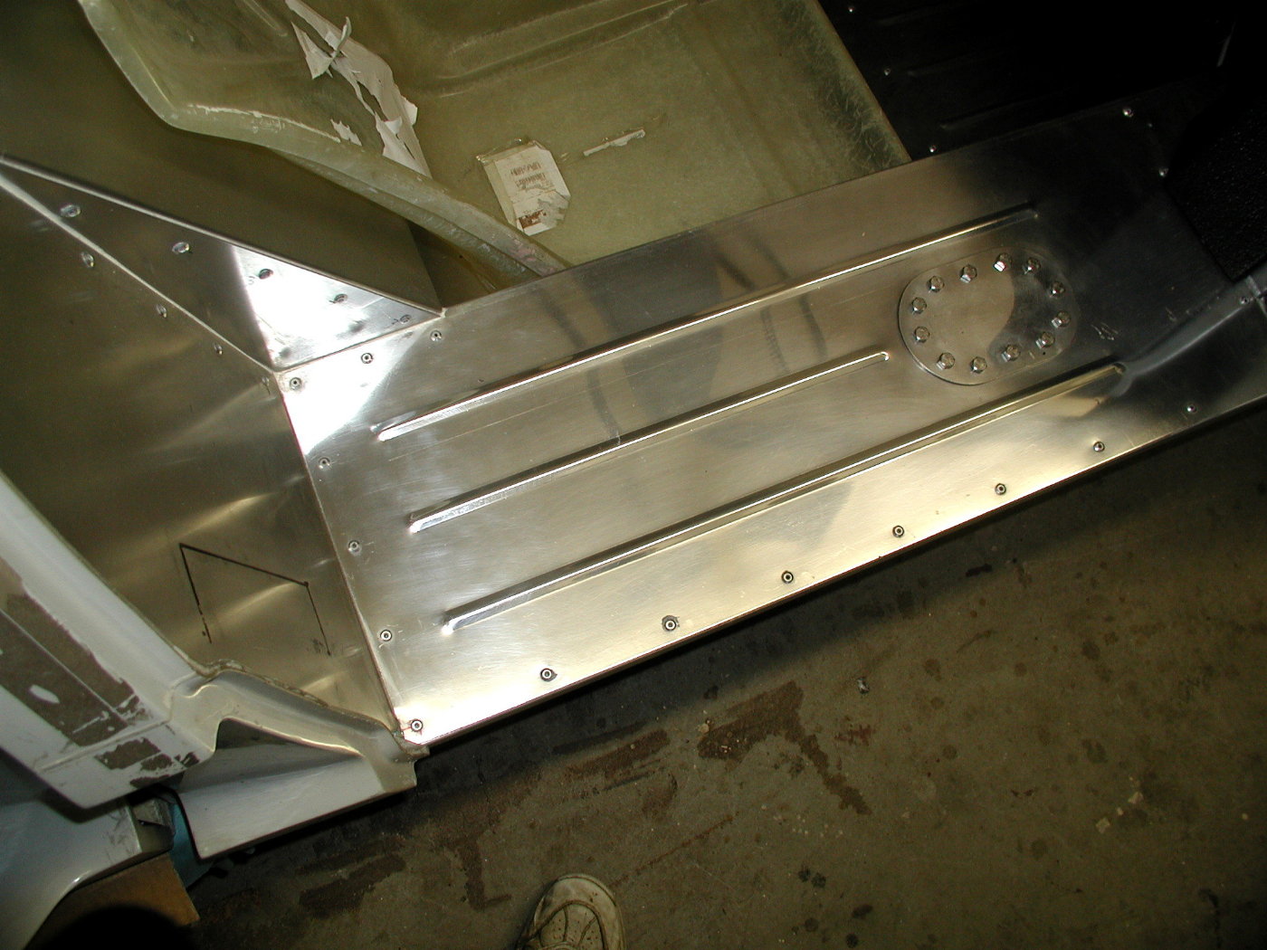

Here is a close-up shot of a sill. A few years ago my wife gave me a bead roller for Christmas that has several madrels for making different shapes. I found that between laying down accurate lines and using fences, we could accurately put beads into the sills and floors. However it is a very time consuming process, as this was all manually done, these three beads would have taken me an entire afternoon. All of the white goop seeping around the rivets and out of the seams is the 3M adhesive, it buffs off when briskly rubbed with a coarse acetone soaked rag. The 3M is very difficult to get off of anything it touches, including skin, as a consequence I was going through boxes and boxes of disposable gloves while using it.

Those beaded sill panels are a very nice touch, Brian. Maybe I can bring my removable rear bulkhead panel up to NH sometime and roll a few beads onto it to reduce its potential for drumming.
What's wrong with the exhaust? Do you have to source a new one or just a couple pipes? I think one of my pipes may interfere with my rear clip, but I won't be sure until I install the engine.
Nice job - you're making great progress.

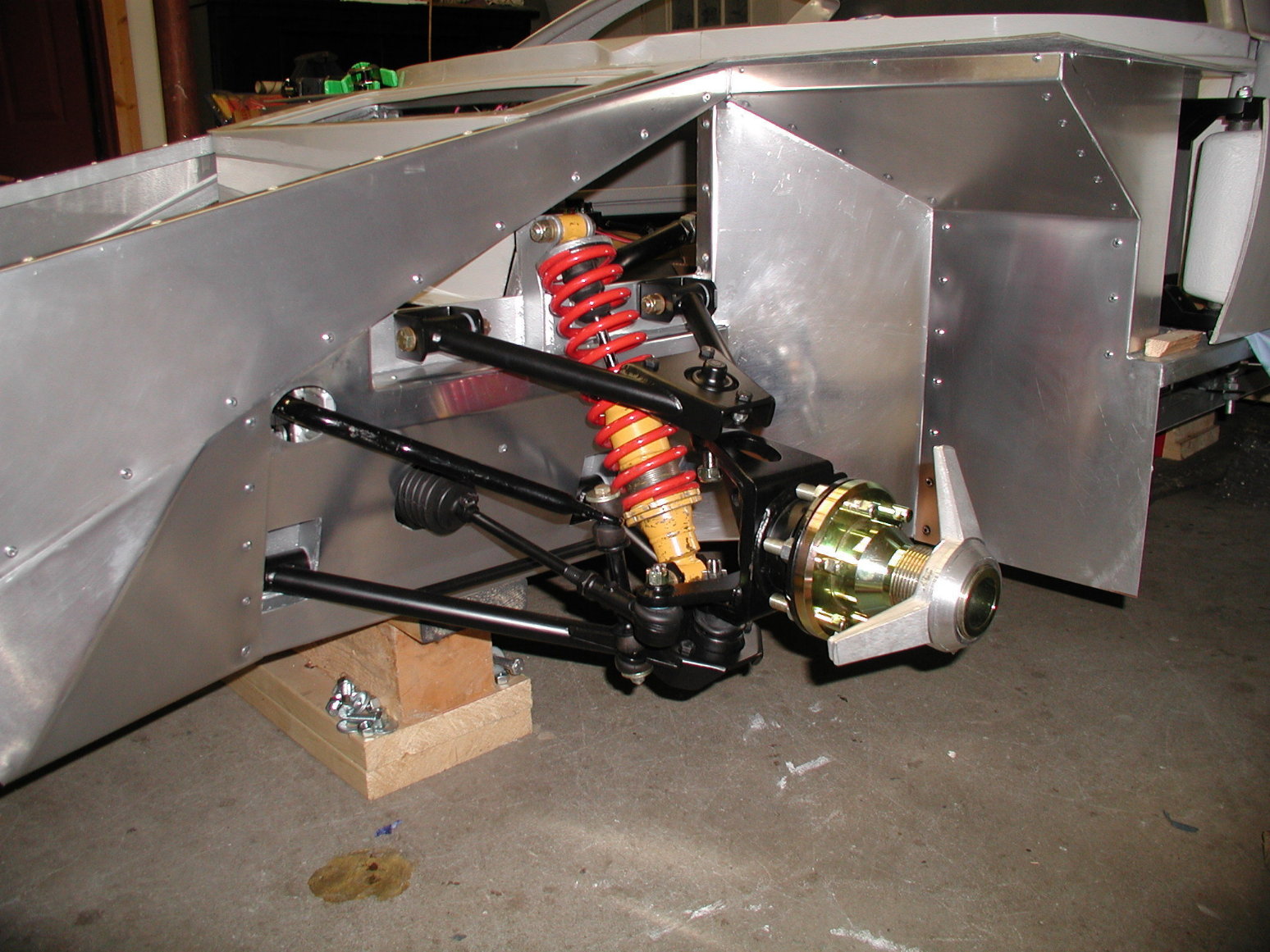

Front suspension. Standard GTD upper and lower "A" arms with rubber bushes knocked out and poly bushed fitted. AN fasteners from Pegasus holding it all together. These are Ray Christopher's big bearing uprights. I don't know what the stock item looks like but I took this one apart and these have some substantial bearings. Pin drive adapters are also Ray's items. Anti-roll bars are GTD heavy duty units, I'll swap the mounts and links out for poly items before we hit the road. Shocks and springs are stock GTD items, probably going to be the first thing to go when I do any upgrades, but I got these for a song and they'll do for now. Steering rack has been raised 7/16" to improve bump steer.
Seen in previous pics, the front wheels are 17 x 8 PS Engineering's "looks kind of like BRM" pattern. Tires are Yokohama 235-45/17 AVS 100s. Front brakes are in development.

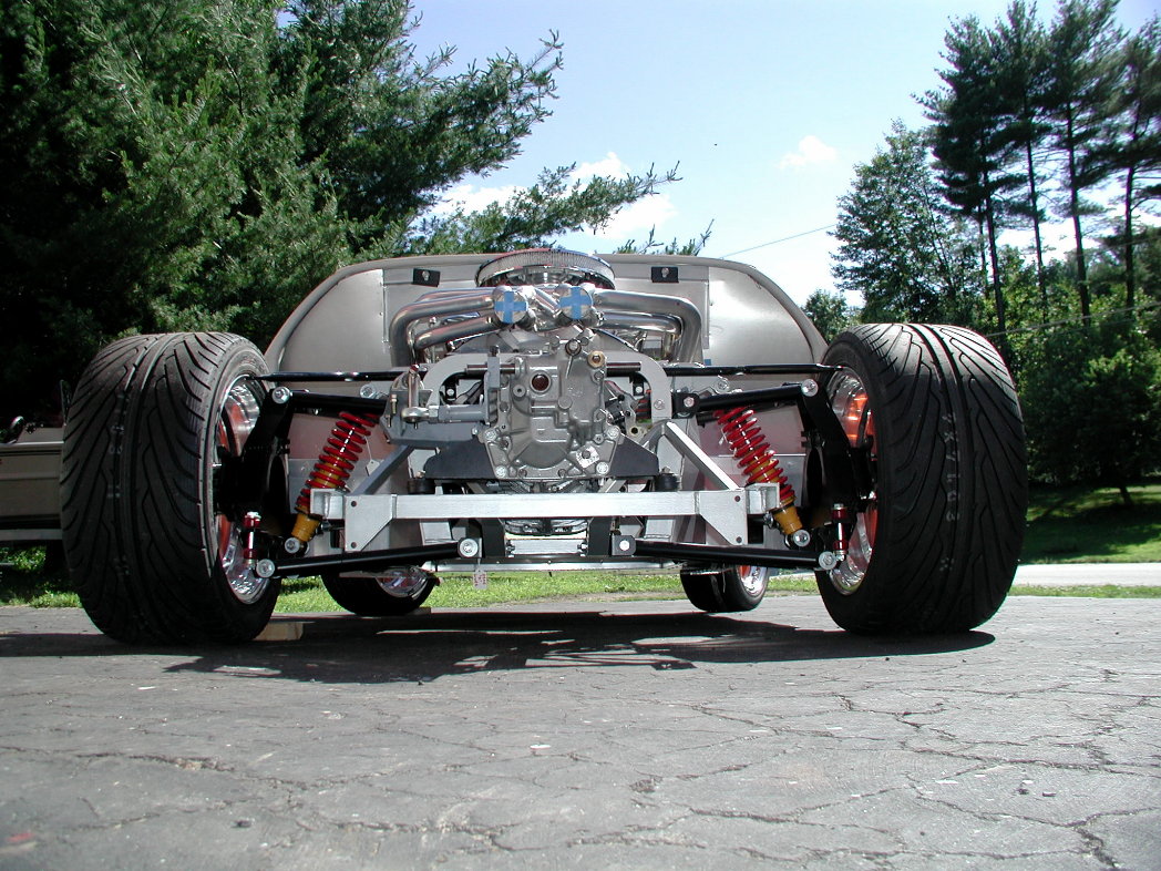

A little more build progress........
As my build is a non-standard one, I find that I have been putting things together and taking them apart in order to check clearances and adjust as necessary. This past summer after I had dry-assembled the chassis, I decided to fit the motor/transaxle combo in. I happened to have a set of Roy Smarts new motor mounts so I bolted them in and hoisted the motor in. Remarkably, I put the motor in single-handed from the rear of the car in a matter of about 15 minutes on the first try.

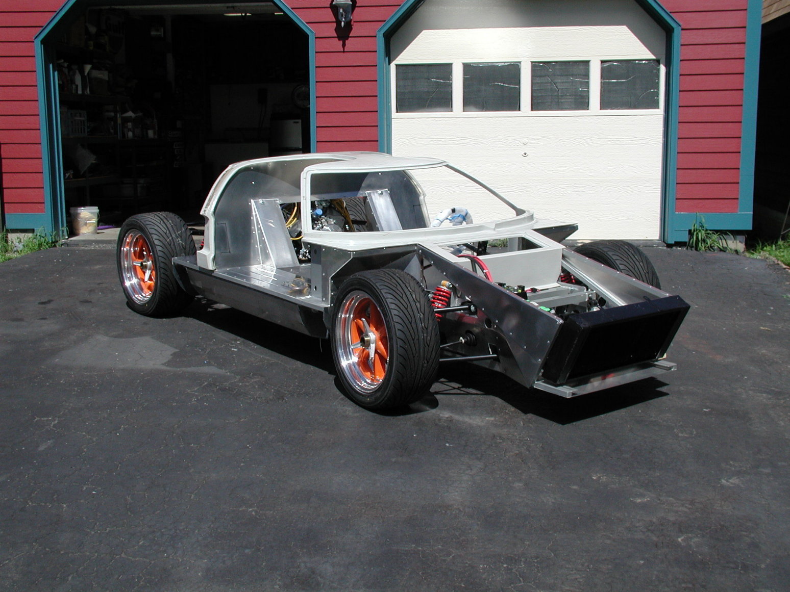

This rubber should be adequate to keep me on the road.

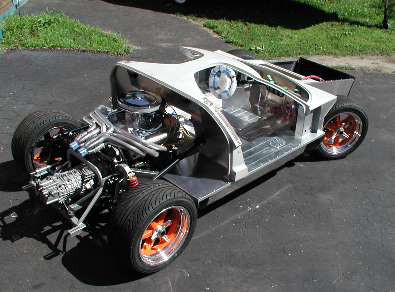

Hopefully the only perspective that the motor heads up here get.... [img]/ubbthreads/images/graemlins/cool.gif[/img]

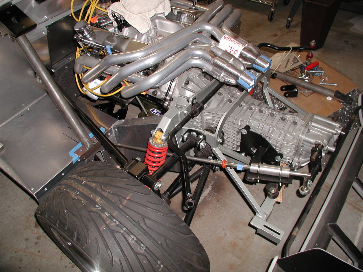

A few of Roy Smart's items are at work in this picture. Those being his;
- motor mounts which are nicely done and feature three mounting bolt holes to offer a range of engine heights.
- engine bay struts which prove additional strength to the roll hoop structure above the cabin.
- And finally his rod shifter set up which is adjustable in almost every way.
The struts are being mocked up here to ensure they tie properly into the chassis and allow proper movement of suspension arms.
