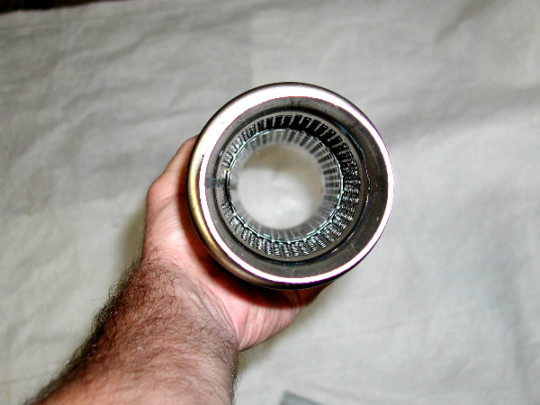

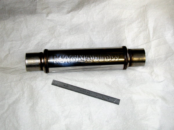

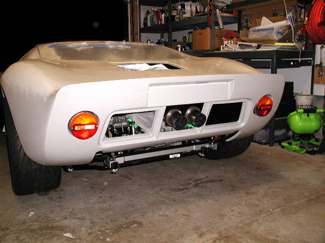

My mufflers came a few days ago. I am beginning to think they won't be offering much in the way of sound reduction, but we'll give em a go anyways.

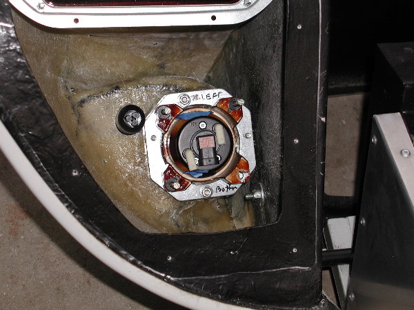

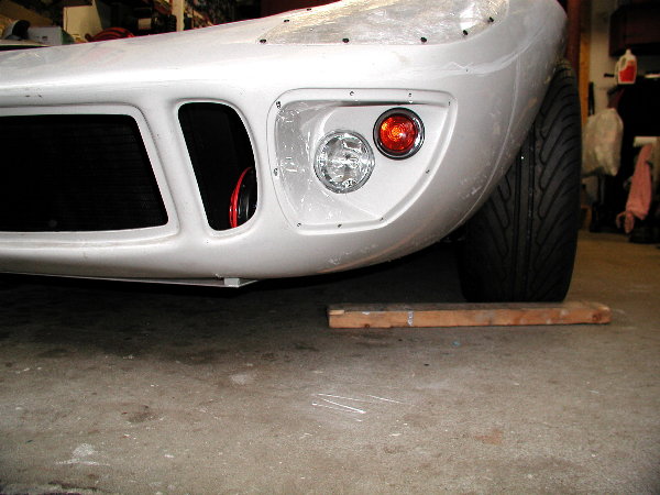

Installed my driving lights over the past week. The hole has to be cleaned up a bit, but you get the idea. These are Hella 90mm high beams and I glassed in the bucket on the backside, this allows easy adjustment with the three aiming screws, I'll slot the mount to level on a horizontal plane. This is a prototype set up and I may move them around a bit to adjust cosmetics.

Naw, that ain't gonna do much to make anything quiet!

I think you will be suprised just how much those mufflers quiet the car down. I have the 3 1/2" version on my Pantera with 180deg headers.

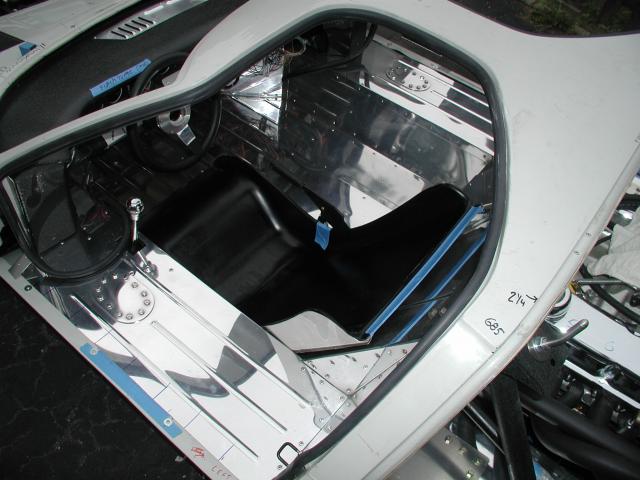

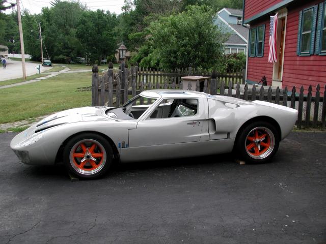

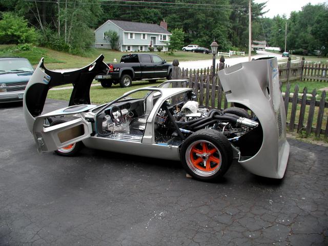

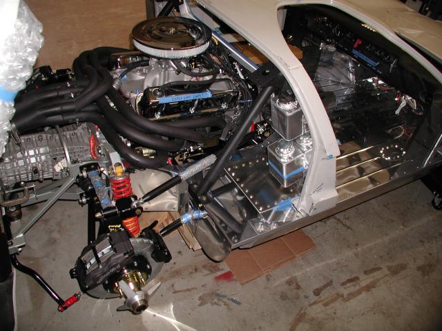

Well time and money issues had but the kabosh on the build for a while (like that's something new at my house). have not done much with respect to new parts, but I have tidied things up a bit. Now that I have a little more time available and some more nickles in the jar, we are getting back on with the build. A few pics for those of you following a GTD through the process. Considering the limited amount of resources I can apply to the build, it's going to hit the streets "bared boned" so to speak. I have a call in to the state police to come over and check it out so that it can be registered.
