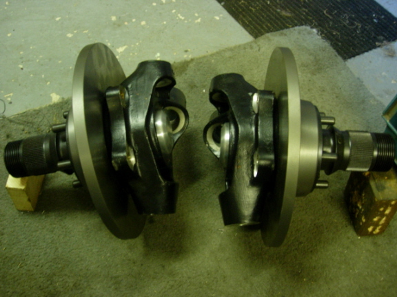

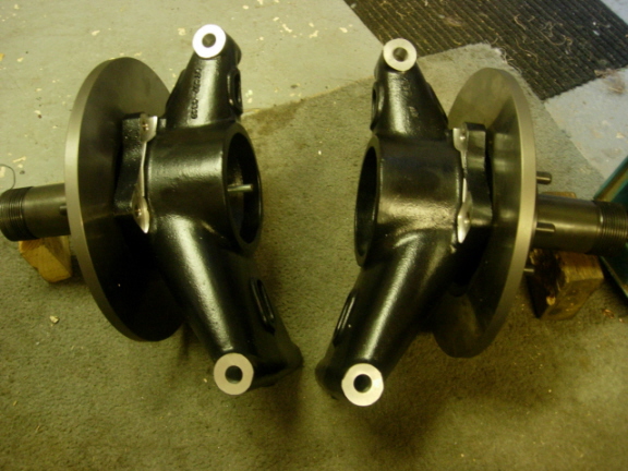

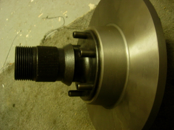

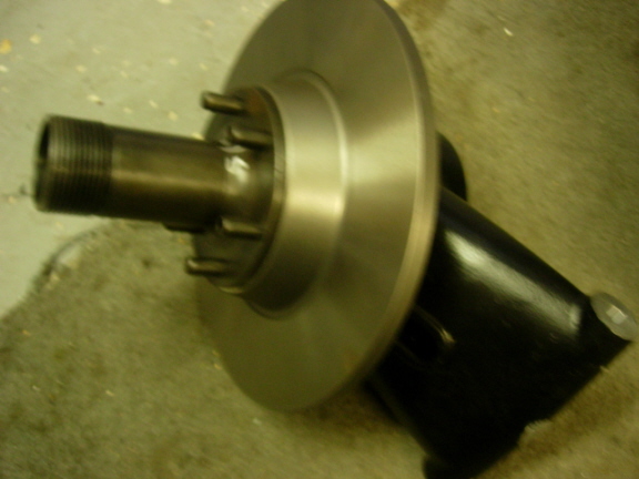

Front and rear uprights now assembled.

Rear uprights

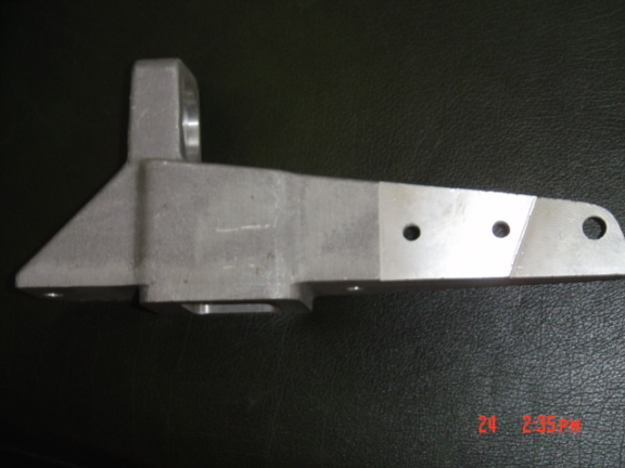

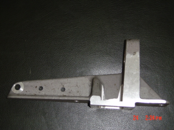

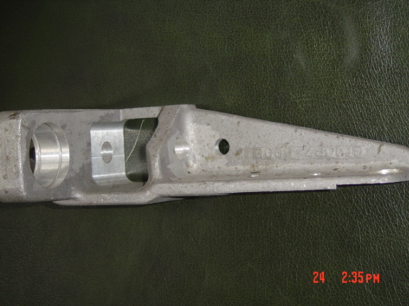

Gear shift housing casting.

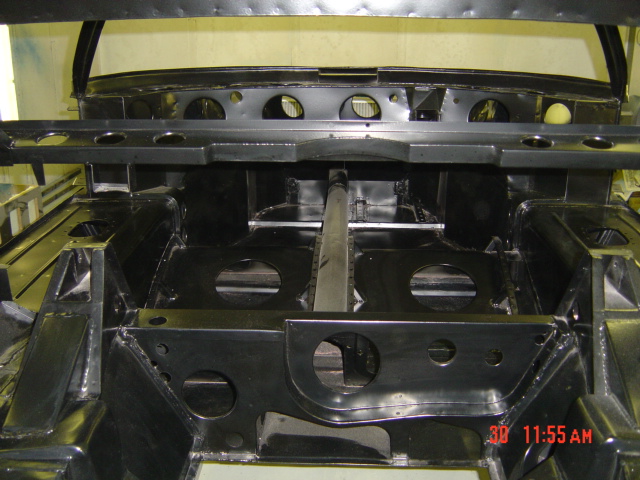

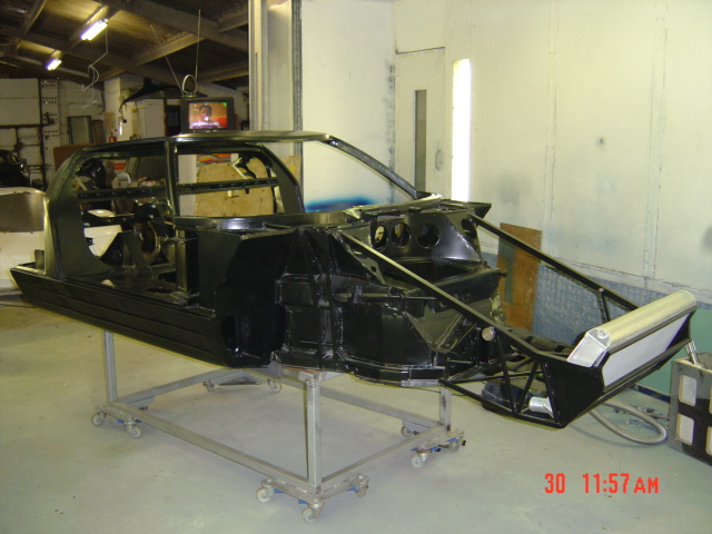

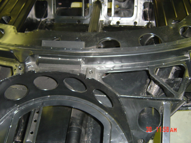

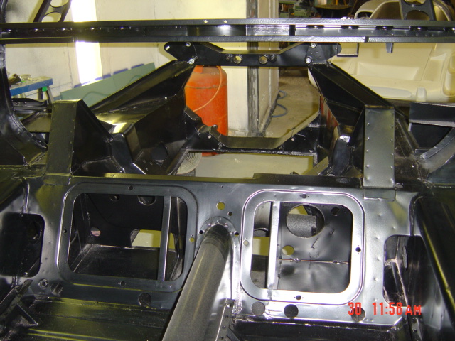

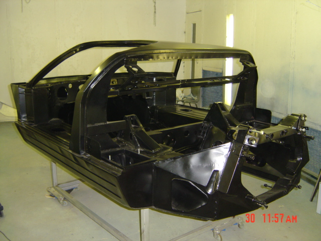

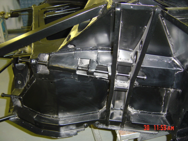

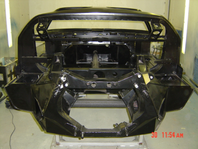

Hi Guys
well, here are a few more pic's of my monocoque.

Chris Melia is offline

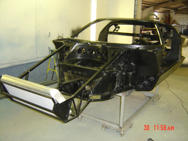

Re: Chris Melia's Mono "Raiders of the lost Arc"
and a few more

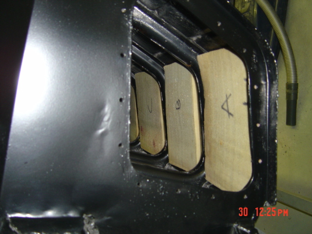

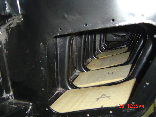

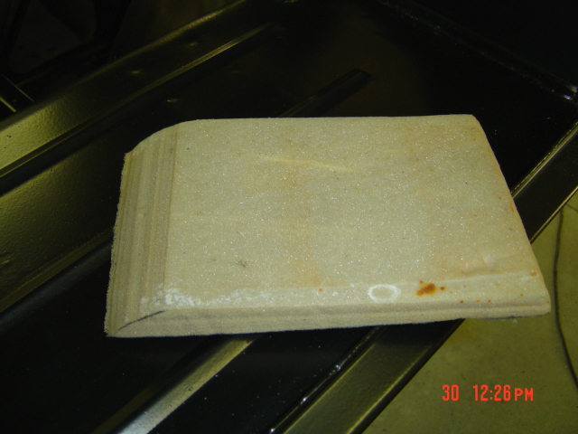

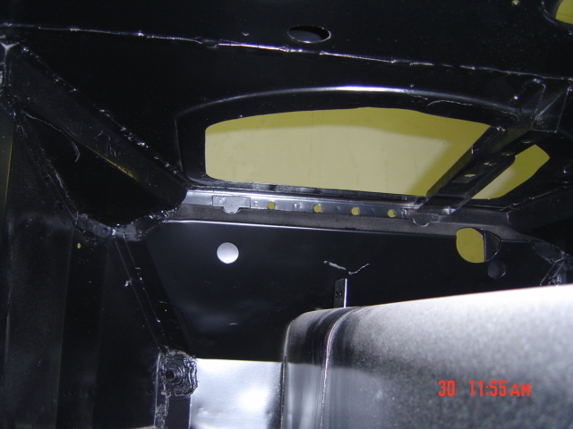

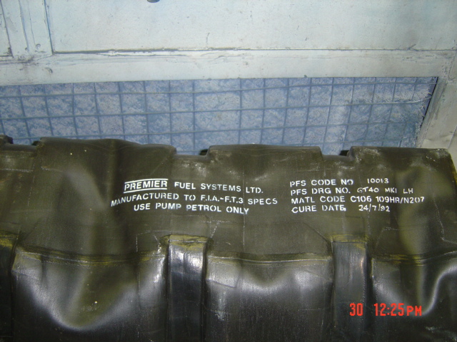

Today with the help of Andy Booth, we prepared the fuel sponsons ready to take the bag Tanks.
This meant that each space between the webs had to have a high density foam insert installed to give a flat base for the bag tank to sit on.
Also using tank tape we taped over all the seams and welds to prevent the tanks from chafing when installed.
Nice picture Chris.
Glad to see your progressing well.
I didn't realise the fuel cells had foam under them, or is this a concession to safety on your part ?
I bet those tanks are gonna be a bugger to feed through and get seated properly

Hi John
its not a safety issue, if you look at the bottom of the bag tank in the photo you will see its flat, its only the sides and the top that are recessed for the ribs. The tanks have to be flat at the bottom to allow the fuel to flow fully out.
regards

Ahh, yes that makes sense, thanks.
