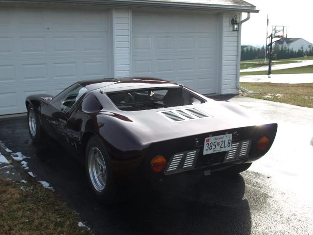

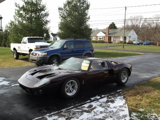

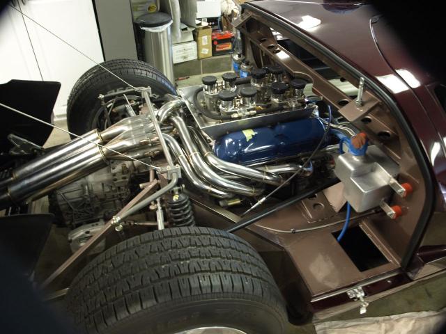

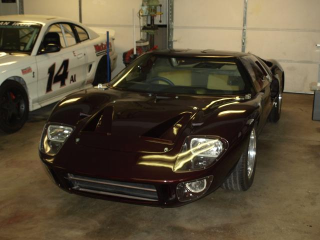

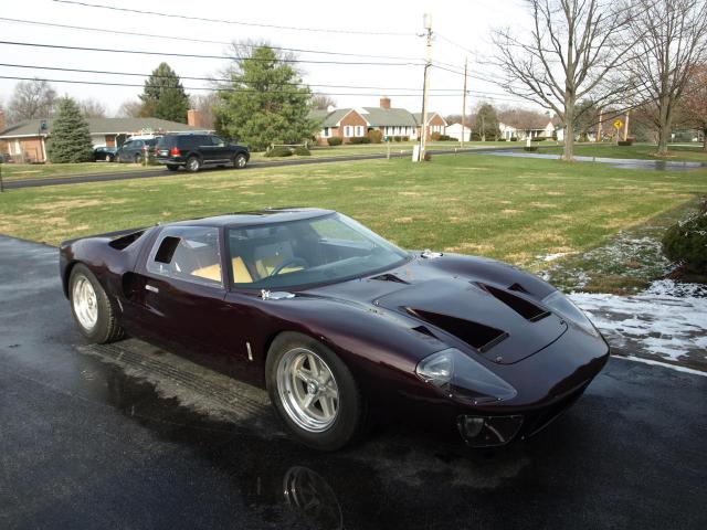

Re: 1149 Mono Replica
A few photos from today. Notice the plush seats
An old photo got in there by mistake, but it does serve to illustrate how far we've come.

I forgot to add.... if you look at the photos in the post up above, and compare the two engine shots, the pipes have begun to turn color. Kind of a nice gold. Hope they styay that way. Also note the exhaust silencer shield, another piece of lovely work by John Shriver's shop... the guy who hates the word "perfect"...but comes very close to it in his work.
