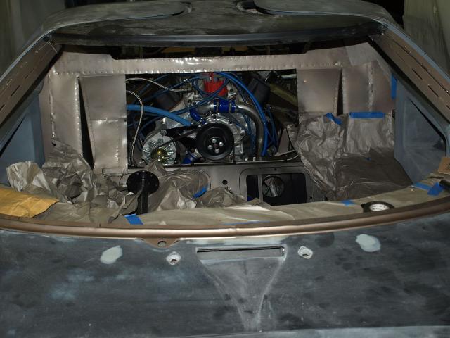

Re: 1149 Mono Replica
all the wrong photos, I'll try again

Mark I monocoque, completed
Safir Mk I body
ZF-2 transaxle
302 w/Webers

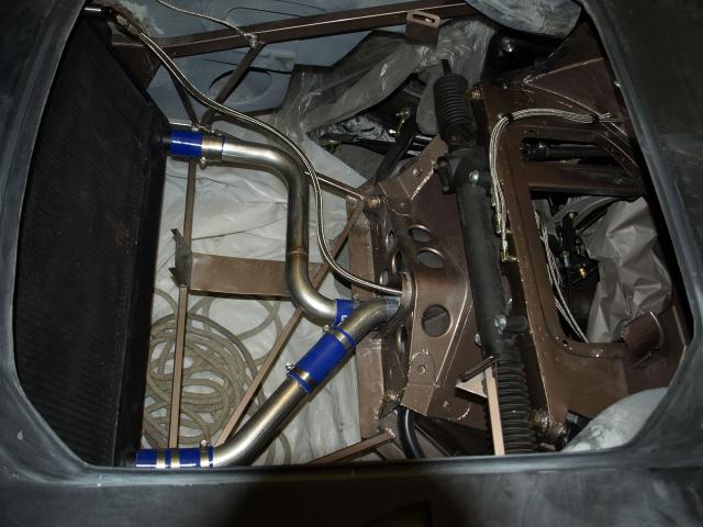

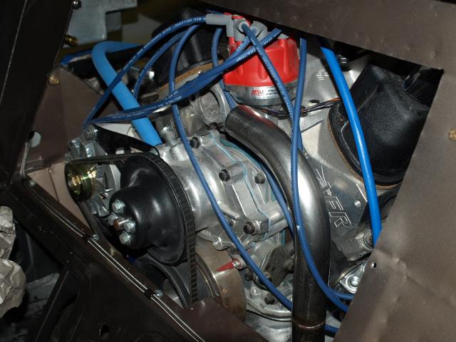

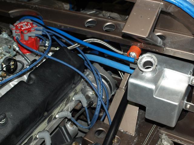

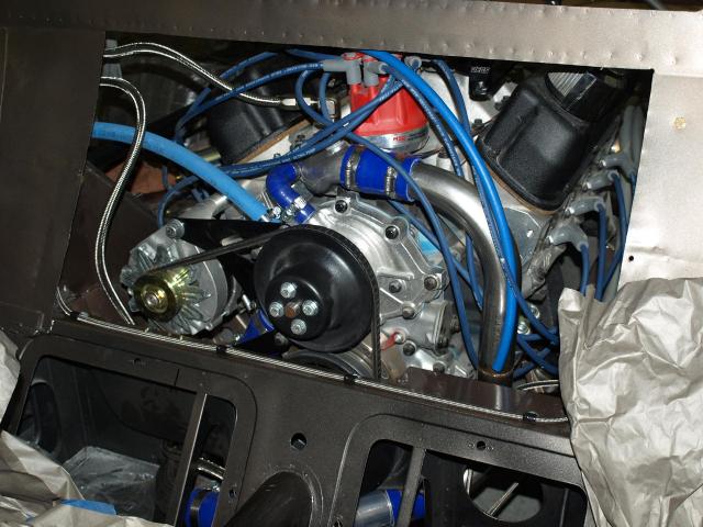

Trying again; these are some photos of the coolant lines in, the tank in, and the thermostat housing in, which of course has to come out so we can redrill and tap it and install the sensor for the cooling fans. I don't know whether my prior post survived (only the wrong photos did, I think) but I had a frame made up for the cooling fans which will mount them and bolt into the front of the chassis behind the radiator. THEN we can begin fitting the nose panel and the front bodywork and make sure nothing interferes with anything else.
