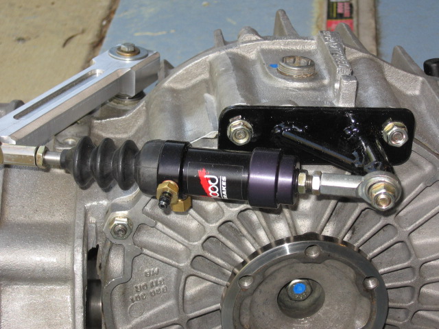

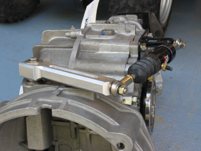

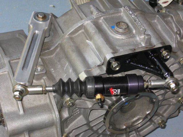

I’ve recently received my 930 box back from Gbox. Gboxweb.com specializes in Porsche boxes and their vendor representative on GT40s.com, Ryan Zielinski, is a frequent poster on the site.
The main reason I sent it to Gbox was for a robust slave cylinder conversion. But, while it was there they disassembled the box completely, inspected it, replaced a few bits, and gave it a clean bill of health. This particular box has the rare 8:41 R&P, or 5.12 ratio, that is highly desirable for a racing standpoint. I was impressed with Gbox’s service on my 930 as the box came with a full report of the inspection and procedures performed. The box ended up to be in good shape with some wear on the 2/3 synchros, so, they were replaced when they were in there.
Gbox also rebuilt my buddy Ed's 915 box, in fact, both went to and from Gbox at the same time. Ed’s 911S box needed a complete rebuild from about 100k miles of hard street use and Gbox performed that service as well. Man is that box small compared to a 930, but looking good now1
The slave cylinder conversion is shown below in the pictures and is a nice piece. It has a billet arm and a pull slave arrangement mounted on heim joints along with a reinforced anchor point. Looks like it’ll do the job and I think Gbox will be offering this as a kit since it requires no real machine work to the box itself. Thanks for the work Ryan, quite impressive!
