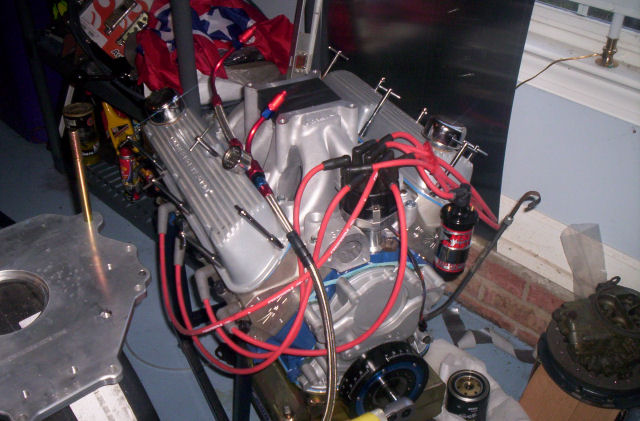

Got my camera back and here are a few pictures of garage happenings. I'm buttoning up the motor with a new front over that I got from John B of all people in a nice transaction. Going mechanical pump so the new style cover, reverse rotation pump, and damper are all for sale. Funnelweb intake installed, billet MSD, expoy coil, etc - engine specs elsewhere.

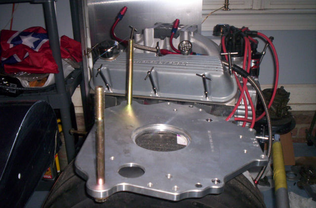

The RCR adapter is a cool piece that is more than a transaxle/engine adapter, it also functions as a motor plate. Those long bolt tie into the chassis, and, there are two holes up top of that plate that tie into the chassis. Definitely will prevent pitch movement of the combination, as well as rotation around the crank axis. Made of aluminum for lightness and is still strong.

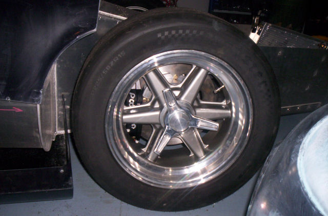

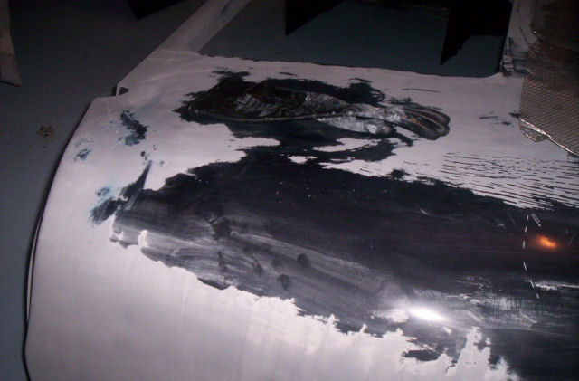

Tranny is located in my under house storage and is awaiting the dang Kennedy flywheel to finish all that up. Some more pictures too - the last remaining primer to remove - don't EVER spray your body with spray bomb primer! All the other parts are cleaned and cut for holes - brake ducts, lights, rear cut outs, etc. Still need to do sanding and shaping, but that is coming along.

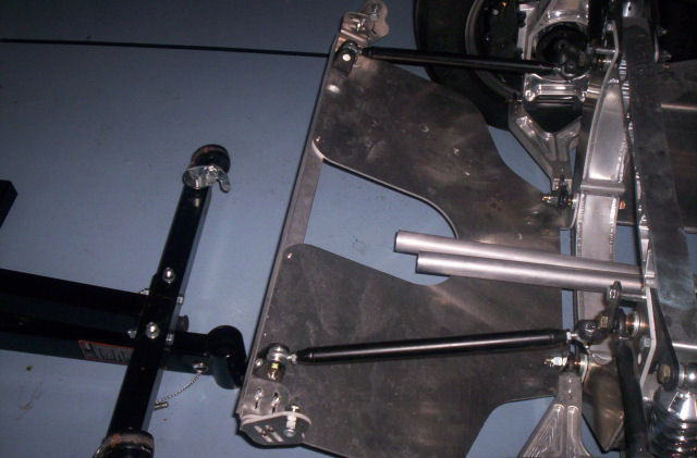

Fran managed to fit the car with a rear tray which is cool, that was not planned but worked out. The rear tray holds the clip and is adjustable with those drag bars and heim joints. I imagine we can make some sort of under tray diffuser out of it if we've a mind too. Front 15" BRM from RCR shod with Hoosier DOT race tire and 6 pot caliper there too.
ID:	14537  Click image for larger version
ID:	14538  Click image for larger version
ID:	14539  Click image for larger version
ID:	14540  Click image for larger version

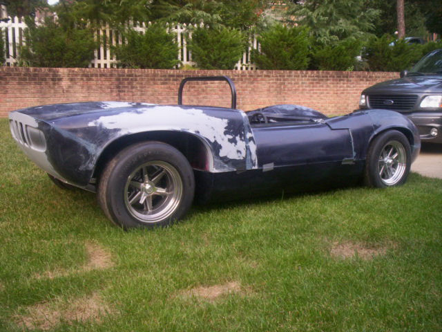

It's looking good Ron, sorry to say this but I laughed when I saw the primer pic, an old saying came to mind "look before you leap" that must have been a crap job removing the primer, it goes on nice and easy but a bugger to remove.

That adapter plate is cool. Looking good, Ron.

No joke on looking before you leap - that was a crappy job. About 3 hours to put it all on well, and, about 12 to get it off. The adapter plate/motor plate idea used is a good one and is one of the best I've seen for engine/transaxle location and mounting, as well as the rear tray. Those silly valve cover tees have to go though!
