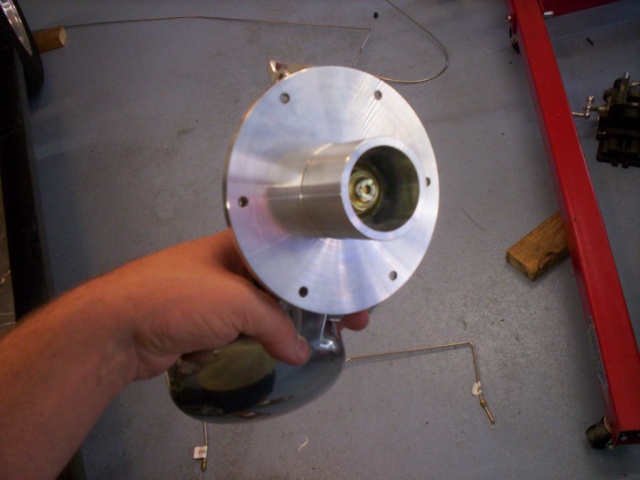

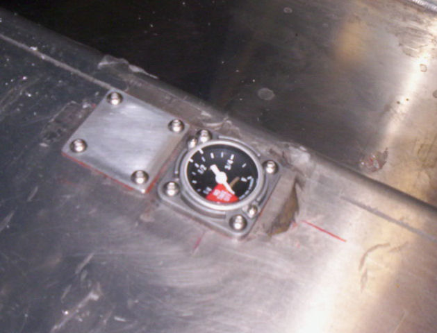

In keeping with the "do more with less" or "simple is better" type idealism I installed a mechanical fuel gauge on the Lola. The fuel guage is really cool, and, the picture won't do it justice. The fuel gauge is simple and of the type Jac Mac pointed out on a thread some weeks ago:
http://www.aircraftspruce.com/catalo...fuel_gauge.php
This thing is better than it seems although those pictures with it top mounted and 45 angle mounted in the link are sort of BS - it takes some re-working to make that happen.
There is NO mechanical connection between the needle and the float. How does it work? There is a magnet that is mechanically driven in the area behind the gauge face that drives the needle. As is travels up and down the tube, driven by the float, it causes the needle to move. Thus, when you install it there is only the hole into the tank for the float but that is it. The package comes with a drill jig and seal that is used for aircraft installation and is easily mounted.
The gauge is made to mount into the side of a tank such that if the tank was in front of you, like in some biplanes and older aircraft or home builts, then it'd read correctly and could be installed as is. I installed the unit on the top of the sill plate, or tank, and it required some bending of the float arm, shortening, and some drilling of the pinned gear drive parts to rotate them around 180 degrees. Easy to do though and you'll get it when you have one in front of you.
I took pictures of all that stuff, but, lost them when I formatted the SD card in the camera. So, all I have is the end result installed in the sill on the drivers' side of the car. Sorry about that.
Net result is a damn simple, pretty much fool proof gauge with no wires or fuss. About the only think I don't like is the "No Take Off" area at 1/4 tank, but, I can live with that can it could probably be repainted if I had a mind to. If some folks are looking for some simplicity in their build I'd highly recommend using one, or two. I'm using one as I'll just use a 1/2" ID balance tube between the tanks and eliminate the two gauge issue and feeds on the 40. My old Esprit had two tanks, and a balance tube, and seemed to work really well that way with one gauge and I think this will be the same.

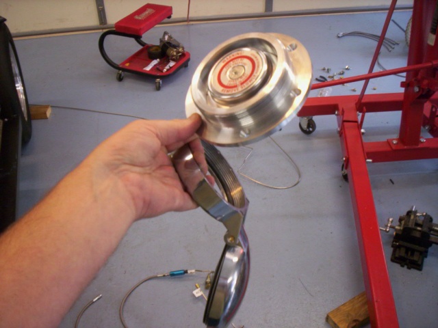

Lightbulb Fuel Sender Picture

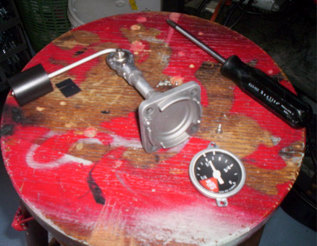

Ah ha! I found the disassembled and modified picture. You can see how the gauge simply unscrews from the sending unit and does not connect to the float directly. The sending unit base seals well and I don't anticipate that we'll have any issues with fuel leakage etc.
The RCR top sills are 3/16" thick aluminum and are plenty thick enough to tap for a fine screw, in fact, a coarse thread screw can be tapped in there comfortably too.

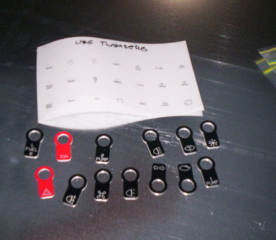

Thanks Pete, I tried but they were wiped. Got about 70% of the gauges in Friday, more coming, along with lots of other bits. We'll be forming up the dash this week I think. And, as such, here are some of the small tags I bought from Cowden Automotive (Jim C) for the switches. They have small pictograms on them for their use. Normally, I'd go with the black label maker stickers but I liked these a lot. His website doesn't work for me though so I don't know how many folks know he makes them, cool though and fit the standard switches I'm using throughout the car.

Ron, how can I get in touch with Cowden, I like those switch ID's

Chuck - www.mentalperformance.com.au, he is an advertiser and has a banner ad you can click on up top. And, jim_cowden@hotmail.com.

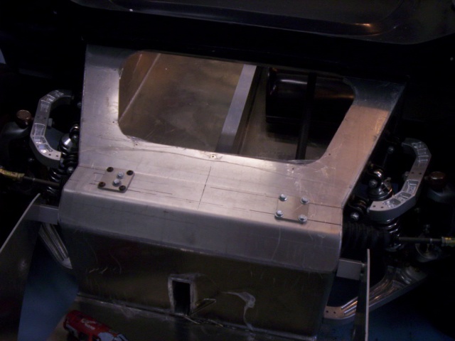

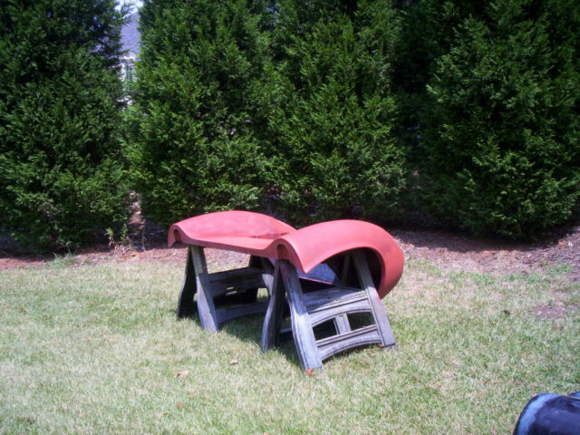

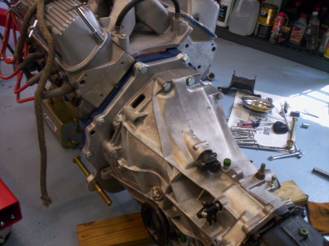

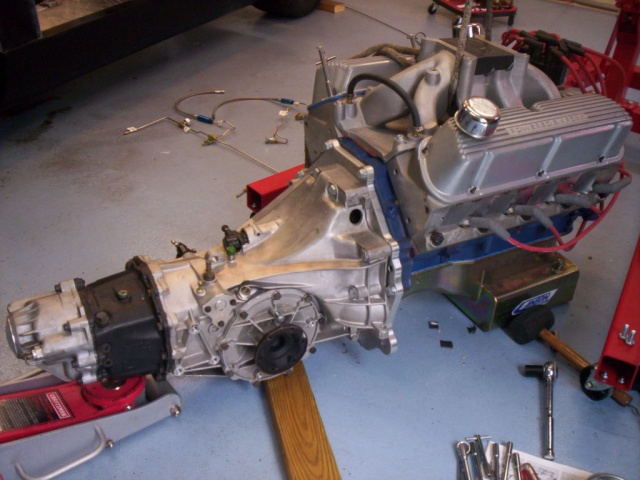

I've got the transmission mated up (decided not to post my "mistake" pictures and the KED stuff worked okay. I had to enlarge the pressure plate engagement holes a bit but other than that, perfect. Fran's plate worked as advertised and is a nice aluminum piece that fit with the KED bits, no issues.
The brake lines that RCR supplied are pre-bent, and are a complete no-brainer to install. I'm doing that right now and if it takes me more than two hours I'll be incredibly suprised. Nice SS lines, all bulkhead fittings, all bits contained and has 2psi pressure valves for the manual brakes. Also has a hydraulic pressure switch that I like a lot better than the pedal mounted electrical switches for operation of brake lights.
We also got the front clip primered properly and are starting some sanding on that too. Once the lines are in, in goes the engine for trial fittment of motor mounts, and once drilled, it is going in for good - we hope!

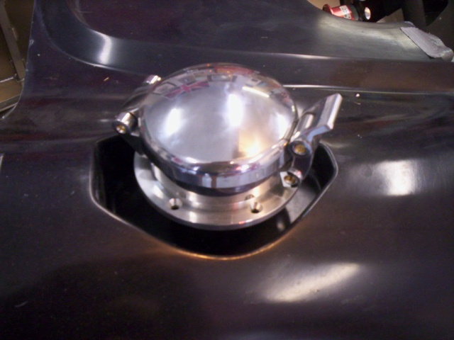

Also got some parts from Fran on Thursday with the KED stuff and the gas caps were there. I like these - built in flange for hose, and, locking key center piece underneth the flip door cap. Coupled with some SS line and good clamps it should be pretty secure feeding down into the tank. Good stuff.

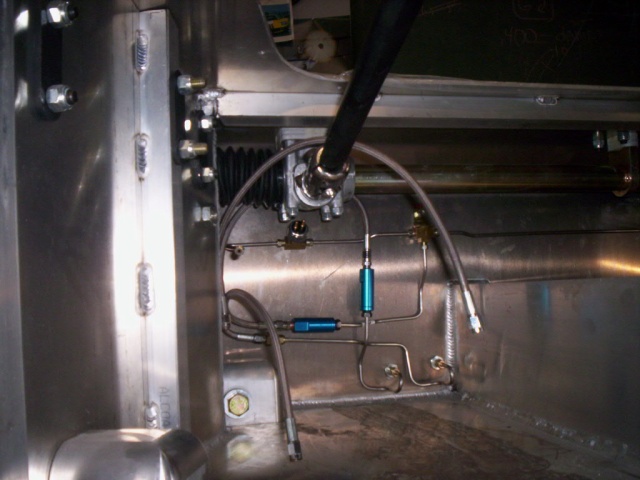

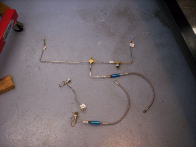

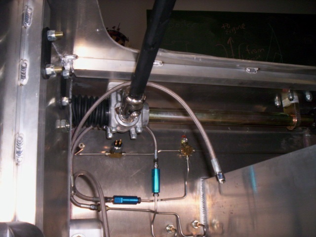

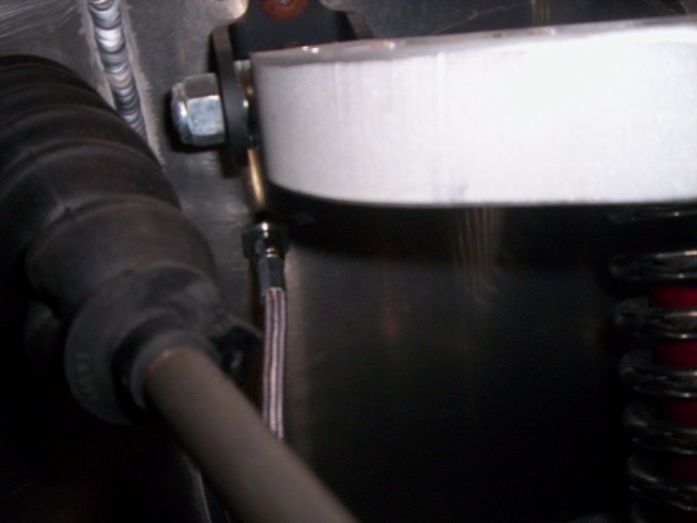

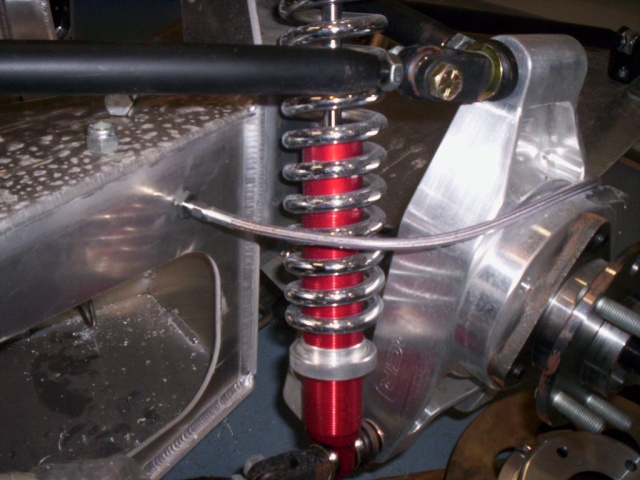

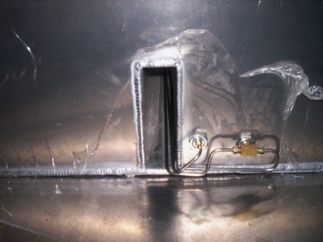

Making more progress. Brake and clutch lines took longer than 2 hours, but was a piece of cake and well put together from RCR. Basically get out a lot of pre-bent lines, drill bulk head holes, and be done with it. The result is nice and seemless with all lines internal to the car except for two that run along the bottom edge of the engine bay. The front brake lines just pop out at two bulkhead fittings so outside the car is it extremely clean. Here are some pictures:
