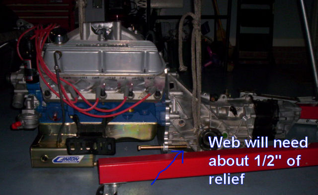

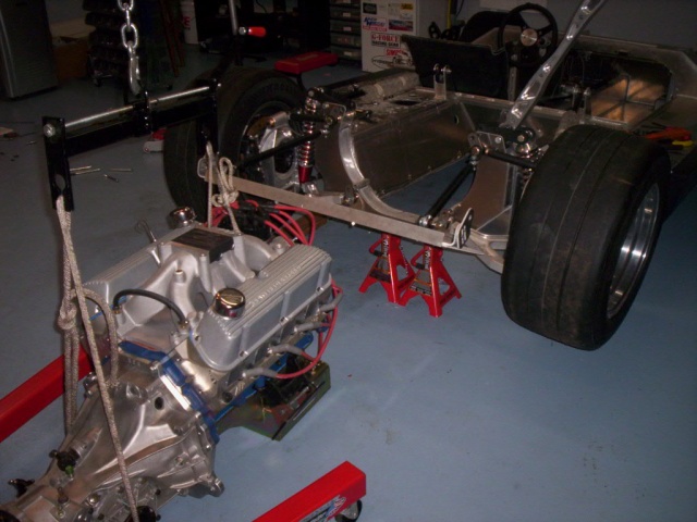

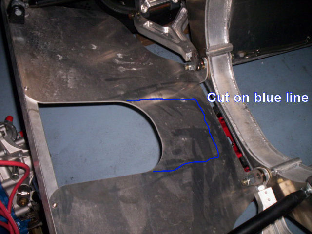

Got a fair amount done today. Motor mounts on, engine trussed up, bearings tight, rear brakes bolted up for real, bolts replaced with grade 8 in engine/tranny, and some other things finished up. Big thing was the first trial fitment of the motor. Notice slaves working in background.
The motor didn't fit exactly as I'd planned though. Initial trials indicate that the rear pan/panel will have to be modified to fit the 016 into the frame. The 016 "hangs low" and will need a fairly large cutout in the rear panel. Another thing that is faily clear is that the 016 itself will have to be pruned down. The webbing underneth the gear box is going to foul on the bottom of the rear horseshoe. I thought we could pull the engine/transmission forward enough to avoid this, but, that is impossible.
The half-shafts from the transmission to the rear uprights pretty much defines where the engine and transmission have to be. If pretty much in line with each other the front webbing of the 016, right in front of the round section for the differential and LSD, will have to be cut out. How much I'm not sure but will mock up and measure accurated tomorrow, as well and take good photos. I would rather not cut out anything from the transaxle, but, I definitely don't want to cut anything from the frame.
One could try and space the engine and transmission up in the chassis, but, that isn't a good idea. Besides, the RCR adapter plate also acts as a motor plate and is bolted to the chassis via two huge bolts. So, they dictate how low the whole assembly has to be, I'll get some more info tomorrow, maybe it won't take much modification. We made only a trial fitment today and didn't have a lot of time to tweak and think about it.
Other than that it appears that it will slide in nicely and has enough room. It'll be close on the firewall area but looks like it'll fit well. So, we're making some progress!

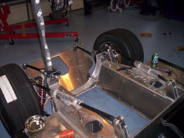

Hey, no worries on the fittment of pieces - that rear tray idea was last minute thing on my side and I appreciate you and RCR taking a guess at it. We are extremely pleased with the car and chassis and don't feel there is anything out there better for our purposes - track car with some street duty as we're building it.
All it needs for modification is about, I think, a 7" deeper cut and then for me to lay a 3/16" piece of ally across to strengthen where I cut. I'll get some pictures up. I'm pretty happy with it and think it'll be in tomorrow.
Once that is in place I think it'll fit with little drama. The engine/transmission sits much lower in relationship to the chassis than say an RF car that I fitted up before. As such, my oil pan *might* be 1/2-3/4" lower than the chassis bottom, but I'm not sure yet. I don't mind though, I'm quite pleased that it won't be high and won't have the engine tilted forward as the RF SB Ford/016 installation did. A new pan can fix it if it needs fixing.
The 016 is pretty small and compact, but where it is not compact is input shaft centerline to bottom of transaxle. This transaxle was clearly designed with an engine that had a crank up high in a block, or an engine that was going to sit high in a chassis. It's okay though, and she'll get in there before long.
Other things are coming along too. We're plotted out pedal positions, reservoir locations, and I've got the wiring harness all over the play room cutting out wires I don't need. Power Antenna. No. AC. No. Heater. No. Oil sender. No. Temp sender. No. Alternator field. No. No. No. No. The beauty of mechanical gauges and a race car setup.
These pictures will probably describe what I'm talking about so folks don't think I'm opening a chop shop here, really not a huge deal. Much thanks to both Jeffs for helping out today!

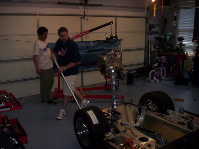

This is a picture of my garage helper who in generally present throughout garage events, unless, of course, Ed The Dog is over.

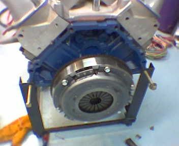

And, here is a shameful picture of how NOT to bolt up your flywheel and pressure plate. What is missing in this picture?

Adapter plate!
