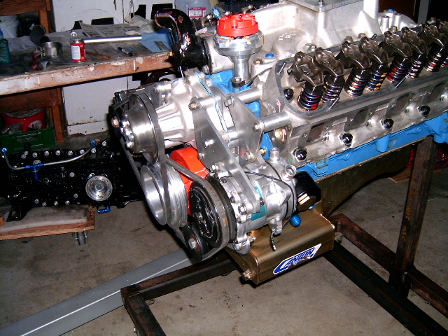

Ron here's a couple of ideas. In the first picture you can see I did just about the same thing with my alternator except I move it inboard and lower one bolt hole on the head face. The belt tension adjustment is a simple L/H R/H piece of tubing with two rod ends. In the second I found a water pump pulley that has the center line of the belt in line with the bearing.
ID:	16336  Click image for larger version

Howard,
Where did you get te turnbuckle(adjuster)?

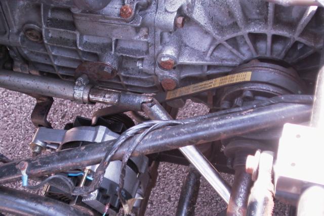

Ron

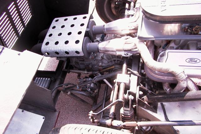

Easier to mount the alternator at the rear and drive off the driveshaft. This was at LM Classic 2006
It means the alternator does not need to spool up to 6000 rpm before back to 4000 at each gear change sould save instant HP on acceleration.
You cold then use a small idler pulley and get away with a lot less at the front end - or even a 2 pulley system like VW beetles used. (Just have a problem as you will not have an idiot light if your water pump belt breaks.)

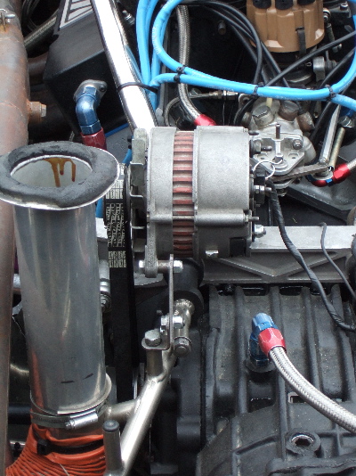

Seems to work well in this 428 powered 40.
Have a decent main battery and all should be ok I guess.
Name:	Rear Alt 1.JPG
ID:	16339  Click image for larger version
Name:	Rear Alt 2.JPG

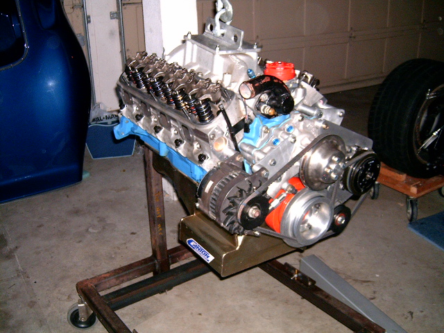

Pantera,

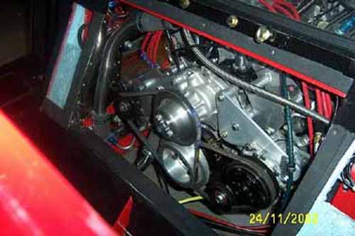

I made it out of a piece of 8 sided rod. Turned down the ends and drilled and taped one end L/H and the other R/H. It could be made out of any piece of thick wall tubing that has a I.D. slightly smaller than the tap size of the rod ends you use. I used 3/8 rod ends because they are the same size as the mounting bolts that go into the head and thru the alternator.
By attaching the A/C pump and alternator separately from all of their mounting points I hoped to not hang any single point of support too far out on the end of a "lever". I hope you get what I mean. Anyway it has all worked out very well so far. Nothing on the front of the motor has come loose.
I also tried to use as short as possible belts. This was an attempt to reduce belt stretching and lessen the tendency of a long belt to ride over the edge of a pulley as it snaps back from a sudden in change in speed. It all seams clear in my head but I seam to have a hard time putting it on paper. I hope I have been clear enough for the reader.
I tried to make all this mounting stuff as strong as I could and still use aluminum as a material. On second thought steel would be only slightly more weight but more than likely more reliable in the long run. I guess I just like working with aluminum. But mainly I did it this way because I had a lot of aluminum around for free and I can't really afford to pay anyone to do this sort of stuff for me so just about everything like this on my car is hand made. It's amazing what you can do for yourself when you have no money in the budget.
Here's what it looks like in the car. Both the A/C pump and the altenator are low down in the engine bay where theres more room behind the firewall access pannel. Both can be adjusted (belts) from underneath the car without removing anything.

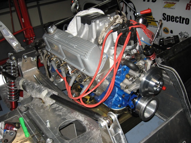

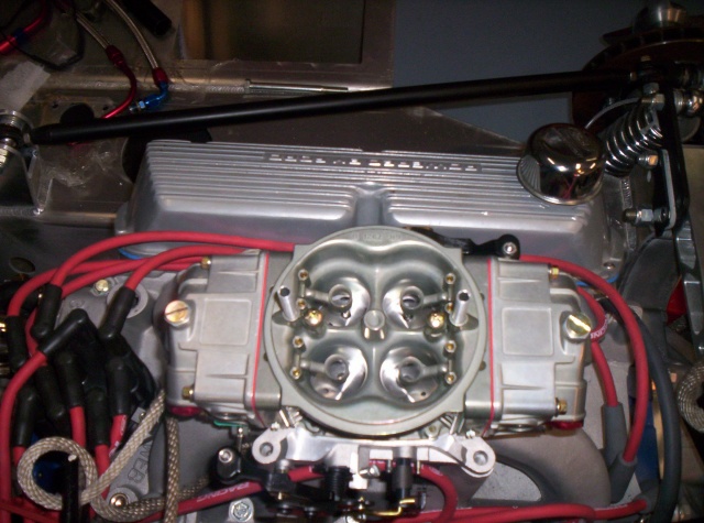

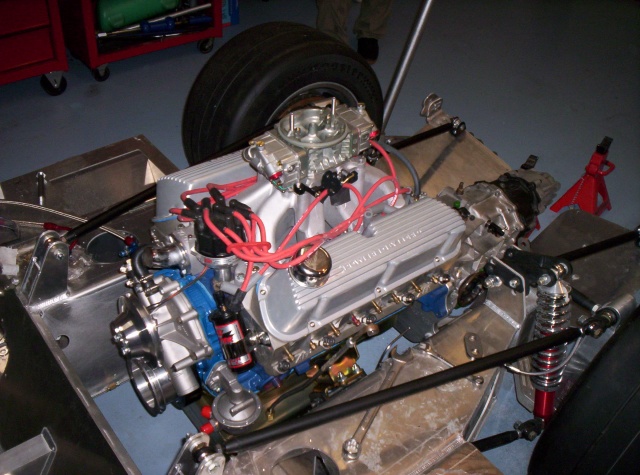

Jeff and I got some time to work on the Lola after cleaning up after the Enduro. We put the motor in and it is going to be permanent except for the spacers there made from washers. I'll replace that with a spacer I'll turn down on the lathe.
The engine fits really nicely, and with this motor plate style adapter it is a nice setup compared to the standard motor mount and tranny mount. Once together it'll have two 3/4" bolts from the chassis into the motor plate/transaxle adapter, two 5/8" bolts from the top cross bar to the motor plate, and the two engine mounts. I bought some good engine mounts that Al had posted some months ago to replace my $11 cheapies from the local parts store.
I understand the carb is on the way shortly, so things are coming together. I've got more progress on the other end of the car too and will post that once it gets all nailed down, right now it is a mess! In the pictures you can see where the 016 needs to be clearanced on the bottom to fit low in the chassis, and see how the pan is flush with the bottom of chassis (Canton Road Race Pan).
And Jac Mac, notice the new pulley there!
ID:	16547  Click image for larger version
ID:	16548  Click image for larger version
ID:	16549  Click image for larger version
ID:	16550  Click image for larger version
Name:	front clearance.JPG

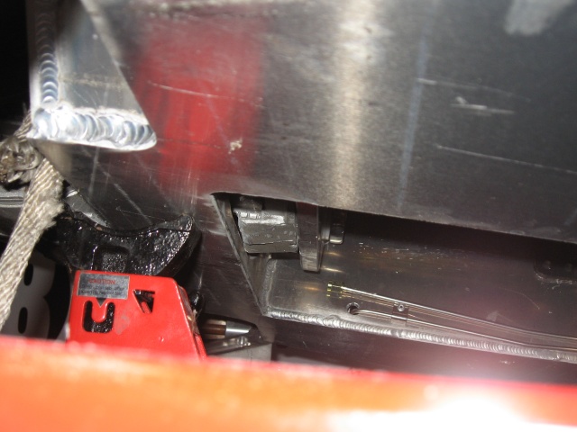

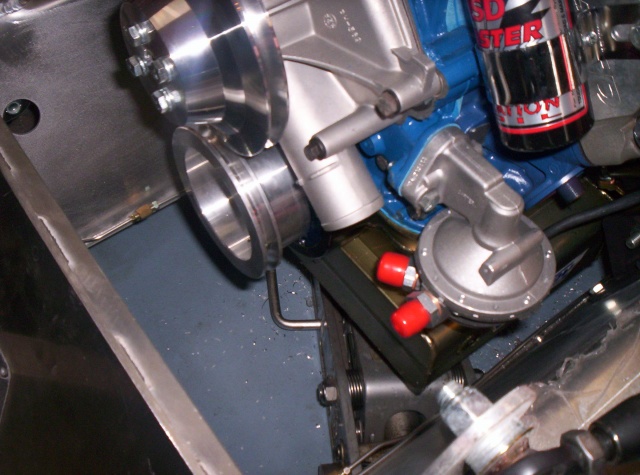

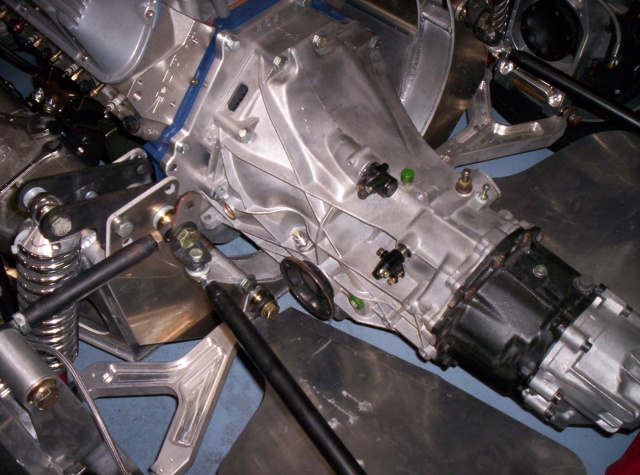

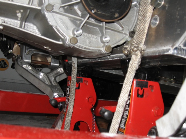

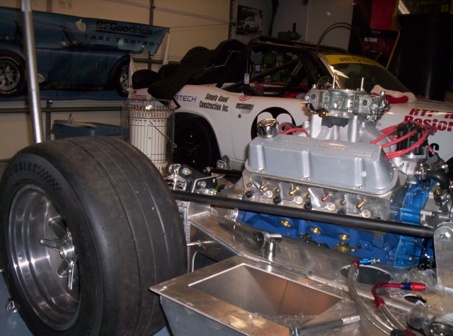

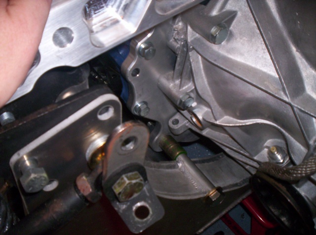

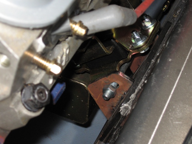

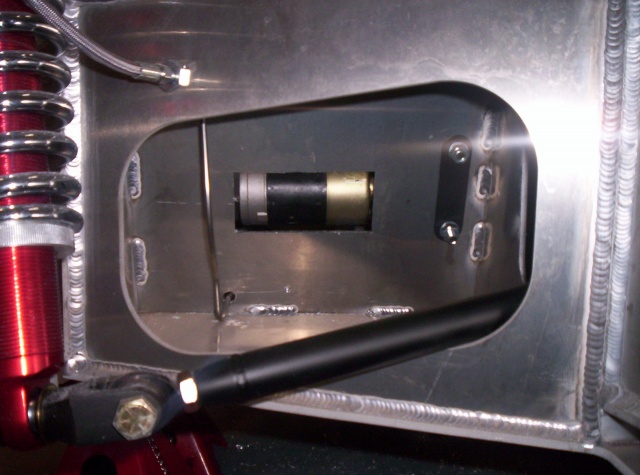

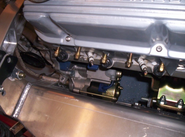

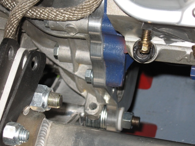

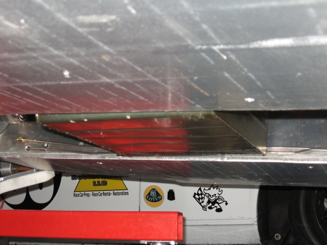

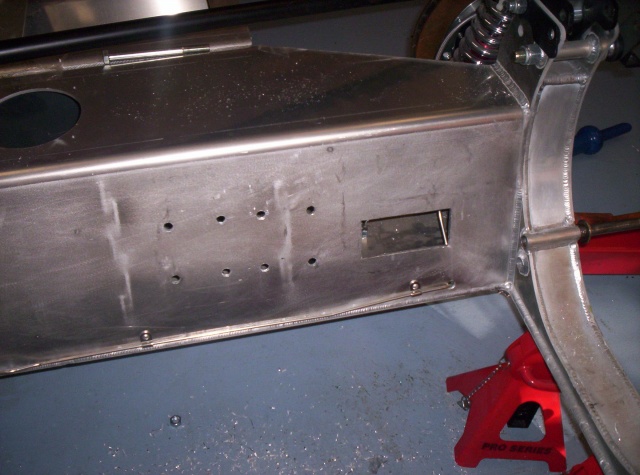

Jeff and I made some more progress today and tonight and I'm pretty happy about it. I can say this - for those fitting your motor be ready to pull it in and out a bunch of times. I measured, and re-measured, drilled some holes, checked fit, pulled it out, put it in, etc until I was happy.
Then, I bolted the starter up and found out I had to clearance the wall for it and repeated the procedure all over! Not bad at all really though.
In short you'll need to clearance the transmission for the lower chassis member and get the engine as far forward as you can. You are limited by the round casing portion of the 016 though and, clearly, where the output shafts are in relation to the upright. Nonetheless, you would not want it any further forward or you'd be too close to the belt drive with your head.
I made some spacers to keep the motor plate and engine forward and this allowed me to located the engine mounts. They are each bolted in with eight bolts across a internal torque box strengthening member and are very well located and quite strong. I've got pictures of the mounts, the spacers, and the clearance you'll need to do for the starter. Really, if you wanted to you could use a ball peen hammer ( a big one) and maybe beat enough clearance for the starter but I'm not sure I'd do that.
In the end you'll have a motor and transaxle that fits snugly in the chassis and is quite low - my oil pan is just flush with the bottom of the chassis and the 016 is as low as I've ever seen in a 40 replica.
Fran made me a rear belly pan that we knew wouldn't fit but I cut it for clearance into two pieces and will fab mounts for those pieces to use the 3 bolt holes on each side of the transaxle for support. It'll be strong this way and work well.
I measured and cut it to have about 1/4" of clearance because there is no way it'd fit without getting cut in half. But, what I can do now is use the three holes on each side of the transaxle and make a mount that will bolt to the two pieces and help make them stable. I'll have to join them somehow with a curved piece too around the end/bottom of the transaxle, but it'll be cool. As said, it was an experiment and will work out fine.

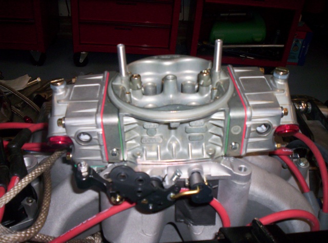

In the last shots you can see the carb from Stallion Racing that Stan put together, nice piece!!! It'll be highly visible sticking out of the rear deck on the Lola, most excellent. It isn't bolted down or anything, but it is too cool not to pop on top and make vroom vroom noises. The motor, carb, transaxle looks good in that chassis!
Tell you one thing, when the top crossmember is bolted to the engine/transaxle the entire thing will be incredibly secure in the chassis. In fact, it already is far more secure than anything I've seen short of a motor plate welded into a drag car. You'll be able to feel when the engine is running, no doubt about that, and power transmission will be efficient for sure. It is a well thought out system I think and very tidy as well as strong.
